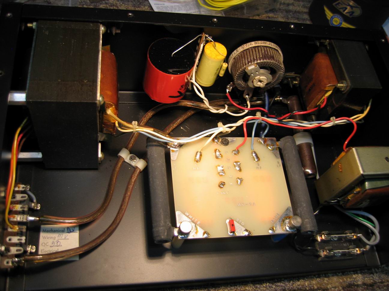

I have a set of acoustat model 3 speakers and it seems like I have no bass coming from the left speaker. I was under the impression that since the speakers were full range if its working at all it should be all frequency but I know almost nothing about how the transformer is set up. I have mk-121 blue medallion interfaces. Anyone have this issue before or have an idea of what It may be? I have already taken a look at the panels and they seem to be intact and I see little to no evidence they need to be heat treated ( no wrinkles or looseness). I never really noticed since I had not tried them full range until recently. I have been running them with 2 svs subs but the sound they get full range while not as punchy sounds much more real and has a better image then using the subs. I will more than likely be replacing thees speakers with an LX521 system in the coming months so I don't want to spend a ton of money fixing what I feel will soon be my second choice but I do need a project to tide me over until that build 🙂 . I have been reading up on electostats lately but I am by no means an expert so I apologize in advance for any crazy questions

As a first step, check the low frequency tap inside the interface. This is a terminal strip with multiple positions, with a wire that should be pushed onto one of the terminals with a female spade clip. This wire may be disconnected, making poor contact, or set to the wrong position. For the Model 3, it should be set to the terminal with the orange wire for 'normal' base response.
The two audio transformers inside the interface do overlap in operation, and a loss of bass may indicate a problem with the LF transformer and/or its associated components. If the above hint does not solve your issue, next check the condition/value of the 1-ohm resistor in series with the LF transformer primary, and then the two larger 50K-ohm resistors located on the PC board. If all of these components check okay, then your LF transformer may be bad.

Thank you I'll have some time to take them apart in the next few days and I will check that out do you know if it is possible/cost effective to replace the transformer?
Grab an ohm meter and check for continuity / resistance on the primaries of the LF transformer. Then check the continuity / resistance on the secondaries of the LF transformer. They should not be open, and be relatively low resistance. Post your results here.

I was not getting any reading on my meter at all but I am very new to this so I could have been connected to the wrong leads. I also found out I don't have the medallion transformers even though the sticker says I do they must have been swapped out at some point. The transformers in my interface are wrapped in brown paper. I sent an email out to Roy A. Esposito as he is able to provide the medallion upgrade but he said he is pretty backed up with work at this time so I would like to try and get everything at least working while I wait on getting the upgrade.
What's the part number stamped on the transformer? There were a few Medallions that did not have the black-paper wrapping.
Unfortunately, the LF transformer can fail, especially if overdriven. It is the Achilles heel of the MK-121 interface. The HF transformer and bias transformer are much more reliable.
The Medallion version of the LF transformer does have better arc-resistance than the non-Medallion version, but is still susceptible to over-driving. It can develop over 10,000 volts between phases on the secondary.

WOW....10kv... I new it was high ...I bet at high humidity...or low bias...mabe much higher...like driving a dead short....after time..that well kill any Acoustat LF tran..

I have seen the large power resistors in series with the output of the bass transformer fail and go open, so maybe check those as well.

So I ended up taking it into a local shop and they tested the interface and said everything was working. I know this is not the case because if I swap my working interface onto the same panel everything is fine. Is there something the technician would have likely missed? Or was I just scammed. On another notes I now have a new interface but its an older model the mk121-2 that is working so I am no longer worried about breaking the interface in the original post all ideas are welcome as I would like to have a matching pair if I can.
Knowledge of how to properly test an Acoustat interface is a rare commodity, so your technician may just be ignorant, not dishonest.
The fact that you swapped interfaces and the problem went away certainly points to a problem in the interface. The transformers should be the same in the -2 version of the interface. If you have already eliminated possibilities as previously discussed (LF transformer tap, measuring resistors, etc.) then you probably have a bad LF transformer. You can temporarily connect the -2 interface to your speaker to make sure it's in good working order. Then, take the LF transformer out of the -2 and replace the one in your 'bad' interface. Report back if you are still having troubles.
I tested out the -2 interface and it works 100% I think I am just going make a modified mounting system to hold the panel in place since the things are so hard to come by I dont want to chance messing it up by taking it apart. That being said I think I will take apart the other interface and do a component by component test of it to 100% rule anything out. And hopefully a nice set of medallions will show up on ebay. Thanks for all the suggestions and help once I get around to taking it apart and testing everything I may post some pics and what have you so if anyone else has this issue they can take a look.
.look at the orange wire. in the pic....that gos to the bass tran....two wire coming in one gose to the 1ohm res....an the other just pluges in to the bar strip....if you have the interface setup to run the panels...like norm....just pull the one wire off the bar strip.......an move it to the red wire plug in...that well tell if the tran is working....good luck
