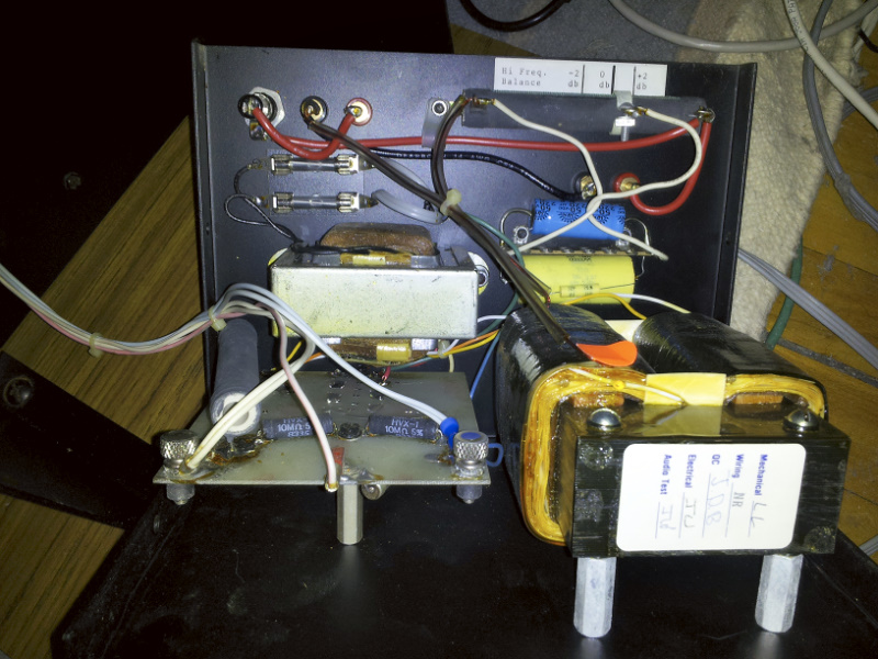

I recently purchased a pair of Model Ones, seem to work beautifully but am wondering if upgrades are in order.

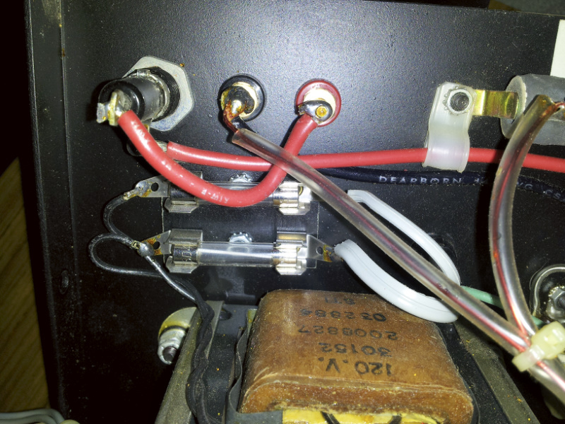

Below are some pics of one interface. Looks original to me. Is it?

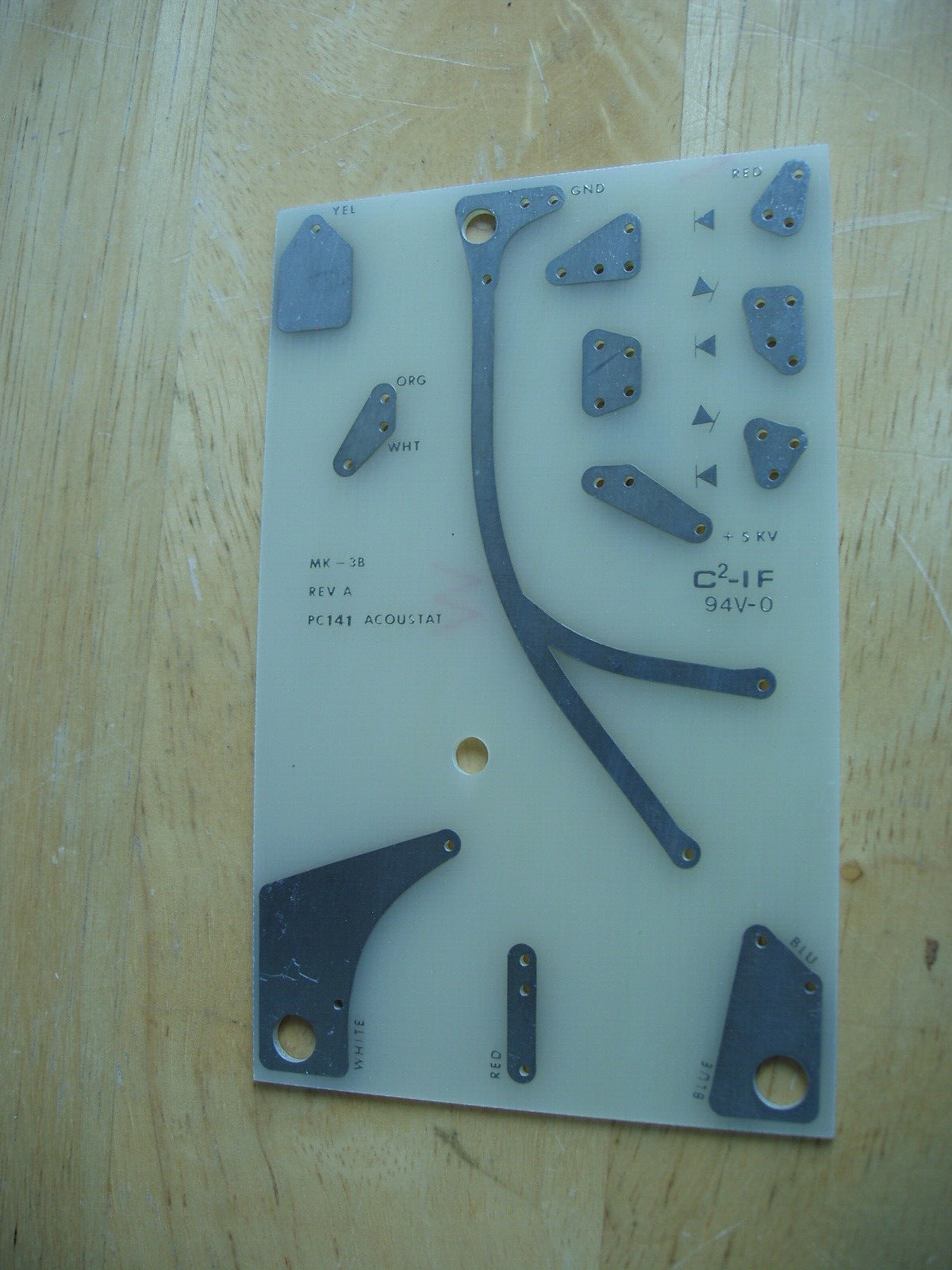

Also below is a pic of the pc board, albeit a newer version I believe. Is this readily swappable into my setup?

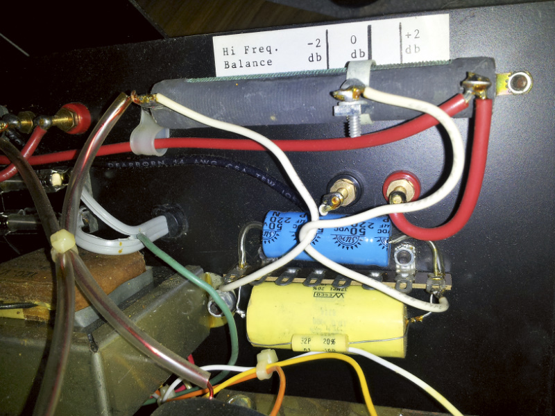

There's no value in replacing the printed circuit board - the newer version pictured is simply revised artwork, not an improvement. You already have the Medallion Transformer - a big step up over previous versions. You could do the C-Mod, which will offer some improvement. You might try cleaning the green oxidation off the variable resistor to improve electrical contact. Otherwise, if it ain't broke, don't fix it.

1. Are you sure these are Medallions? There is no sticker on the outside.

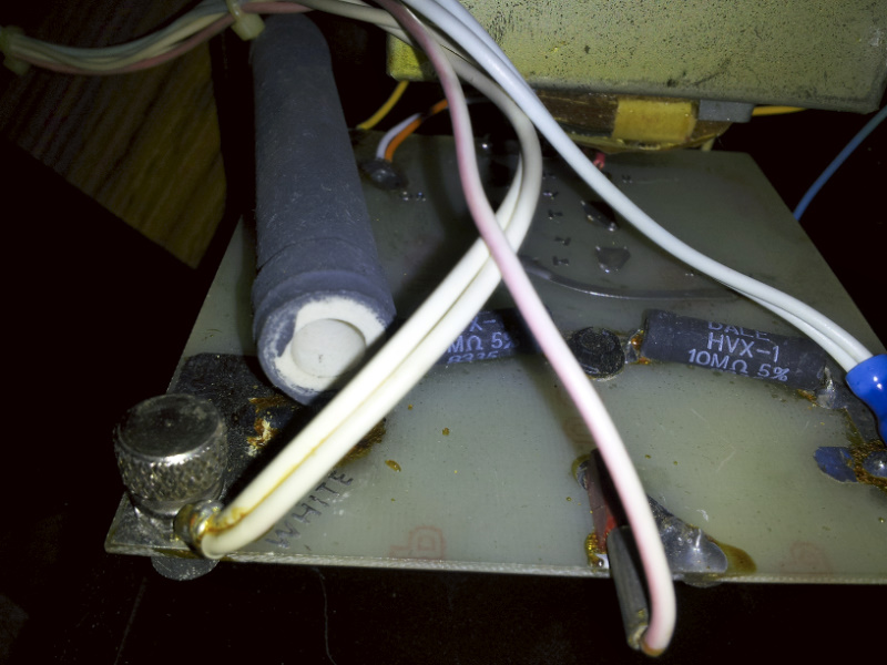

2. I assumed replacing the pcb parts with current ones may be worthwhile. I see either corrosion or flux residue on the pcb. I should leave it alone?

The black wrapper on the audio transformer tells me it's a Medallion transformer. Plus I recognize the initials on the inspection label as being from the period when Acoustat was building with Medallion transformers.
You can clean any flux residue or corrosion from the board, if you like, or leave it alone.

Finally, what can you recommend for cleaning the flux/corrosion on the pcb and the green oxidation on the resistor?

The green (copper) oxide can be removed from the resistor and it's sliding contact with fine emery cloth or similar abrasive.
For flux residue, there are commercial preparations for that purpose. Chemtronics is one brand, and there are probably others. Some scrubbing will likely be required, so use an old toothbrush or similar.
