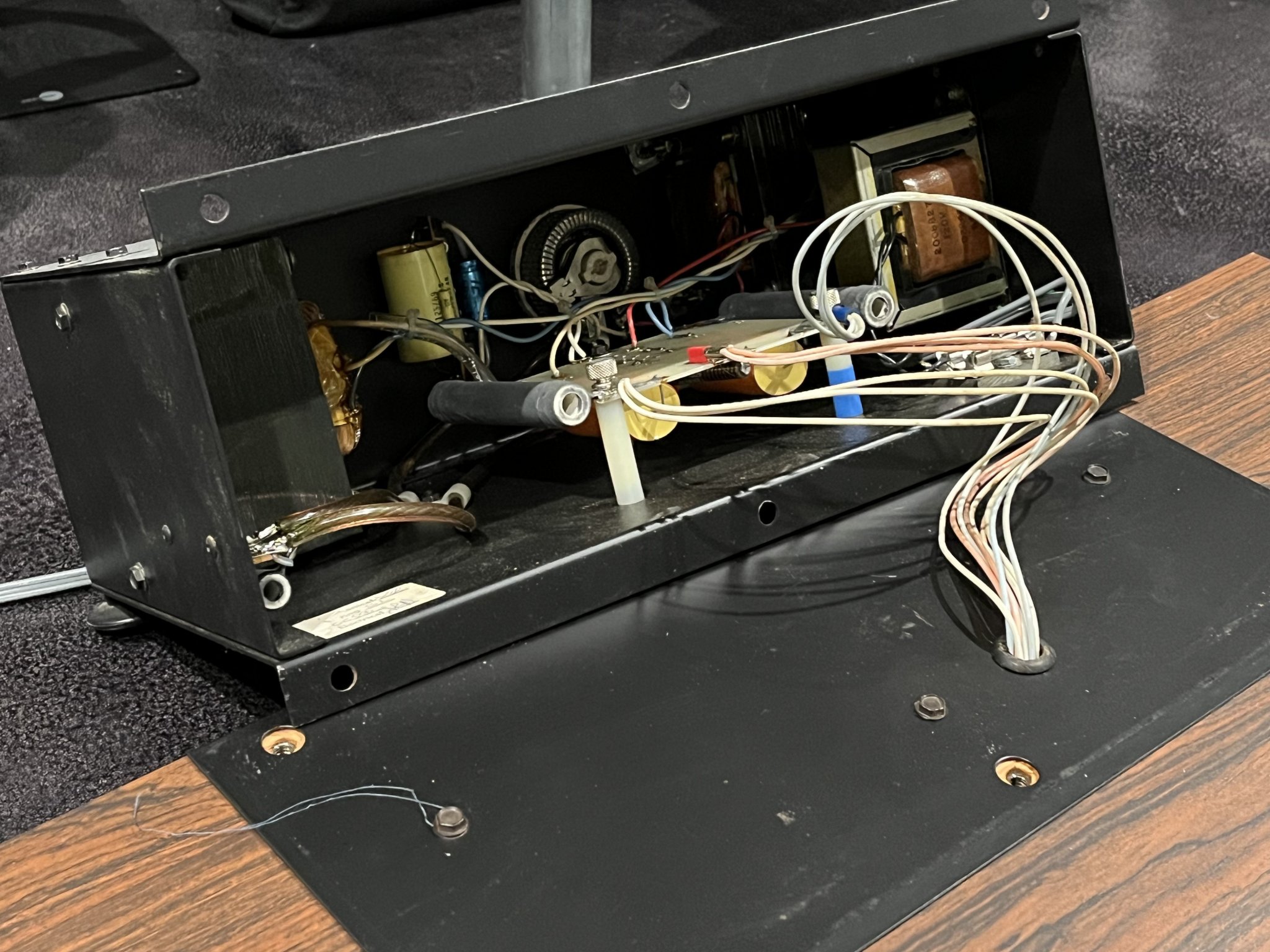

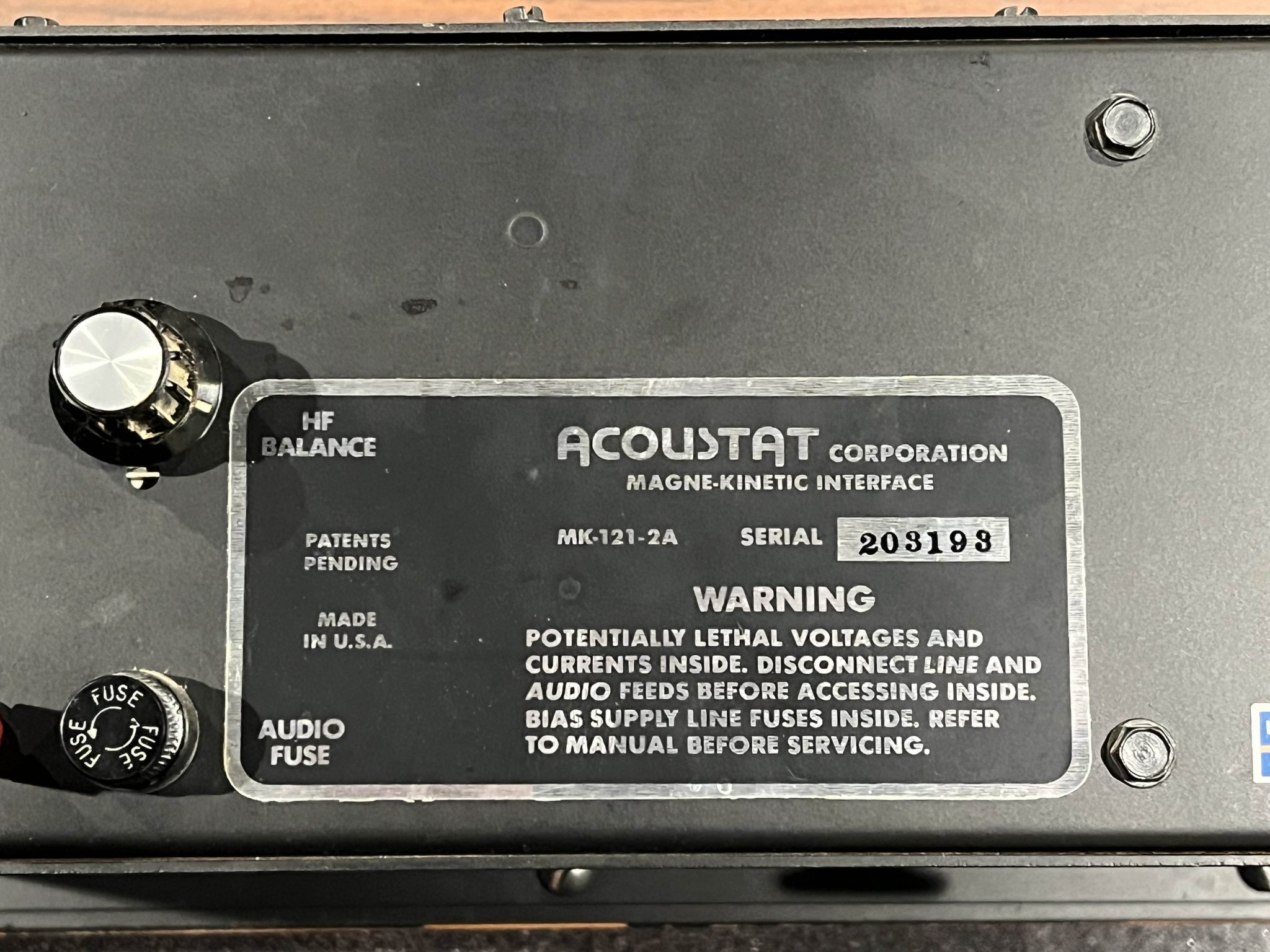

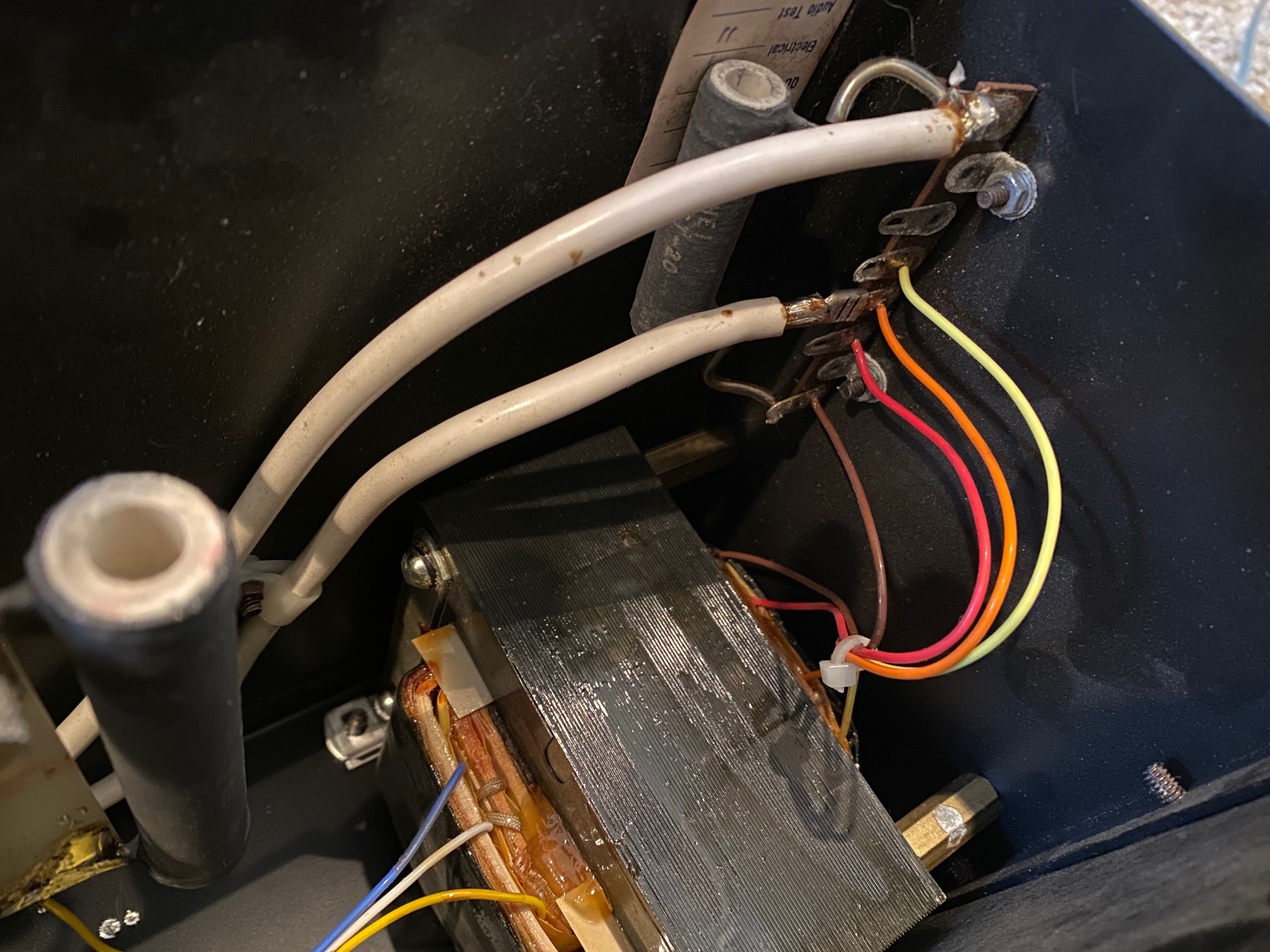

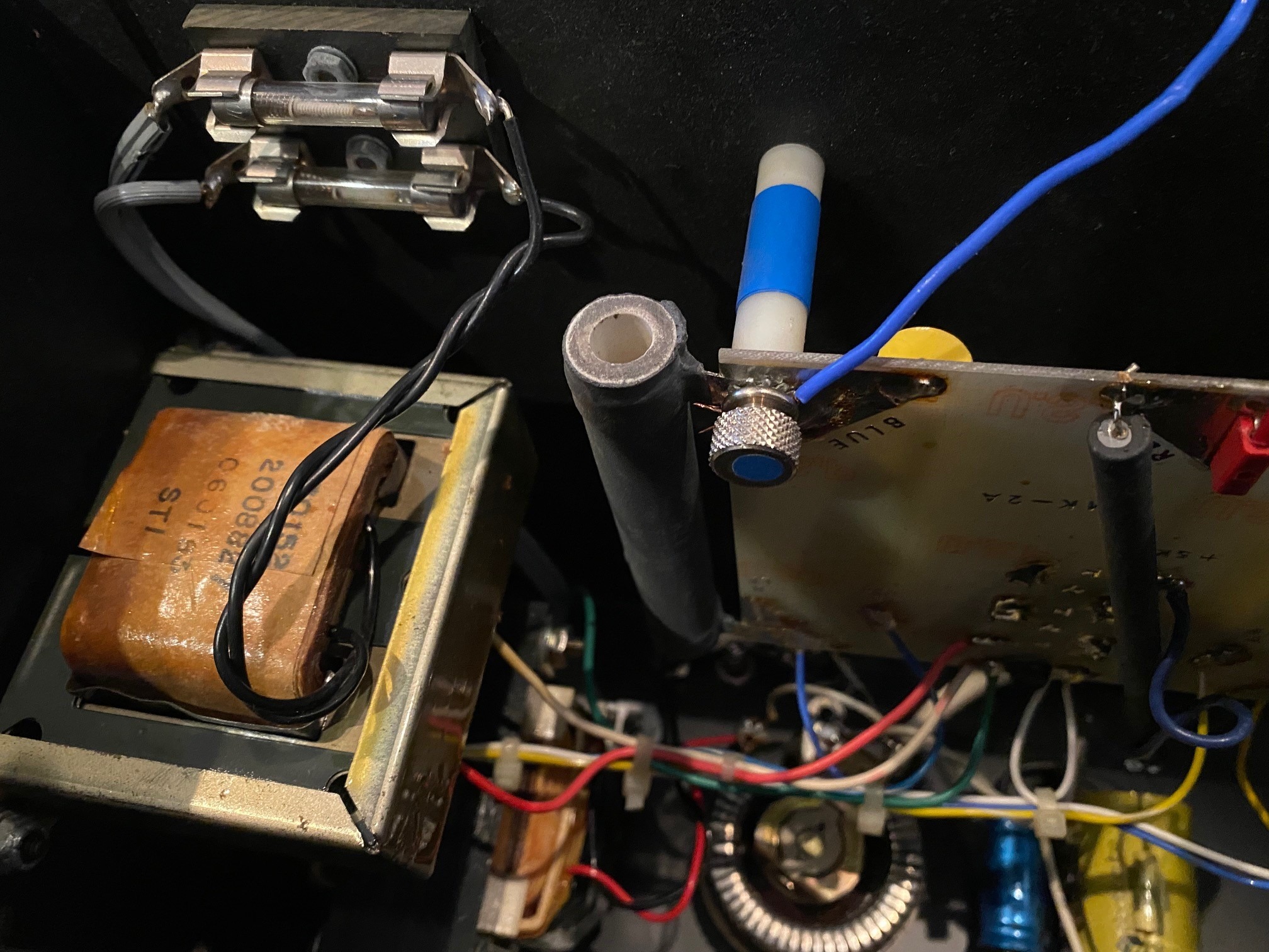

Based on these pics of my MK-121-2A, can anyone tell me if this is unmodified? Also, looking at the 3rd pic with the strip with options to connect to red, orange, and yellow wires, what are these options for? It is currently wired to the middle/orange tap.

Your interfaces have the Medallion transformers, which was a very expensive factory-modification. I cannot tell from the photos if the C-Mod has been applied, but that is an easy and inexpensive change. If you have the BLUE Medallion label, you have only Medallion transformers. If you have the RED Medallion label, you have both Medallion transformers AND the C-Mod. If there is no Medallion label, then...you guessed it...you can't tell by the labelling. Of course, it's always possible that the C-Mod was applied aftermarket, rather than using the factory kit. In that case, only inspection of the HF control circuit will reveal if the C-Mod is there. Plenty of information on the C-Mod in the "AcoustatAnswerMan is Here" thread.
Beyond that, I see no "aftermarket" modifications.

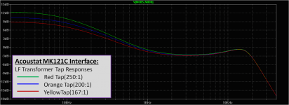

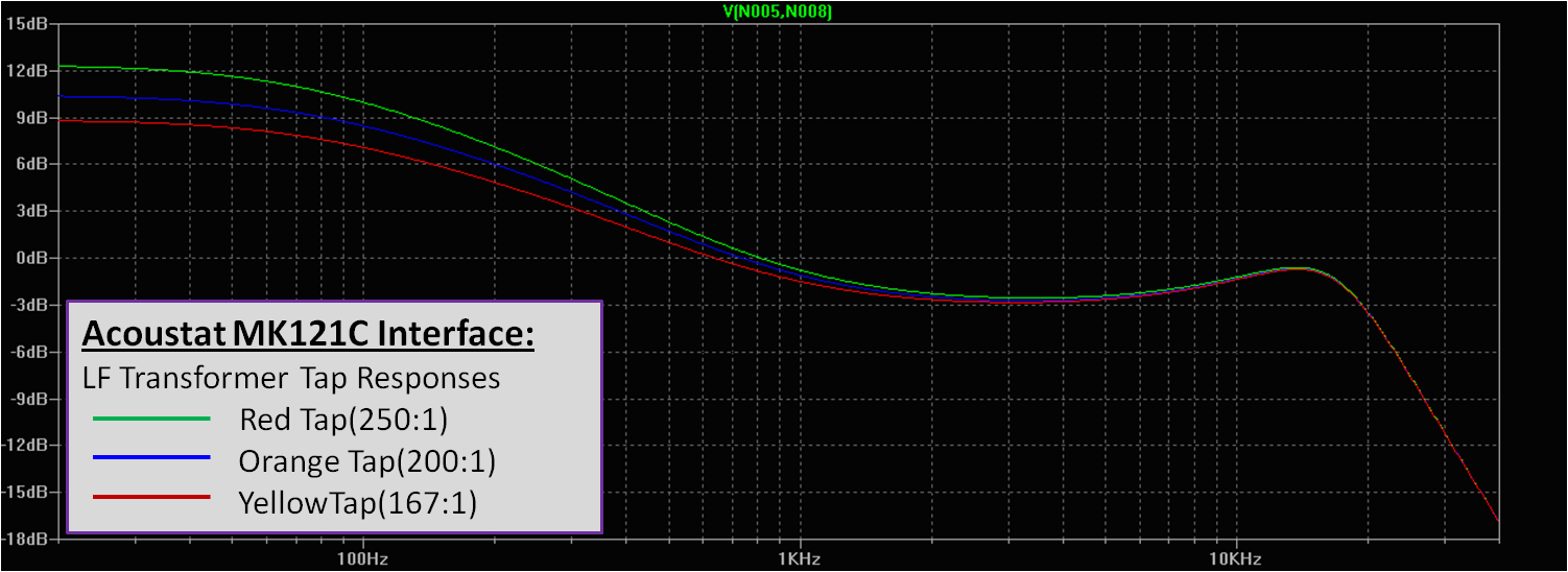

... looking at the 3rd pic with the strip with options to connect to red, orange, and yellow wires, what are these options for?
This connection allows you to choose the amount of bass equalization by selecting different step-up ratios for the bass transformer.
Red = 250:1 (boosts bass about 12dB)
Orange = 200:1 (boosts bass about 10.5dB)
Yellow = 167:1 (boosts bass about 9dB)
For comparison, my recollection is that the CLS interfaces boosted the bass about 7dB.

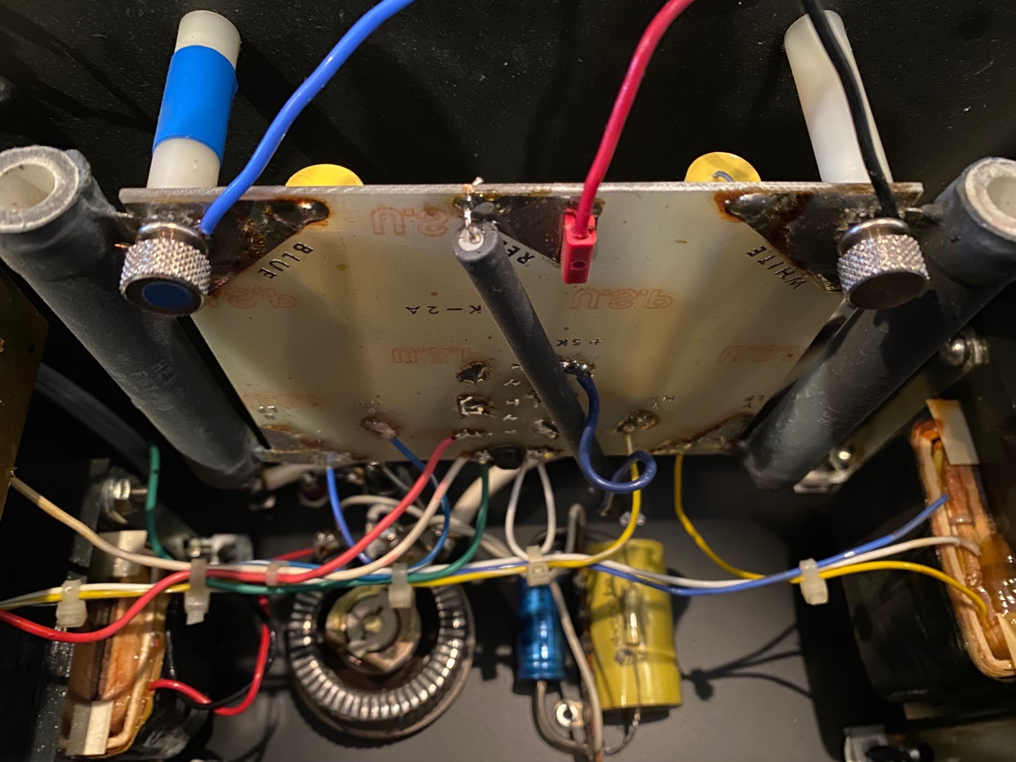

Concerning the C-mod, if you can read the values of capacitors in the middle of your second picture (1 blue, 1 yellow) it should give clear indication if the C-mod has been done.
C-mod will have total capacitance of about 57uF. Non-modded will have total capacitance of about 230uF.

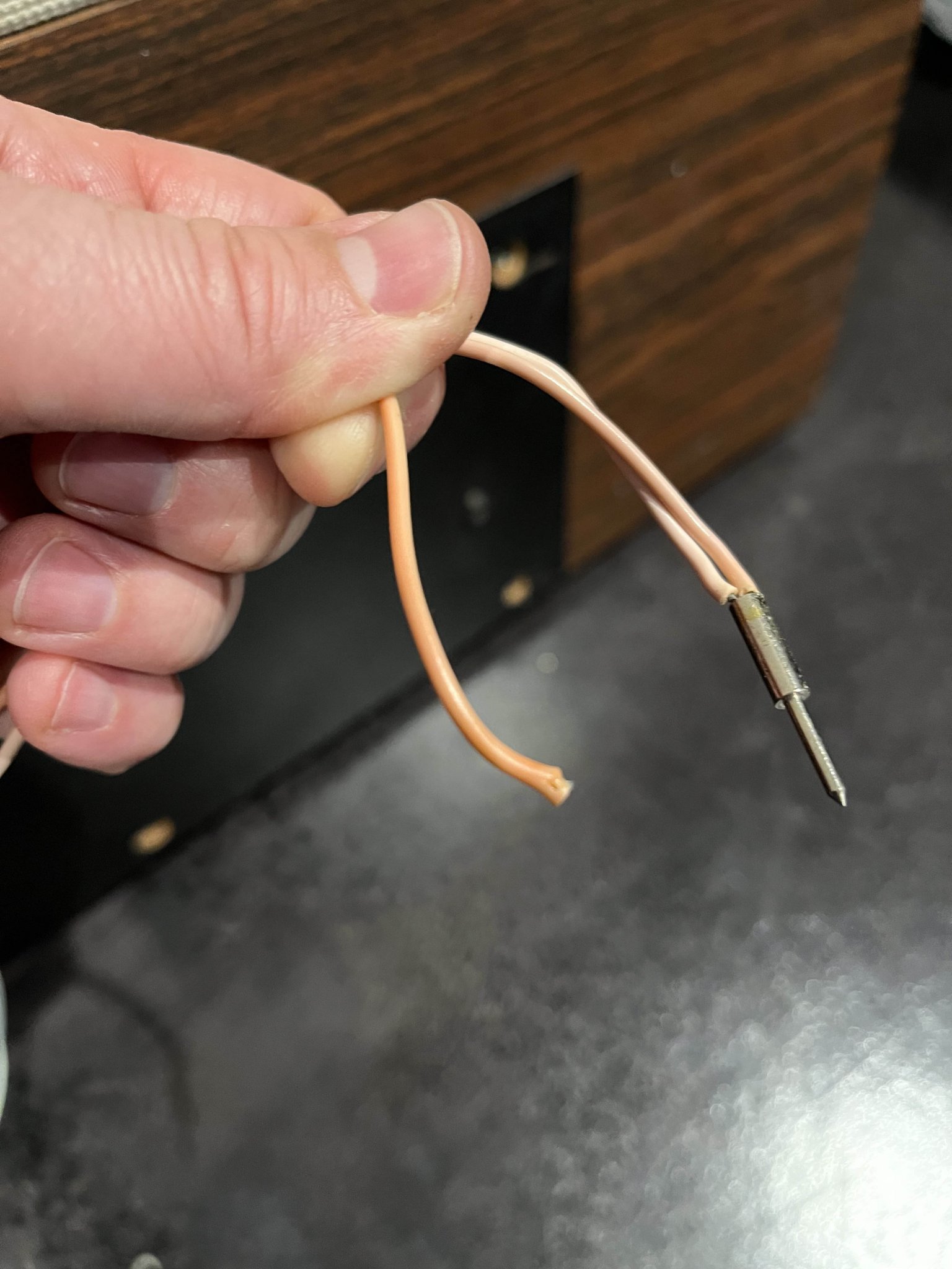

Hi guys,
While taking my Model 3s out of storage I noticed one of the red wires snapped off the pin connector. I'm anxious to get these up and running again but I'm unsure how to go about this repair. Can I simply strip and re-solder the wire to the connector? Remove all the wires form the connector and then reattach them all together? Order a new pin connector?
Any advice is greatly appreciated.
You can reuse the pin. Reattach them all together. Heat up the connector and pull out the two remaining taking care to pull out the remainder of the broken one while still molten. They were probably twisted so it will likely slip out with the rest. This is an easy fix.
