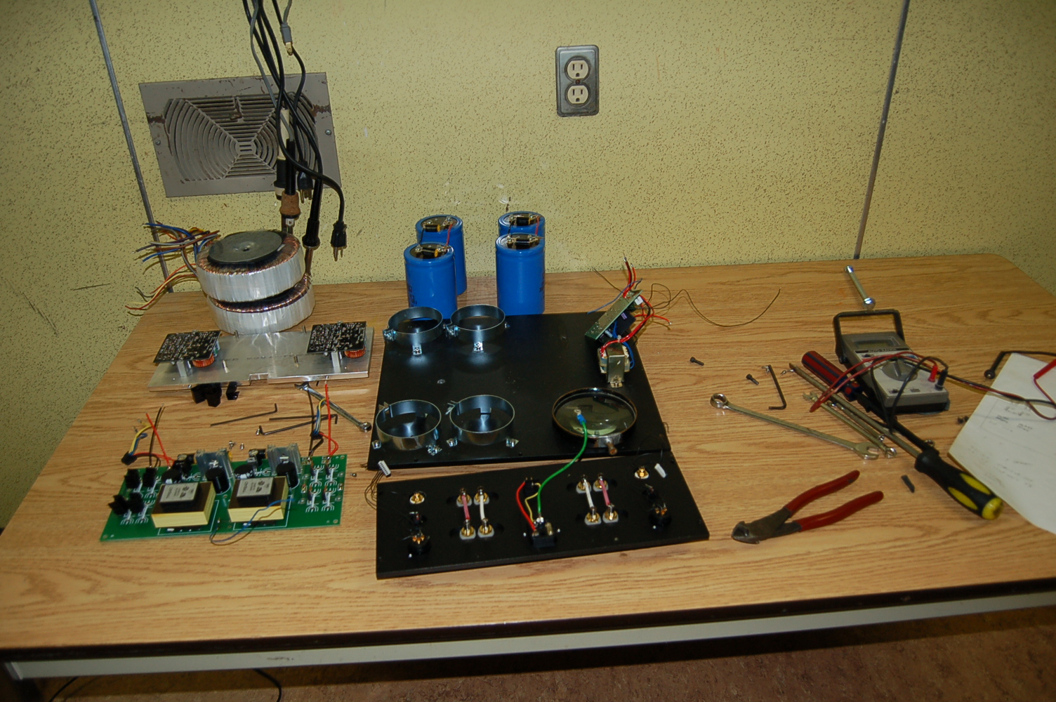

Ok now that I have replaced the HF caps, I would like to lower my high freq 3db, my RTA says I have to much and its turned down. any ideas? Thanks Al
Hmmm, that's a new one on me. If anything, most folks say their Acoustats don't have enough top-end energy. Interpretation of RTA measurements must be done carefully. Did you have the microphone at the listening position? Most importantly, what do your EARS say?
If you already have the HF Balance control turned down to minimum, then I don't have any suggestions for reducing the HF content.
Wow if Andy doesn't have an answer it's going to be hard to find one, i for one don't like excessif HF so i understand you very well this is one of the reasons i didn't want silver wire NOWHERE in my panels my wires are ALL copper but i do know that others prefer silver to each his own.🙂🙂🙂
