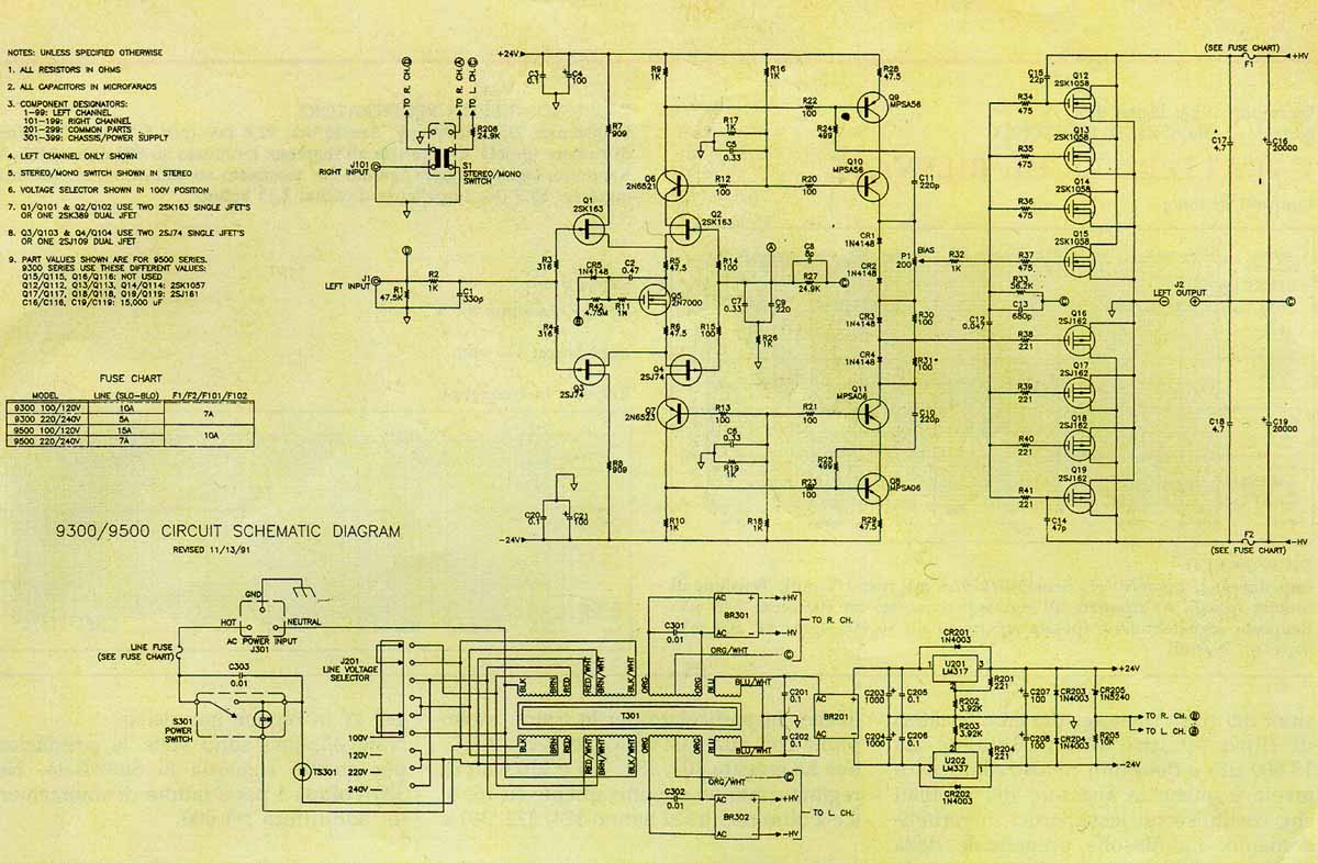

PS. can you post a copy of the 9500 schematic up here?
Here is the schematic for the 9300/9500. Quite the heat generators even at idle as I recall.
What a nicely drawn schematic, if I don't say so myself (I drew it!). Yes, the amp does run toasty even at idle, and even hotter when driven hard. However, the heatsink capacity is very good, and despite driving my 9500 very hard at times into Acoustats, it has never gone into thermal shutdown. And that's with a Hafler 9180 stacked on top of it, that I use for in-wall speakers in other rooms.
The design certainly represents the pinnacle of acheivement in amplifiers from both Halfer and Acoustat, as it uses lessons learned from previous products at both companies. For those of you who don't know, I started my audio career at Hafler in 1982, when the only products were the DH200 amplifier and DH-101 preamp. I moved over to Acoustat when Hafler bought the former. So you could say I know a good bit about Hafler products, too.
