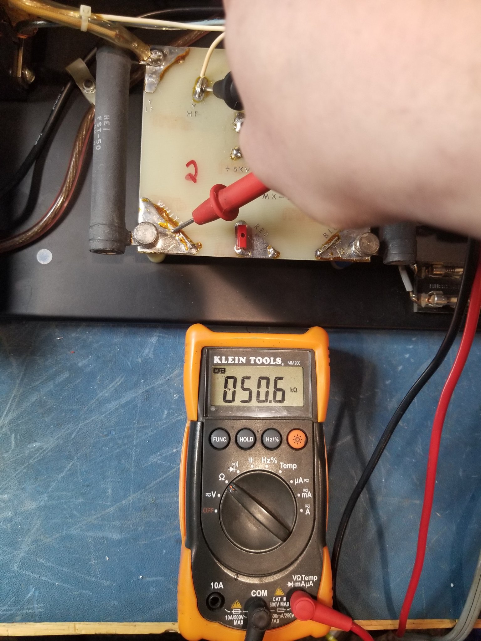

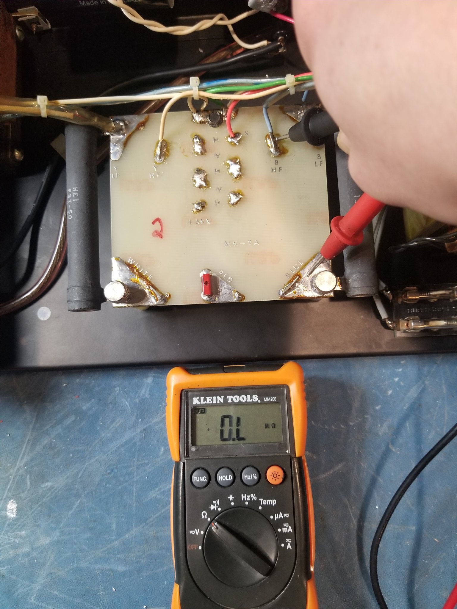

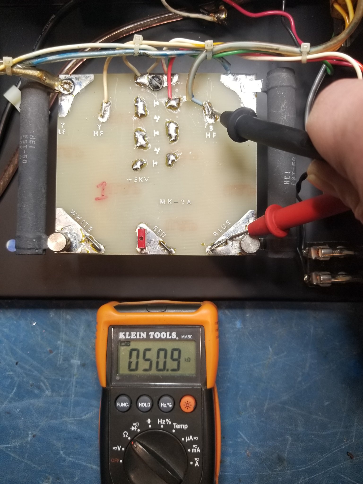

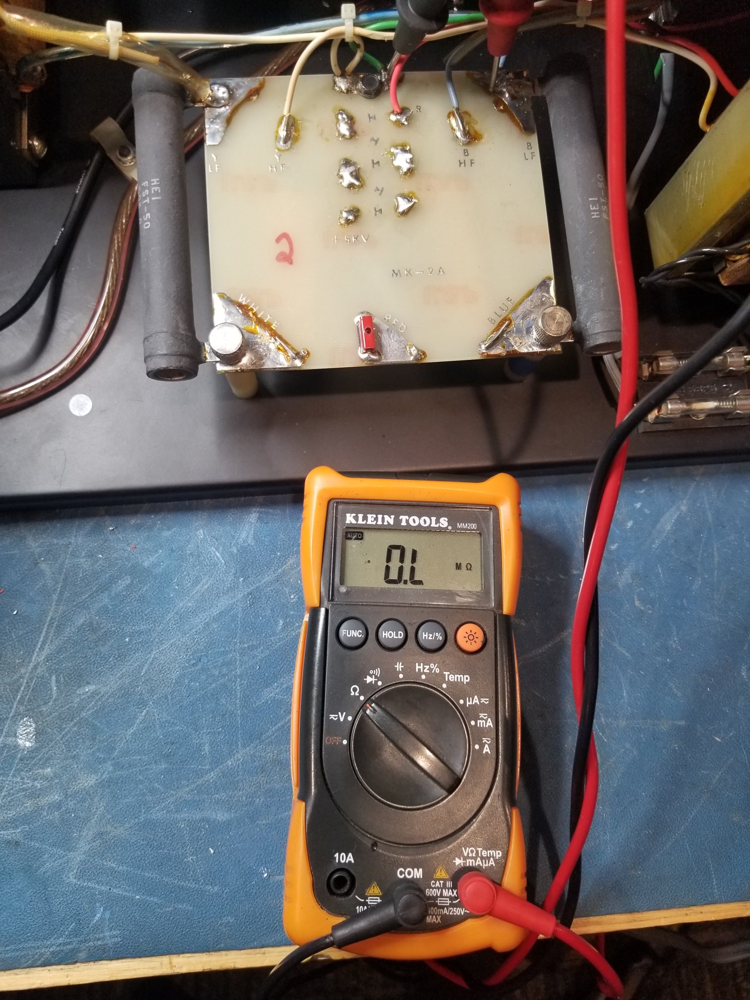

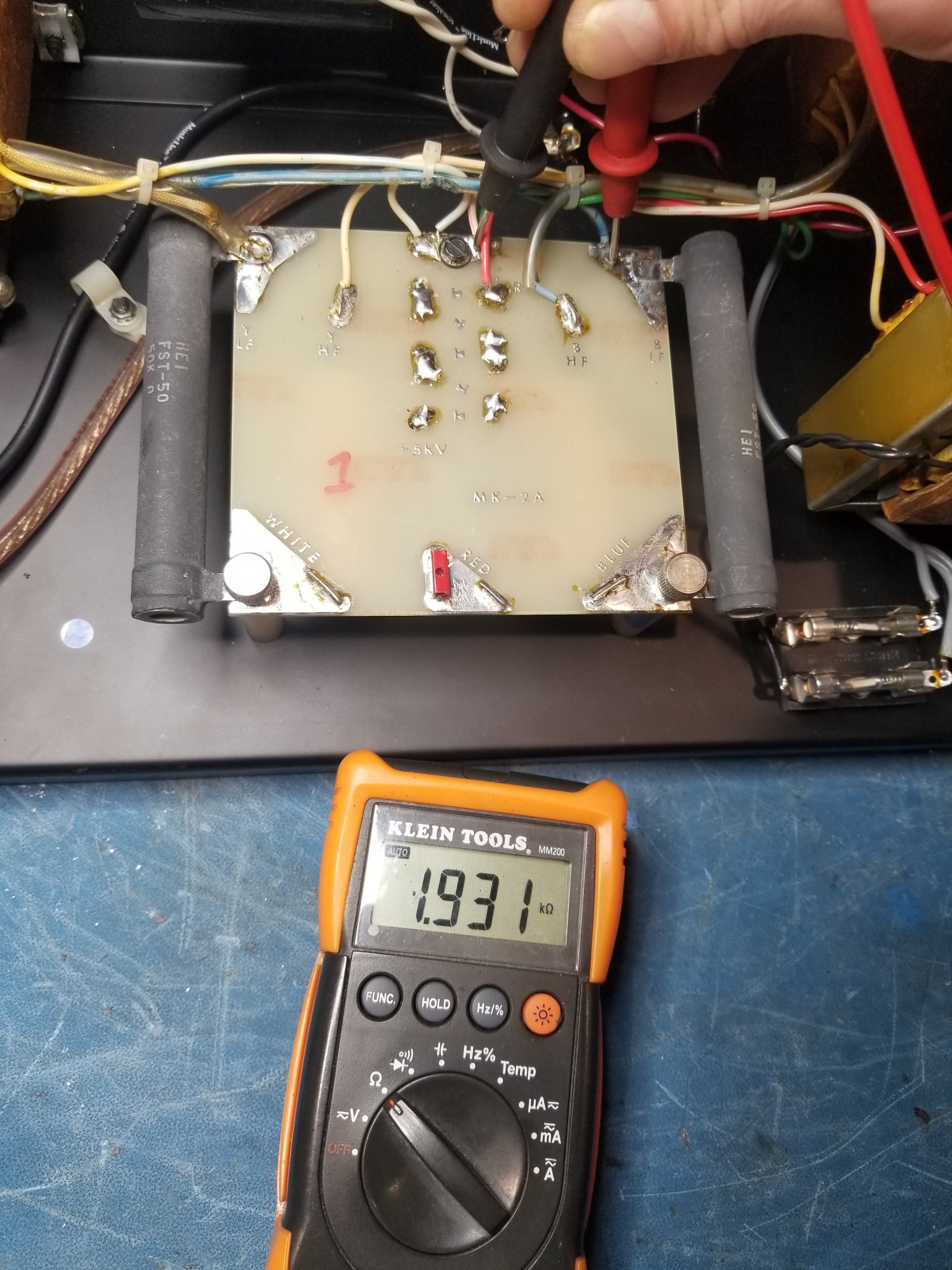

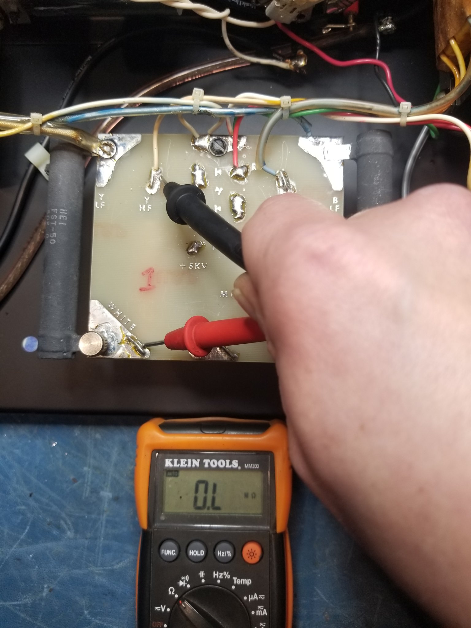

I do have a scope and signal generator. I am a seasoned tech but not with these at all. I homed out the big 50k resistors and they all read about spot on. I did search the troubleshooting and didnt come up with anything. I did find a bunch of posts but most of them are the spectra series. I removed the interfaced and just probed around a bit looking for discrepancies between the two interfaces. The only difference I found was when checking resistance across the big capacitor. I will post pics of this instead of trying to explain it. Idk if this is helpful. Notice the boards are labeled 1 and 2 with a red marker.

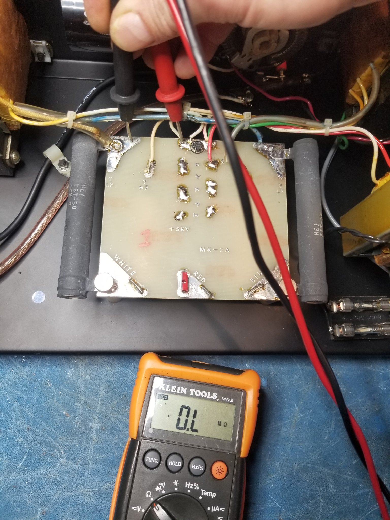

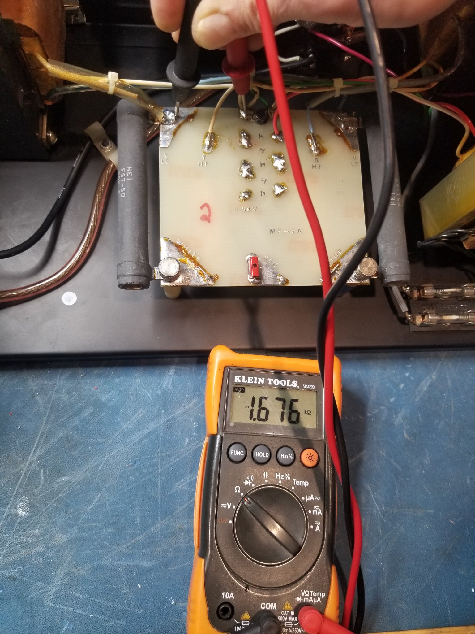

Also measures strange here. Again I'm not sure if this is helpful one bit. I'm still learning how these things work. I would imagine with everything being identical these readings should be similar. When in fact they are opposite from one interface to the other.

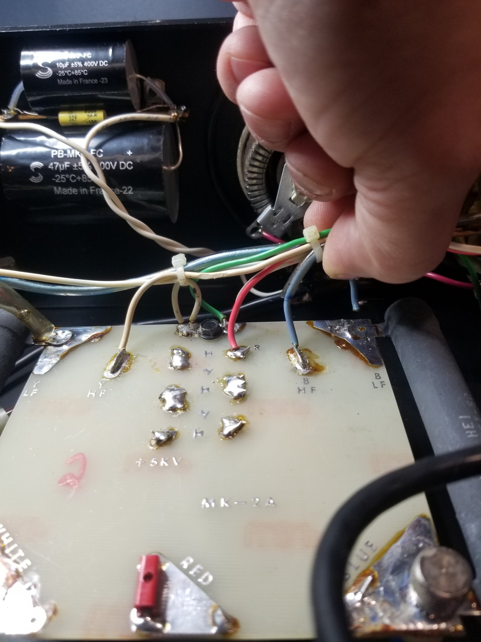

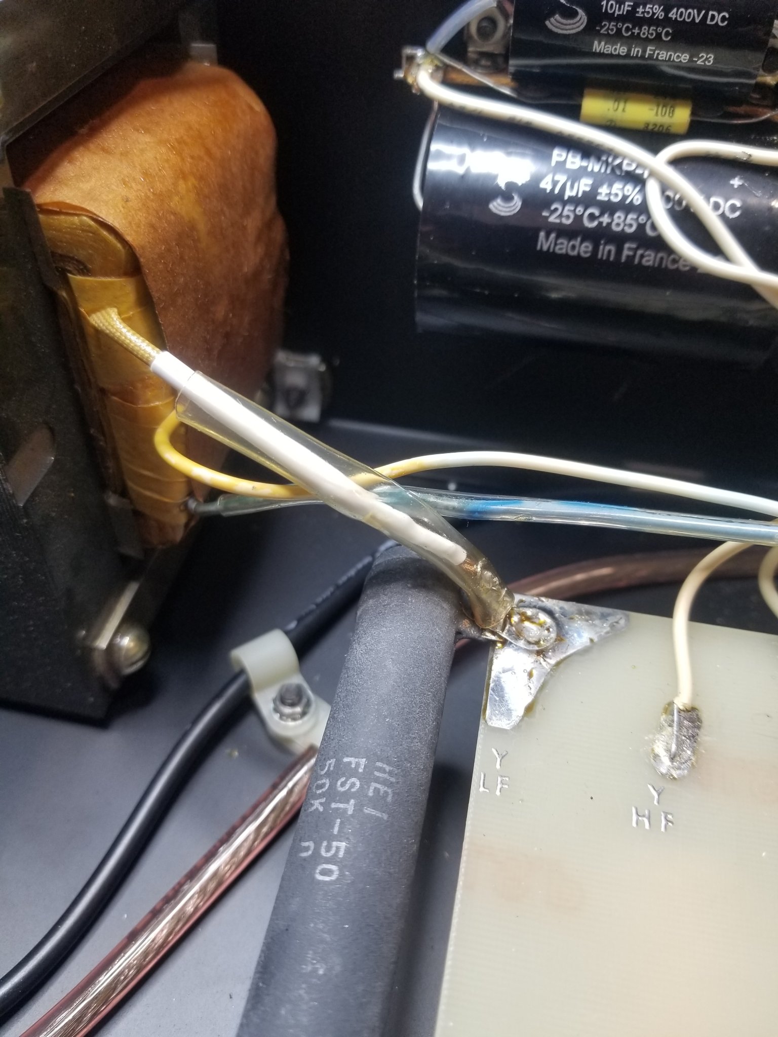

To me it seemed like on interface has a bad low frequency transformer and one has a bad high frequency transformer. As I was looking around in the one with the bad low frequency transformer I noticed this wire was broken from low frequency transformer. It looked like it was in place while it was sitting right against the pad that it was soldered too. Well I soldered that up and now the one speaker sounds great. It has great high frequency extension as well as great bass. I'm going to see if I can test the high frequency transformer in the other interface. The one I have running sounds excellent.
So the interface that still isnt working correctly is ok n my bench. I'm running a sine wave in and probing around. Where the wire from the low frequency transformer runs onto the pcb with the soldered down eyelet there is a poor connection. The wave isnt even half as big as the other wire coming from the xformer. So I cut it off and stripped the insulation and cleaned off the coating on the copper I'm getting the full size wave. I'm going to solder some wire on to extend it a bit and solder it down and hope that takes care of my issue. I swear this pannel seemed to be missing more of the high frequencies also but il see soon enough . Seems like a strange failure point. But I guess if when assembled the coating off the copper wasnt removed well I guess some oxidization could have built after all these years.
