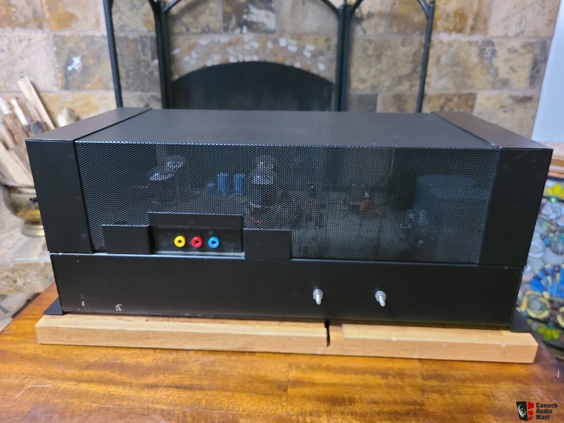

Hi, Can I use these on my 2+2 ? model X amps Thanks
