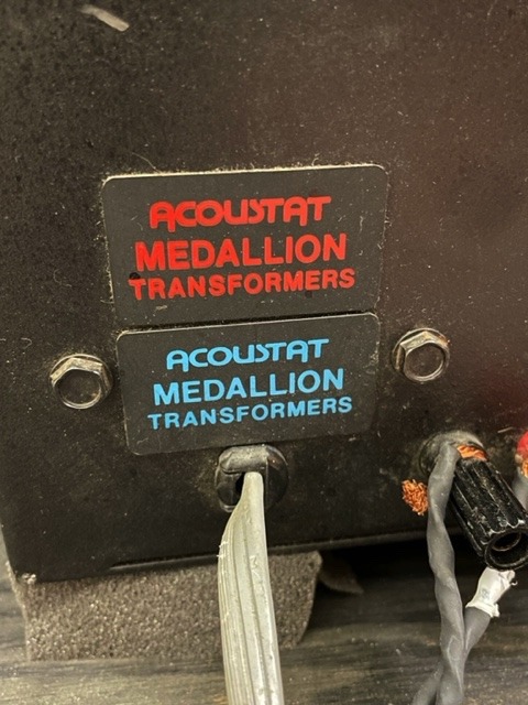

So if they have the Medallion Transformers and the C upgrade that would make them a Red Medallion? That is if I understood another post you made about different upgrades.

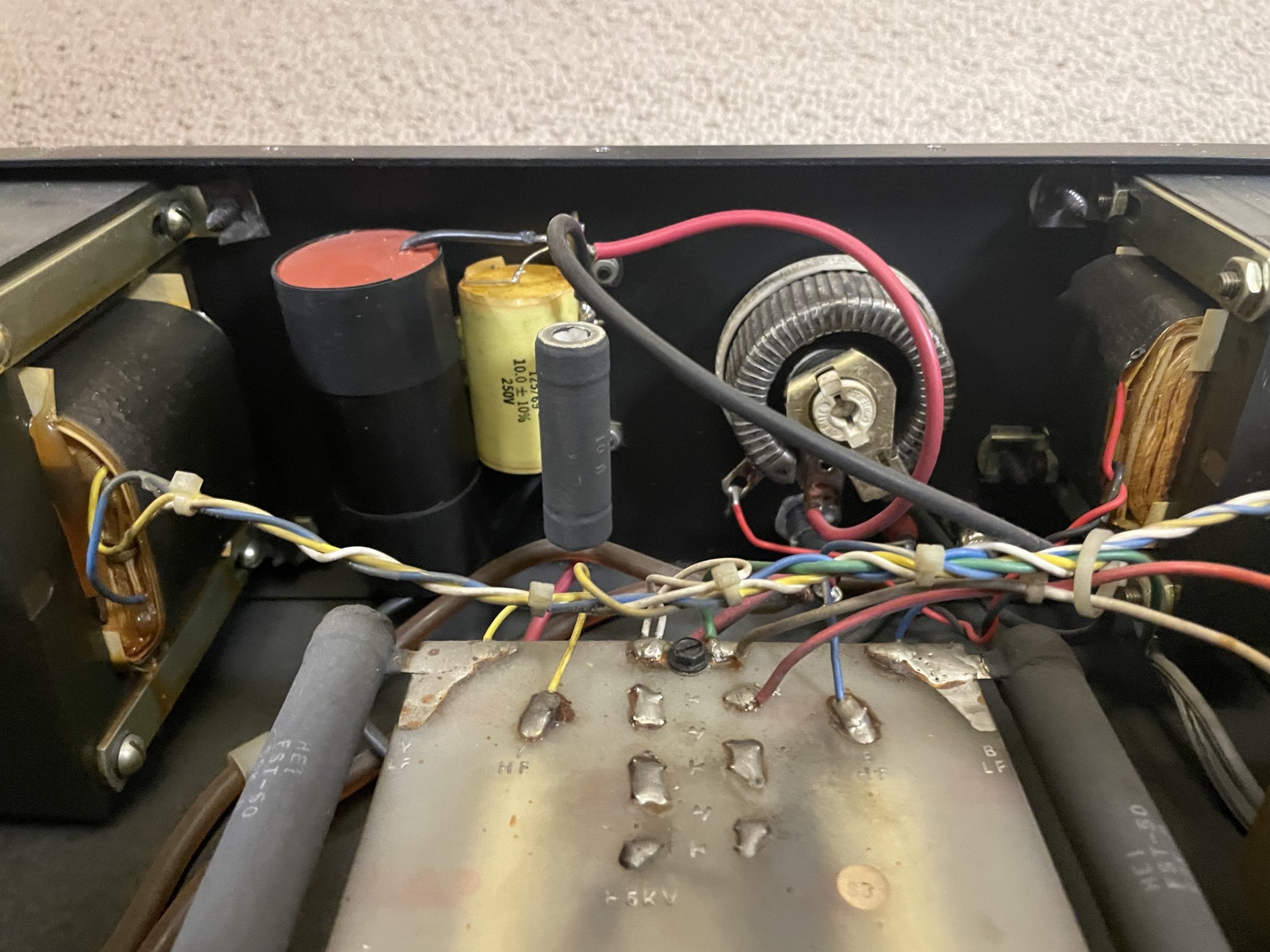

Do these pictures make it any easier to tell anything?

Do the Medallion Transformers tell you which Red, Blue or something else?
Out of curiosity, assuming they sound good, any idea what kind of value they would have? I realize it depends on, if anyone wants them but, I have not seen this model anywhere.
IIRC, the "RED" badge meant that the interface had both the medallion transformers AND the "C"-Mod. The "BLUE" badge meant just the medallion transformers.

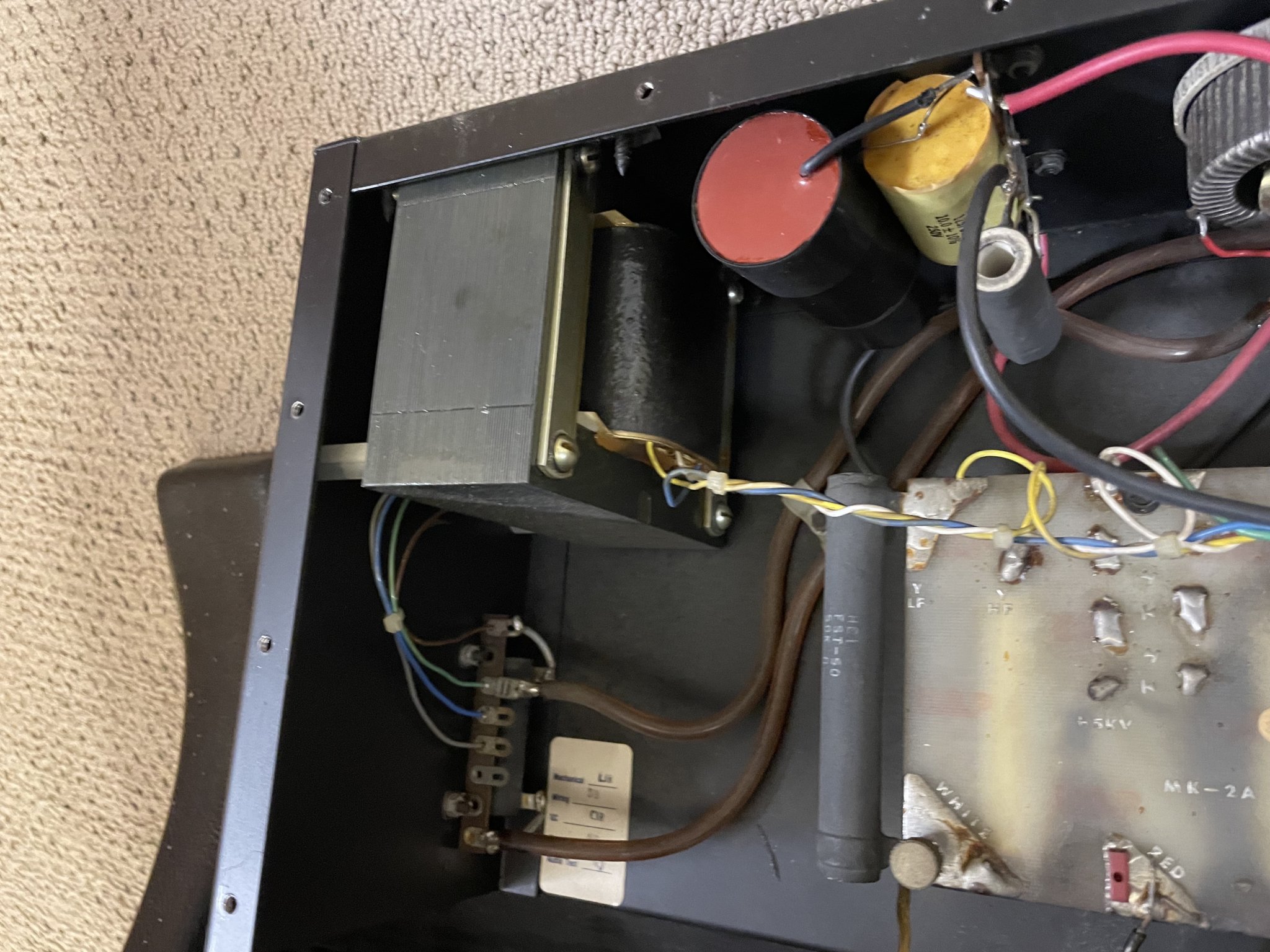

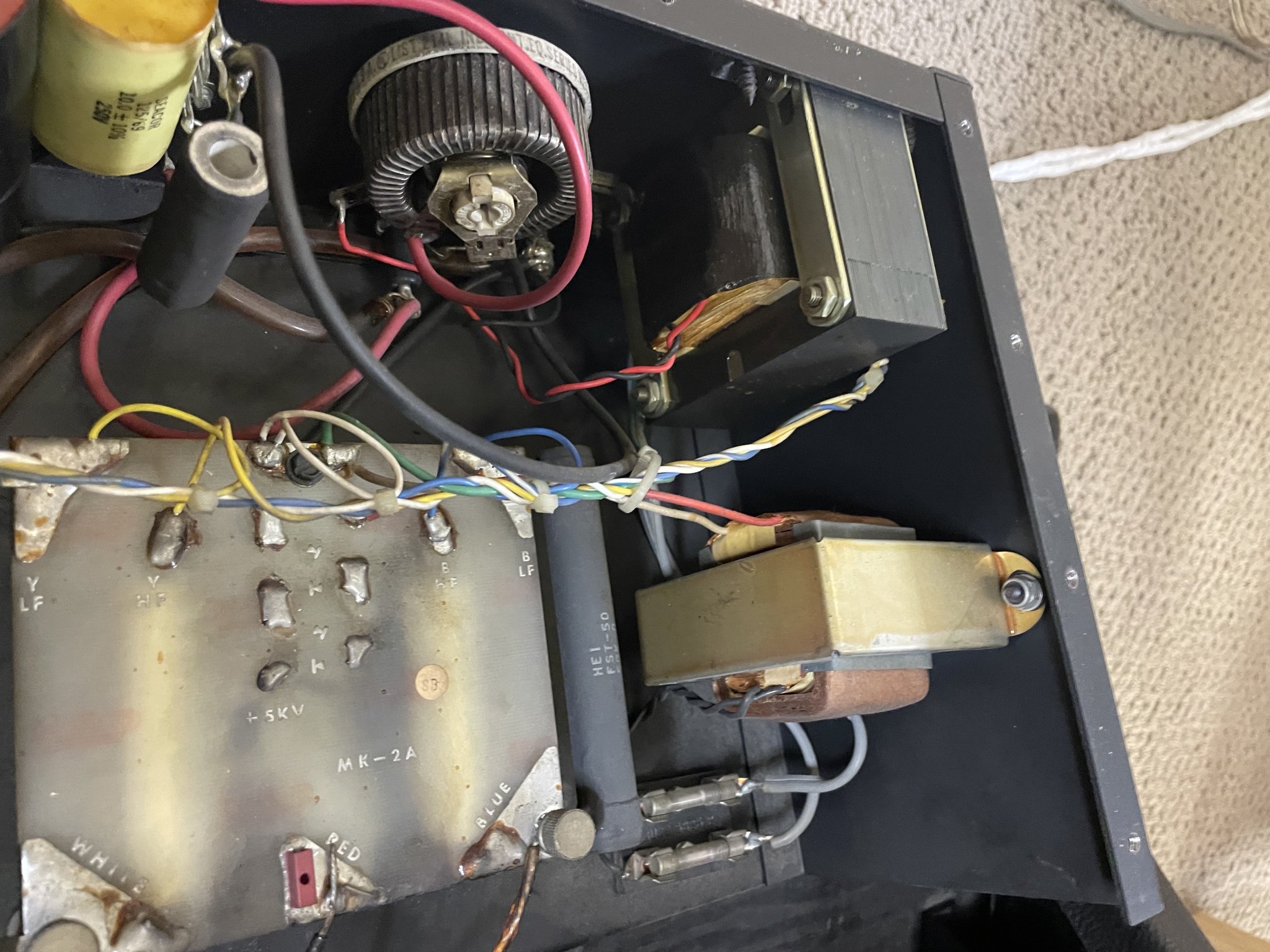

Yes, these interfaces definitely have the C-Mod, although the big black capacitor with the red ends is not a factory part. The C-Mod may have been done in the field.
The wire color codes on the LF transformer have me confused. These taps are used for adjusting the bass response, depending on the number of panels in the array. For your speaker, these wires should be red (2 panels), orange (three panels) and yellow (4 panels). The green, blue, and gray wires are on transformers intended for Models 6 and 8. So, for some reason your LF transformers appear to be for Models 6/8, an incorrect part. This will provide less bass boost than intended, but this might not be an issue for some listeners. Can you make out a part number printed on the transformer's black wrapper? Just curious to confirm my suspicions.
I took a flashlight and studied them as closely as I could and I did not find a serial number or model number on them. I’m guessing if there is it’s on the two sides I can’t access.
I may study the wires in the interface and study what you wrote and ask some questions about potential changes. But I may just leave well enough alone, because they sound good.
Hugh from Canuck Audio Mart pointed out to me that both interfaces have the Blue and Red Medallion stickers on them.
IIRC, the Blue sticker came with the in-field upgrade kit sent to us dealers. Once we installed the new Medallion transformers, we put the sticker on the back for ID.
The Red sticker was from the factory to indicate both Med & "C" Mod options. Since your interfaces already had a Blue they added the Red, again to ID both upgrades. They just left the Blue sticker.
That's my story and I'm stickin' to it...:p
Okay...I pulled out my decades old and smelly Acoustat dealer binder. The "C" mod was the in-field kit that came with the Blue sticker. The Medallion updates had to go to the factory, where they automatically got the "C" mod done to them also and received the Red sticker.
So, does that mean these had the Red upgrade and someone didn't just acquire a pair of stickers and put them on.
Not that I don't trust my fellow human but, people do some less than honest things. :eek:
I think Andy said, (well the way I understood it) was that you had Medallion transformers, just not the right ones. The Model 6 & Model 8 had (2) interfaces per speaker. I didn't know that they were different. It's been awhile.
Yes, I guess someone could have just put the Red badges on, but not sure where they got them. Who knows for sure, I guess?
