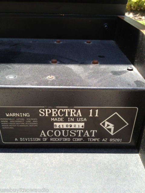

I have an opportunity to buy a pair of Acoustat Spectra 11 for about $400 which seems like a reasonable price (at least here in Sweden). I've never owned a pair of electrostats, only listened to Martin Logans in a store and I like the sound. The owner says they are in good shape, but has never played them, so I don't think I'll be able to try them out before buying.
What do you think, is it stupid of me to buy them without listening to them? What should I look for when checking them out? Can you remove the fabric protection and examine the ESL panels?
My room is about 200 square feet and I'll be using woofers for the low end. I have some acoustic dampening. Will the speakers work fine in my room?
I'm very grateful for any tips!

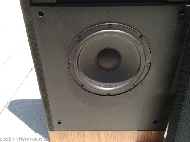

Acoustat 11
Just see if thay play!....
i would pay $50.Us...if you can,t play them...
if the bias dose not work the speakers ESL panels will not work...thay have two have to wal-tranfourmers...one for each speakers... this is how the speakers ESL panels chargs-up... frist pic is the tranfourmer/bias box on the back..this is were the bias tranfourmers come in from the wall Not in the pic...
No.2 pic is the base driver...I have had a pr back in the 90s...there sound is good...an well work in your room
goodluck
