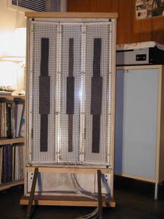

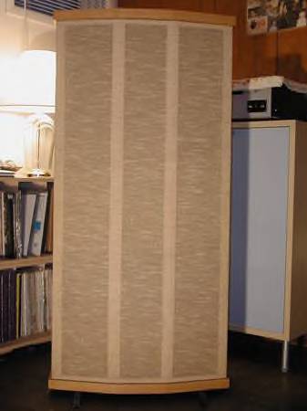

I have had the Xs with the stock sevos tube amps1,2,3,4,1+1,2+2s....1100,4400...the 6600 in a big room...WOW!.. Have had 20-9" panels over the years An just pulled out the tranfourmers 4bias..5 T1 4T2....the 2+2 with the Apogee hi-mid Ribbions...an i will say the the M3...or 3,9" panels work the best in any room an i think sound best with the 121 a,b,c interface....ezeer to drive,great bass...all round full rang ESL sound...can be Full rich an sweet... I think the 3s let you see what Acoustats sound like.... Here a older pr M3s....an look at these NEW 6600at the fac...Other well fill diff..
