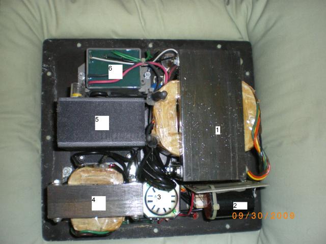

Soundlab interface.......

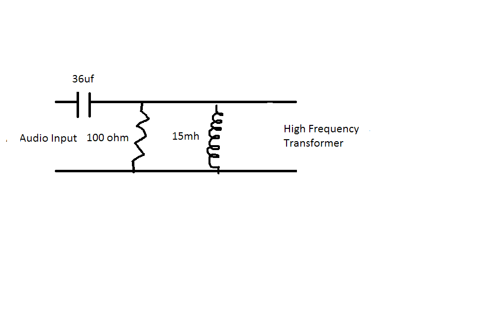

Here a pic of the older soundlab interface....an this is the crossover for the toroidal high frc crossover...thats moded out.......as with the Acoustat C mod.........eats power like king kong.....but with the older SS amps C mod help some ....some say a lot....but it a crossover C mod was for the Amp...not the panel....the A is for the panel an the best sound at the time...an still better than most!.........C not need to day......

Pot!......most take it out ...say it sounds better.....but then some take all this out...it lets one drive the SL with tube amps an anyother amp as i see it...this is like the Acoustat C crossover mod...with a coil added....to get the best base an over all best sound..... just set the Acoustats up like the SL....know res in the Mixers...just caps...this is key!.....goodluck
