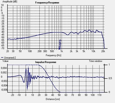

2- changing the type of the C2 caps wich are directly connected to the pannels :
=> I tried WIMA caps ang obtained a smooth precise sound, but I was warned by our DIYcolleagues that the caps I choosed are too low in max tension. So I switched back to the original yellow ones.

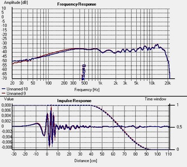

3- adding two steps to the tension elevator ladder. The power handling is
improved together with dynamics : see curve 2 in comparison with the original curve 1 : the impulse answer is noticably higher. But the sound is more 'projected' in the medium area. Measurement curve 2 seems to confirm this, with a less flat response in the medium area.

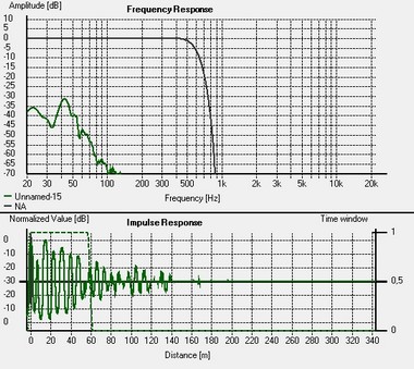

4- Adding a subwoofer in the very low area.
- The Sub is made of a JBL 15inch speaker with a carver PM1.5 amp and Behringer active filter. Works great from 20 to 60hz. Response curve is N°3. not very flat but low freq. measurement is almost impossible. This improved the power handling and stereo at high levels, and gives a deep and dynamic bass.
BUT... until today I could not find a good hi-pass filter for the acoustats.. I tried actives one but the result is very poor, the sound is not so rich andtransparent. Then I switched to a simple condensator between the preamp and the amp. The result is better sounding, but the slope is only 6db/oct, and still not as natural as without any filter (see curve 4, without -blue- and with -red - 20 Nanofarad Cap).
=> What would be a good way to low-cut the Acoustats at about 40-50Hz with a 12db/oct slope ?

While the planar bass may be satisfying to some, I want the real bass, down to 16Hz with room gain. Here is my recipe: LR48 crossover at 82Hz, DCX, pair of SVS PB13 subs. Last year I used Tact room eq, but that didn't solve all the problems. Now I'm going without any EQ (and it still sounds great) and exploring bass traps.
If you cross over much higher than 82Hz, you will start having your sub excite the floor-ceiling resonance, then you are toast without EQ (which doesn't really work either, that's what I was trying to do last year).

- I had similar conclusion : my sub is a 46cm (18'') JBL in a 90L bass reflex. Amp is an Carver PM1.5, and the filter is the DCX2496, low pass 85Hz / 48 db. I use a lot of equ, due to two strong resonnancy, one at 30Hz (Fs of the speaker) and the other around 80-90 Hz.
- What can be new for you is the way I choosed to Low-cut the acoustat. I'm using since a week a Kaneda-type filter (picture). Caps is 200 nanofarad, resistors are 2x4,7Kohm. This avoid to use the DCX for the filtering of the electrostats.
First I have been deceived with such passive filters between the preamp and amp (see previous posts), but I found BIG improvement when using high grade resistors and caps (Styroflex/Takman). The difference using Styroflex caps is really tremendous compared to FKP/MKP ones. Cost is ridiculous, so it's worth testing.
The result is a very important increase of power handling (about 5-6db) ! Also music pieces such as big operas or film music (eg Hanz Zimmer classics) gains significantly in musicality and articulation. I assume that this is due to that the amps and eletrostats are working in better condition, and that there is less cross influence between the sub and electrostats.
BUT, the low-middle area becomes very dry, less 'smoth' as when the electrostats are working alone... I keep the two options, 'with' for 'big' music and 'without' for more intimate parts.

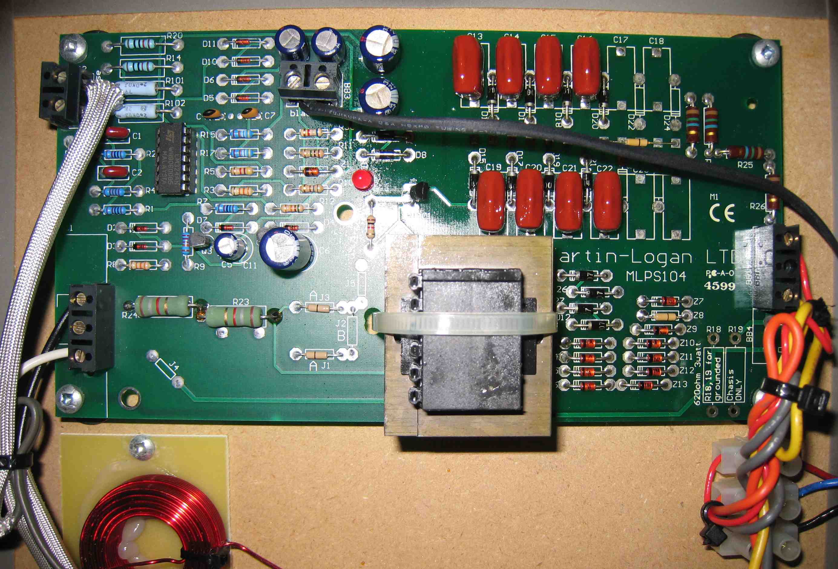

I have ML SL3 which have empty space on the bias supply board for two more rungs on the HV ladder, so should I.....? How do I decide?

its no matter of robustness but a matter of when the voltage gradient either in air or in the insulator becomes large enough that lowlevel ionisation and eventually flashovers occur. If the voltage gradient stress in a material gets larger, the process of ageing quickens.
So most panels Bias is set to a value with a good reserve to flashover treshold.
The thick insulating PVC-layer and the distance of membrane to stator-surface of the Acoustats allows and asks for high bias-voltages, but it does have the same issues with regard to voltage-gradients, added the problems of higher voltages generally.
