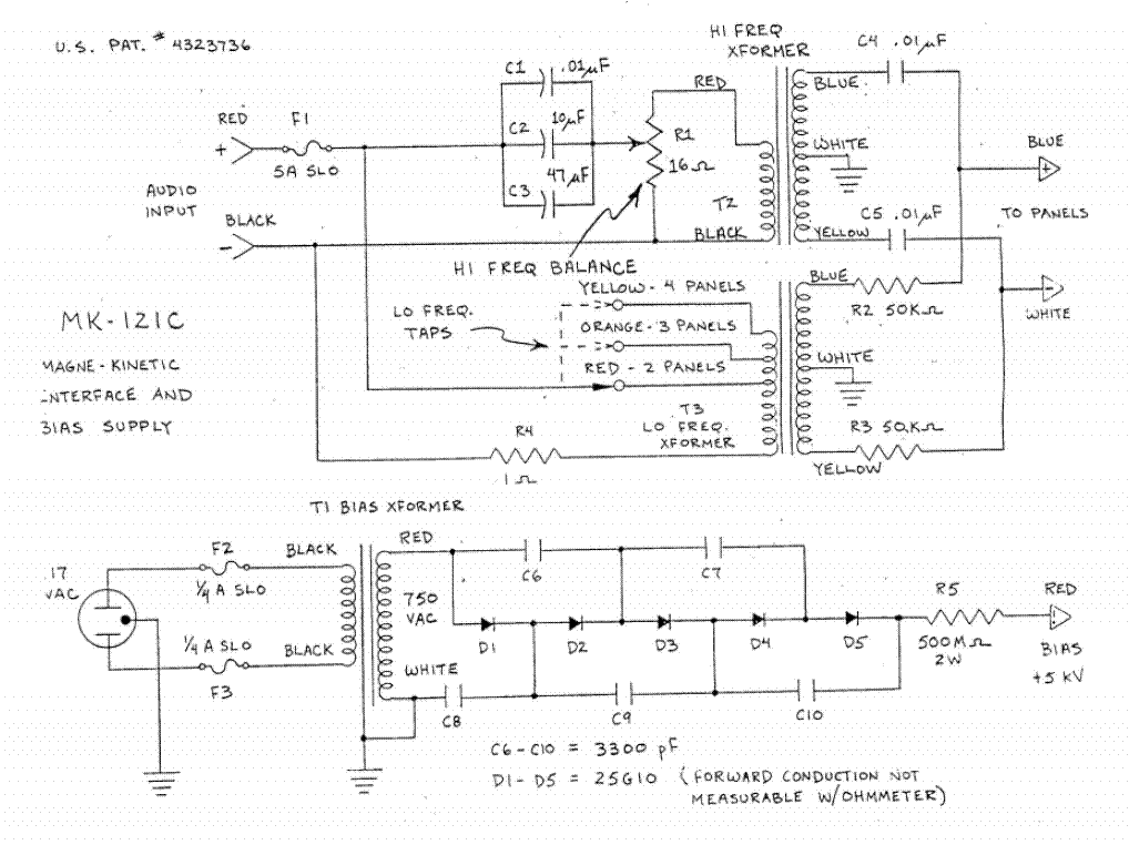

Calvin, the Acoustat interface fuses the speaker input line... fyi. They also fuse the PS.
The other possibility is that the HV multiplier string that produces the bias voltage for the cells has malfunctioned. This would cause lower output and distortion when driven harder.
I've posted this before, but the short version is that you need to be able to solder, mark the position of the diode's polarity on the board, then remove the diodes, remove the caps and replace with suitable HV units. You want >3kv (5kv+ ideal) diodes (low amps ok) and >5kv+ ceramic NPO caps (although Z5U will work ok). The value of the caps is printed on the caps, you can go +100% and -25% on the value no problems at all. Replace them all unless you have a way to test. Will cost you about $30USD per channel worst case. Any decent Electronics repair shop can do this job for you if you present them with the HV boards from the interfaces. (open the interface, and make a drawing of the wiring to the board, desolder, remove...)

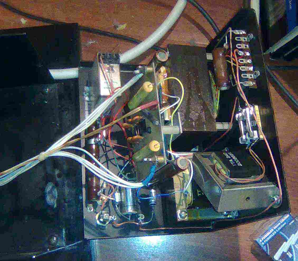

Post a picture of the interface inside if you are unsure what is what...
The Acoustat HV boards often fail now that they are >25yrs old.
The caps get leaky and kill the diodes, drag the voltage down...
If you could troubleshoot, you could replace just the bad parts, but the parts are cheap enough, and easy enough to replace... a clue is that the channels are not equal output, although that may not always happen...

Wrong caps - but the ones you changed MUST be of VERY HIGH VOLTAGE or they will break down. Did you save the old ones? Note the ratings - iirc like 15kv or so!!!
The caps you want to change are the ORANGE ones. Do those first, then the diodes, or both at the same time... never the diodes first. The caps failing kills the diodes... although the diodes failing might kill the caps too... 😀
The impedance of the Acoustats does not fall like most ESLs... the interface is patented and that is part of the point of it.
In the second image the big series resistor seems to be overheated and has some burn spots, hard to tell from the pix...

Bear,
- Original caps are 0.01mF-6000V. I replaced tham with a serie/parallel arrangement of 4000V caps.
- You are right, the big resistor is somewhat burn... Needs repair...
- I'm not very familiar with the Diodes, ebent less in the high tension field.
What should I look as spares ? Nothing is written on theses...

Be advised that the original Acoustat cap is rated for 6000VAC.
Your series/parallel arrangement of WIMA caps are rated for 4000VDC, but only 1400VAC.
These capacitors need to withstand the high voltage audio signal produced but the step-up transformers.
Maybe this is why you have been blowing fuses?
You might contact Moray James as he sells Polypropylene caps to replace the Acoustat Polyester caps with the proper AC voltage rating.
the diodes are simple just find "high voltage" diodes. You want PRV or PIV of 5kv or more, that is all you need. Current is low. So any diode that is not expensive with that spec will do fine. The current is very low, so a 1amp rated diode is more than good. 0.5A is good too... check the usual electronics distributors. As I said you can series two 3kv diodes too... CHANGE THE CAPS!! 😀

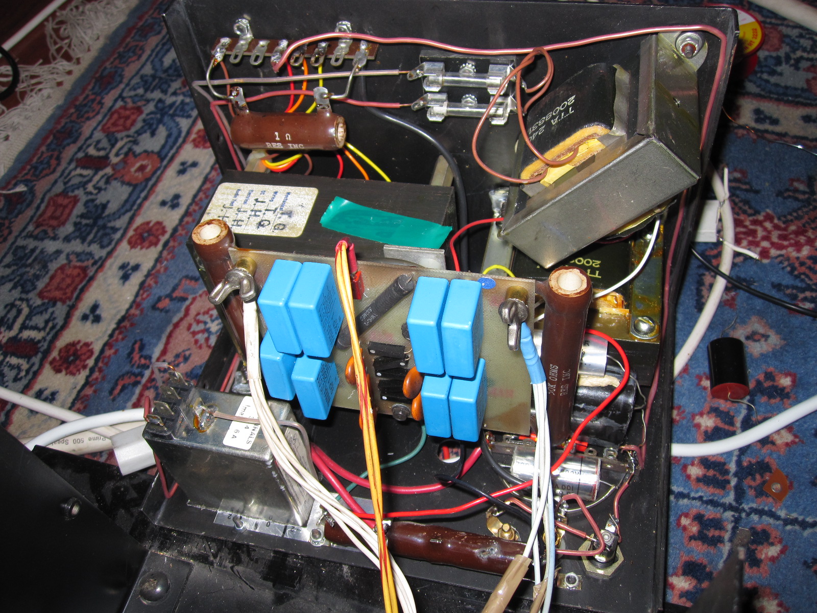

Largely on Moray's advice, I replaced all the caps & diodes in the multiplier circuit, and added two legs. It was well worth the effort. (Thanks again, MJ!) Making those changes to the interfaces yielded better dynamics and immediacy, tighter bass, with a more effortless & energetic presentation. I didn't take any measurements but they did seem to play louder than before the changes. While I wouldn't say the differences were astounding or mind-blowing, they were clearly audible and were a good improvement. These were used with a 2+2 which will play louder than a 1+1 but I have no doubt the results I had would apply to the 1+1. I ran the 2+2 full-range with a beefy Hafler DH-500 amp and never popped a fuse or arced. They played much louder than my ears could take.

Mathieu: I have been charging $15.00 each for the caps so $60.00 for the set of four pieces posted in a small package I would imagine $20.00 postage. My pay pal is morayjamescables@yahoo.com
I know that folks here may howl at this but for a good number of years I have been using 1N4007 generic diodes (2 in series) to replace the stock diodes and have not had a failure yet they cost pennies each use those as they are available anywhere. Best regards Moray James.

I'll change the caps as soon as I receive them. I assume that the orange components on the board are the resistors of the High tension ladder.
3300M means 3300 Mohms. Is that correct and shall I change them too ?

The orange components labels 3300M would be the HV mutiplier capacitors and are 3300pF.
The are components C6 - C10 in the attached schematic.
If you are replacing them, I would recommend using caps with voltage rating of 2.5kV - 3.0kV.
FWIW, the 2 or 3 Acoustat HV supplies that I have measured are driven with about 750VAC which matches Acoustat schematics( I posted one in the previous post). This being the case, the worst case theoretical PIV voltage that the diodes would see would be 750VAC x 1.414 x 2 = 2121 Volts which, I would bet, is pretty much in the noise of the voltage ratings for two 1N4007 in series.
I reality, only the first diode in the supply will see anything close to this voltage. As you work down the chain, the PIV requirements taper off since the actual voltage stored by each capacitor that the individual diodes charge falls off the further down the multiplier you get.
All true, but in practice, the caps tend to degrade over time... there is internal migration of the conductive coating on either side of the "puck" of ceramic, this causes leakage... higher voltage caps have a fatter puck, and are more resistant to breakdown. I'd go with 5kV or higher caps.
Measuring along the multiplier the drops appear to be pretty even... about 1.5kv per, iirc...
Since it is cheap enough to get the higher voltage caps, why not? 😀
