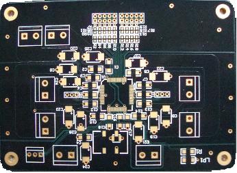

DAC build progress
All boards as in the preview (ackodac Sys) have arrived and assembly/testing work is in progress🙂
Coming to terms now-There is a freakin' amount of work to put them all together
Will update and post pics soon
Regards, Acko

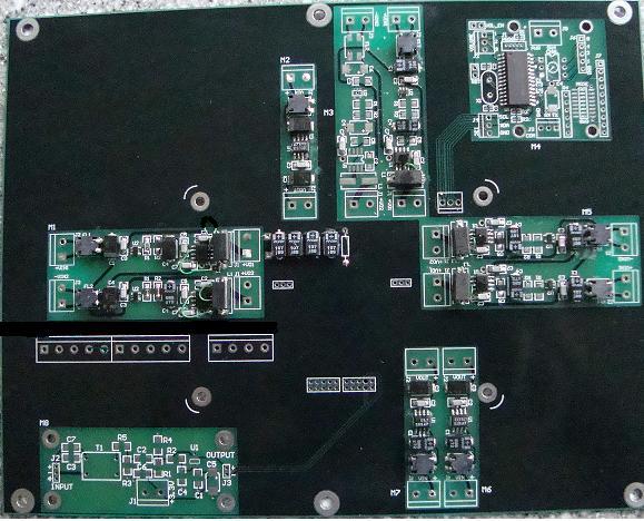

Build Progress & Update
See attached pics for assembly in progress. All lownoise regs and other modules on a motherboard for testing purpose. DAC Module will be mounted on top (centre) and plugged in to supply pins. Top right is the MCU and bottom left is a Spdif receiver.
Some update of specs as in the attached DACpreview.
All looking good so far. Once testing is completed this DAC will be prepared for release ~ end of this month.
Some ordering info and pricing:
1. Bare Boards from US$50
2. Populated boards from US$220
More updates to come.
Regards Acko
Regards Acko
