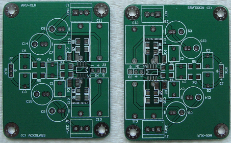

There has been some updates to this 9016 DAC board. New version has inputs re-mapped for stereo I2S/DSD and 2CH Spdif (TTL). Board layout has been further improved and now with U.FL coax for direct connection to popular transports. Available as bare boards and chip mounted options.
Matching IV boards are now available
