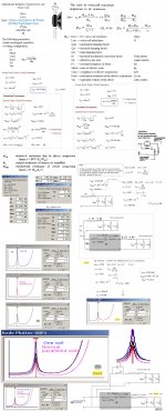

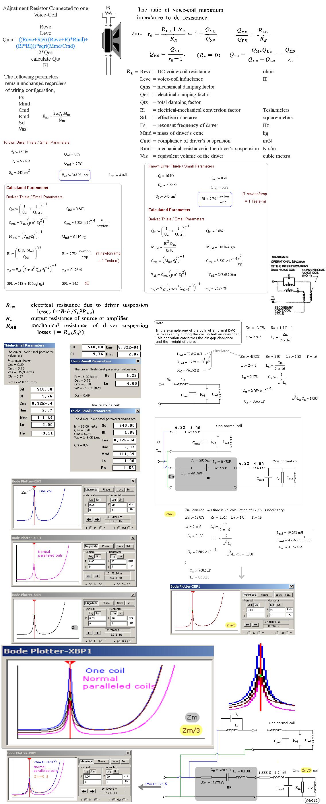

Take a look at the picture showing simple 'Watkins' tweaking a DVC coil without changing Mmd.
Note:
In the example: One of the coils of a normal DVC is tweaked by cutting the coil in half an re-winded. This operation conserves the air-gap clearance and the weight of the coil.

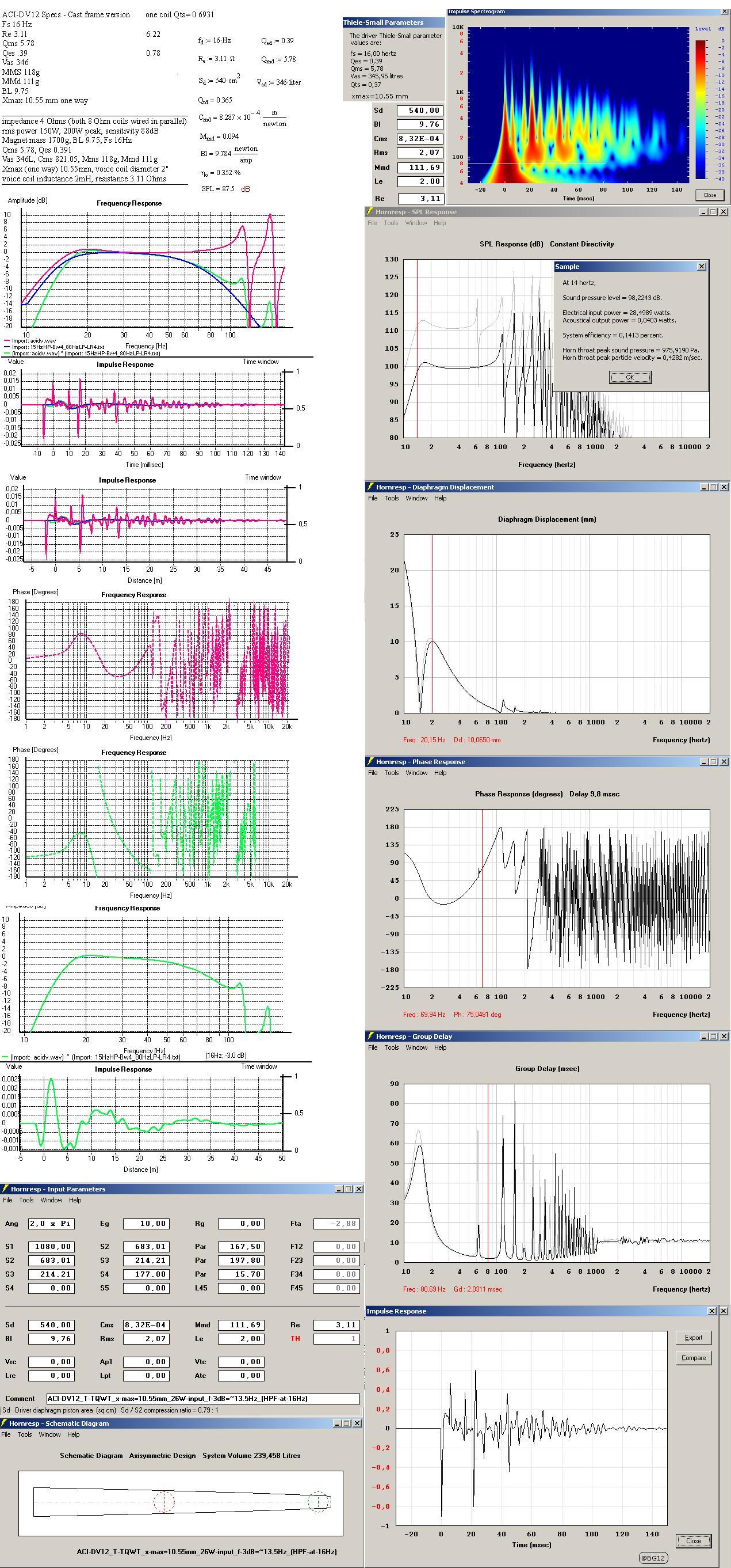

IMO, better use of the ACI-DV12 driver : The second of submitted pictures.
