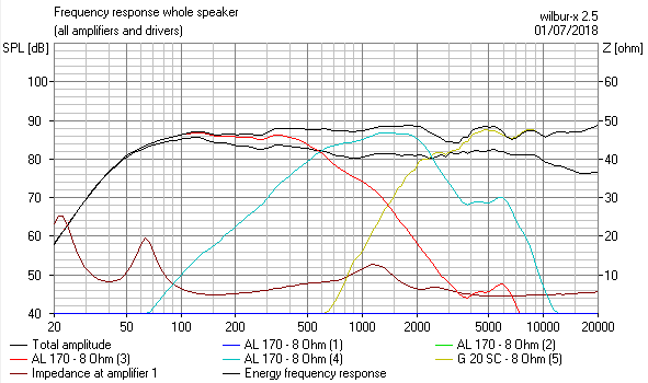

I think it's quite plausible that the dip at 3Khz is a diffraction effect from the cabinet edges. I got something almost identical doing a sim for Wilbur-x with a tweeter placed at the top of a 20cm wide cabinet.
Your IPL is close to the driver placement I was using. S2tlk Ribbon
Moving the driver down and putting it off centre seemed to fix it in the sim. 10 cms is approx. a wavelength at 3kHz.
Here's the sim restored to all its horrible glory.
Tweeter in middle of 20cm tower cabinet, 10 cm from top.
I really wondered what was going on with an ostensibly flattish tweeter! 3kHz, 6kHz, 9kHz. 😕
I don't really understand why whole wavelengths cancel, but I am sure it is easily explained.
