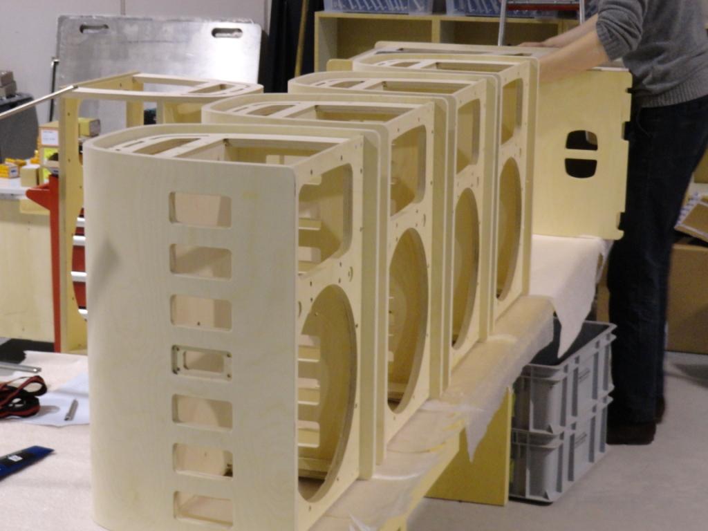

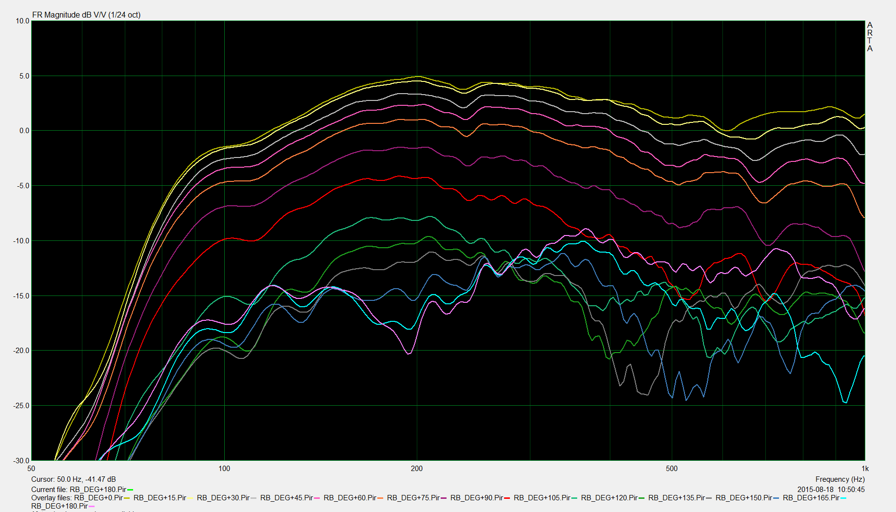

I think you guys don't actually disagree. At low frequencies you need a large distance between the two poles, otherwise you a lot of displacement is required. No discussion there. Pro Audio cardioid subs are usually about one meter deep, which results in an effective acoustic distance of a little over a meter. The result is that on-axis both drivers have the same phase at approximately 70 hertz (+6 dB relative to one driver) and only below 25 hertz will the combined output be less than that of one individual driver.
Absolutely! Below you see the far field response at different angles of a 15" driver in a passive cardioid enclosure, for which I did exactly that. Only below approximately 130 hertz does its on-axis output start to drop, in comparison to a monopole. The combination of said speaker and an active cardioid subwoofer has both very good directivity and it goes really loud!
So an "efficient" dipole - like described above - for LF might hardly have more than 2 octaves useable bandwith ... that seems not very attractive.
But this not a problem with a real cardioid, if the rear source is low passed properly, and the front source's DI "does the rest" at mid frequencies, to maintain a rather constant radiation pattern. One may still need a midrange unit capable of low crossover frequency.
@keyser: I didn't notice you are professional manufacturer !
Your product looks well designed for purpose, maybe even looks a bit too precious for touring and PA ...
I will keep your homepage in mind, maybe we could communicate via PM about one thing or two next time.
