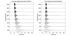

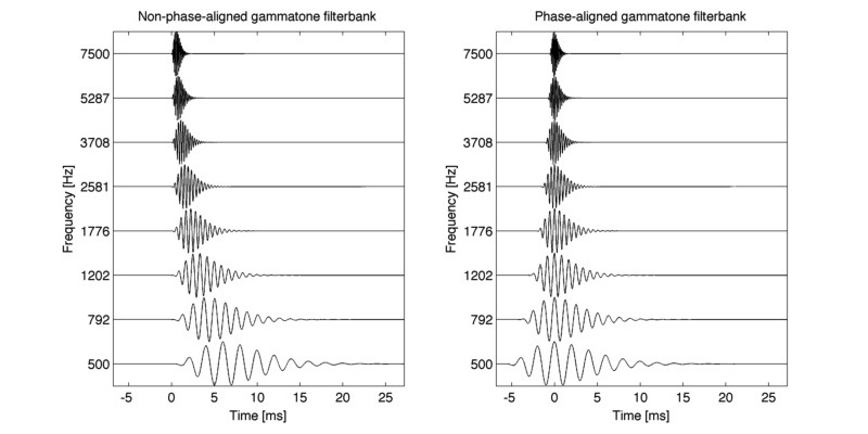

Does it follow from the group delay audibility threshold that 3.2ms is integrated at 500Hz and the above applies within that window?
The way I look at it is the integration time varies with frequency according to the impulse response of a set of gamma-tone filters.
