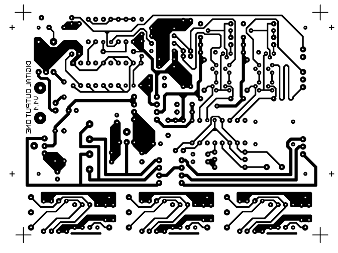

A while ago I stumbled across a series of documents posted on the Audio Crafters Guild website describing a re-clocking circuit the Digital Output One and it's implementation in the VRDS 7 and T-1.
http://www.audiocraftersguild.com/AandE/DOO1.1b.pdf
http://www.audiocraftersguild.com/AandE/doo11rev1.pdf
http://www.audiocraftersguild.com/AandE/teac-doo.pdf
I've been interested in building one, but as time passes that becomes a more and more difficult task. The key chip MC10216P for instance is now EOL'd but can probably still be be sourced.
I'm wondering if it is still worth the effort of sourcing the "hard to find" parts or has the design been rendered sufficiently obsolete by more recent developments not to be worth the effort?

Ok, seeing I got no negative (or positive for that matter) feedback on the DOO, I'm going to push on and build one.
I've managed to source a few MC10216P and 74FCT244P - the 74FCT2244 seems to be unobtanium in thru hole. MOQ's on the amidon multibeads and scientific conversions parts mean that I'll end up with "rare" parts for 3or4 x DOO.
Over the break I'm going to take a look at re-doing the layout of the boards to incorporate changes described in the DOO11rev1 document, and will get a few boards done early next year.
If anyone is interested in a set of "rare" parts and a board let me know 😉

Rather than redo the artwork from scratch I've used Illustrator to alter the artwork in the DOO1.1b.pdf to reflect the changes discussed in the other two pdfs referenced above.
The changes described in teac-doo.pdf are:
Hopefully the changes I've made to the layout reflect this 😉
cheers
Paul
Then I cut off some traces on the pcb so only one of the eight buffers where left
driving the S/PDIF interface transformer. This should improve the noise level further and also improve jitter performance as eight buffers will not turn on and off at the very same instant, se also [2]. Here is how I did it: Pin 9 on flip-flop U3 shall only be connected to the buffer input on pin 8. So I cut of the pcb trace leading to the other inputs (pin 2, 4, 6, 11, 13, 15, 17) and connected them to ground at resistor R23 with a piece of lead cut off. Resistor R22 shall only be connected to the buffer output on pin 12 of U4. So I removed the pcb-trace connecting pin 3, 5, 7, 9, 14, 16 and 18 with pin 12.
