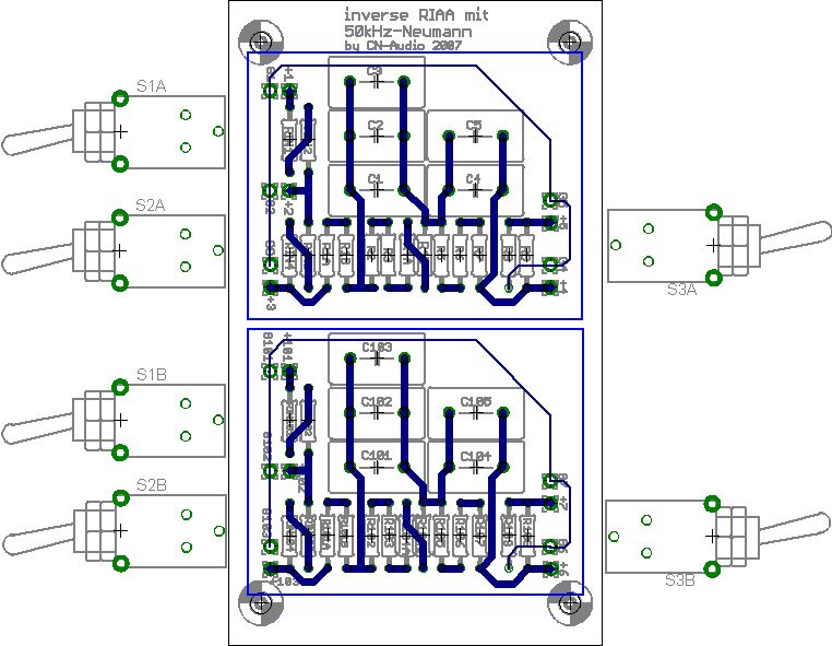

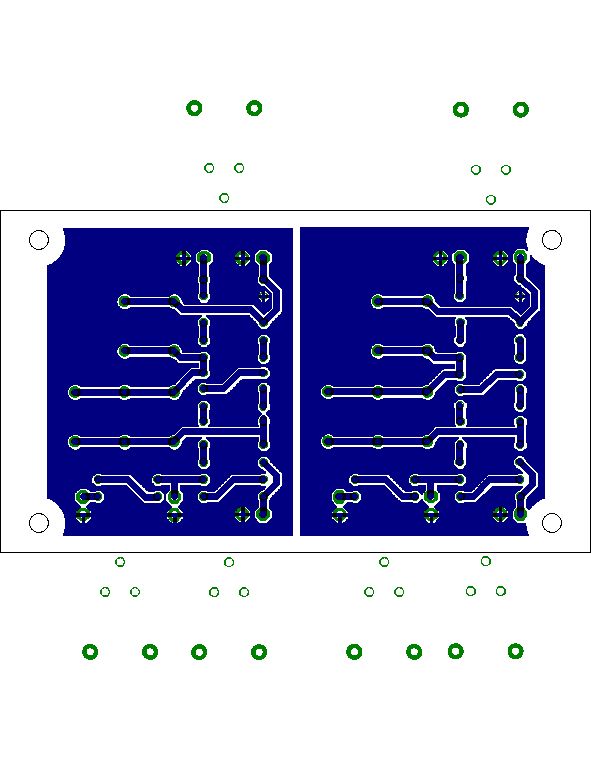

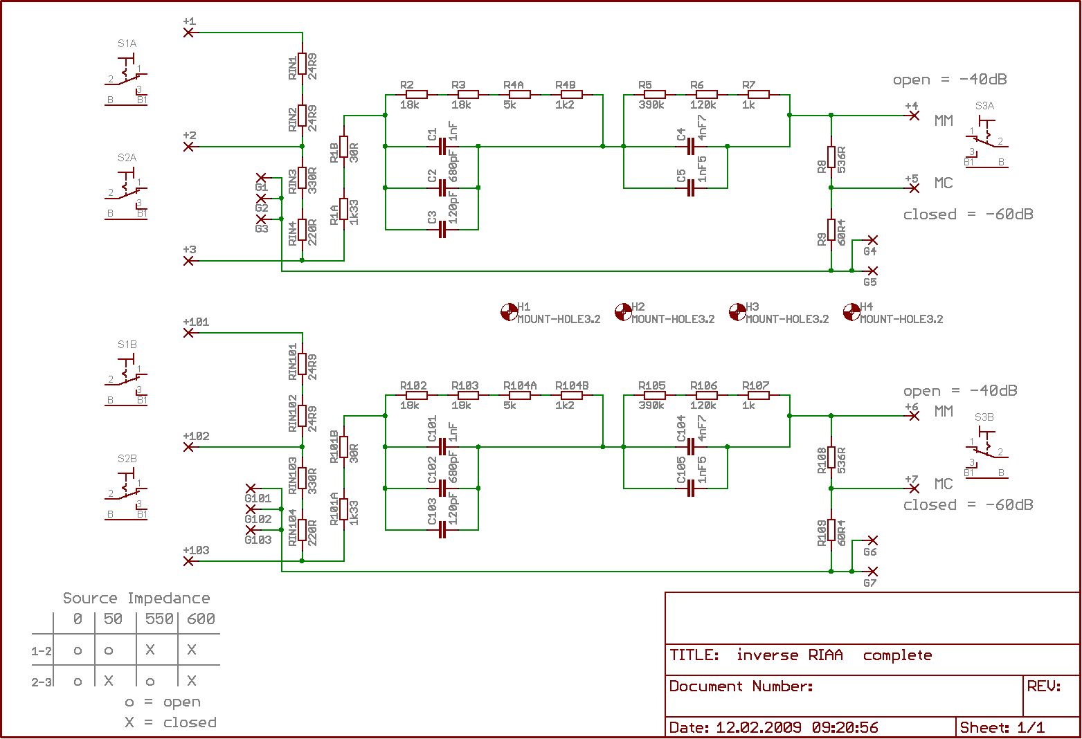

Mmmm. I've just tried the updated zip file with jlcpcb, oshpark and I'm still getting a zero size board. jlcpcb say width and height are null and that it cannot determine the board outline. Oshpark also gripes about size/drill file.
I'll have a prod around, like I said I'm really not familiar enough with this sort of thing to be sure I fully understand what I'm being told by the fabricators...
JLCPCB Analysis Results #1
layers : 2
minimum trace width : >=10 mil
minimum trace spacing : >=10 mil
minimum drill size : 0.05 mm
width : null
height : null
JLCPCB Analysis Results #2
Can not identify the board outline
Inverse RIAA.DRL(null): Non-gerber274X/excellon formats
Inverse RIAA.GDD(null): Non-critical Gerber file
Inverse RIAA.GDG(null): Non-critical Gerber file
Inverse RIAA.GPM(null): Non-critical Gerber file
Inverse RIAA.MAT(null): Non-gerber274X/excellon formats
Inverse RIAA.TOL(null): Non-gerber274X/excellon formats
OSH Park Analysis results
Warning: File is not valid drill file: Inverse RIAA.DRL
Failure: Removed drill file, did not contain tool size information: Inverse RIAA.TXT See help page.
We couldn't find the board outline. See help page.

Seems the problem is because I put two identical boards in next to each other (for stereo) and this is confusing the Gerber readers. I've made it a single board by deleting one of the boards from the file and its now uploading correctly into my board supplier's reader and they've accepted it for manufacture. (I must have only had 1 board in the Gerber file when I made my original unit 5 yrs ago)
I've ordered 10 so if you wait you can get one board for $7.50 or two boards for $11 plus postage of $2.50. They will be here in 7-10 days.
If you can't wait, the file that works with me is below.
Hopefully the issue is solved now 🙂
I've updated the first post on this thread - boards are now avaiablle if you want to buy them instead of etching them (just follow the link).
I've still left the Gerbers up on hifisonix as a service to the community if you still want to etch your own.
Happy RIAA'ing
