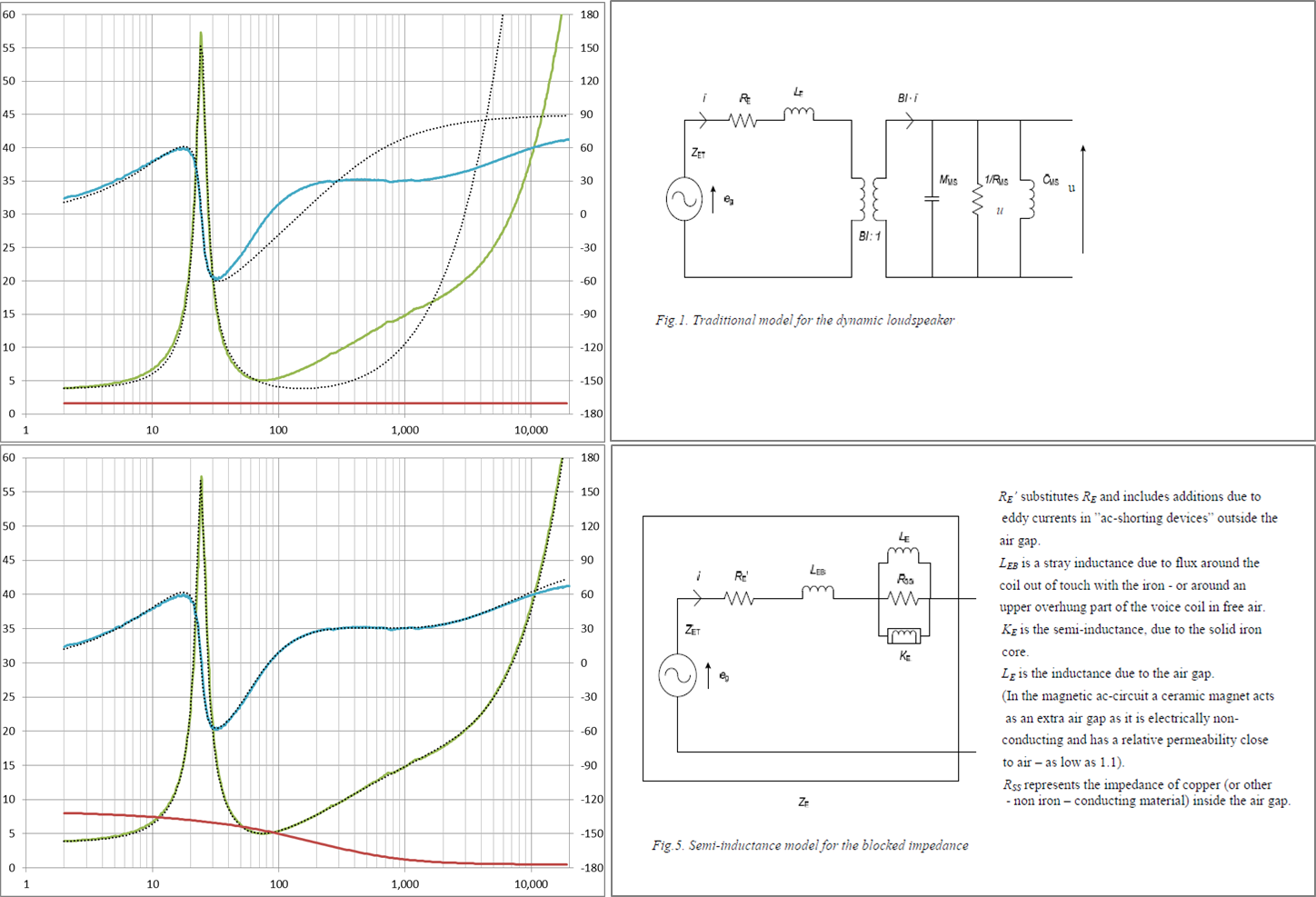

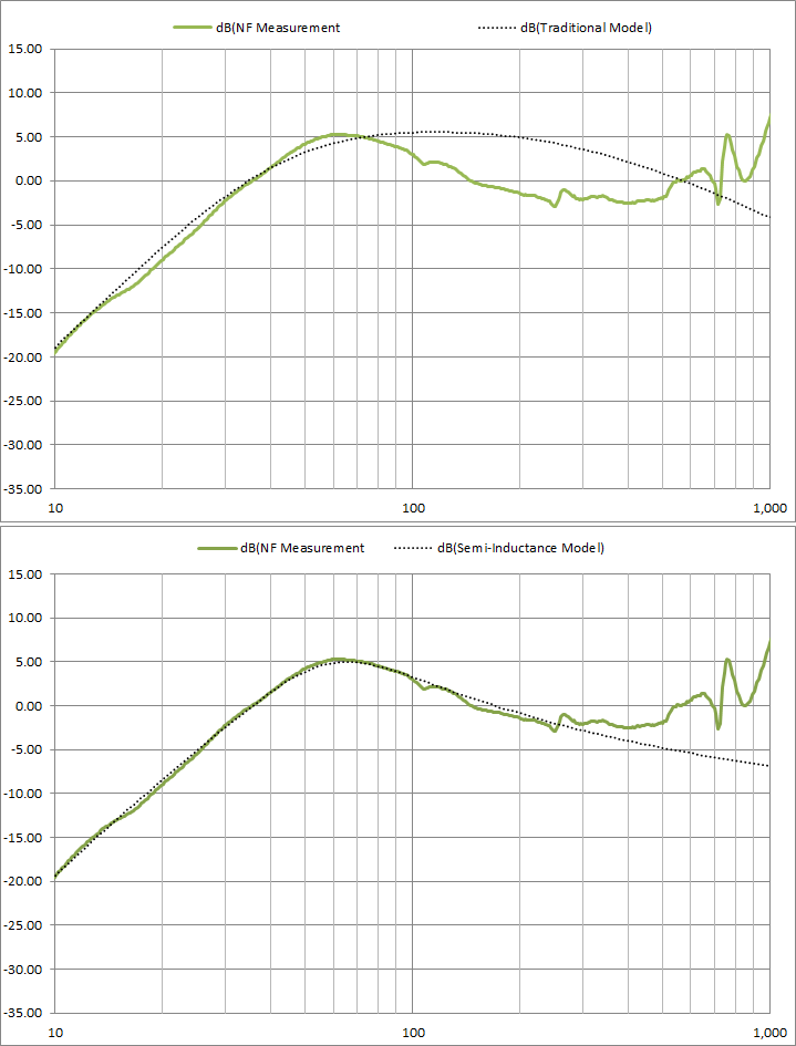

I'm not sure if this is related to your problem, but if the woofer you are using has significant inductance at lower frequencies, you won’t get good matches with most simulation software. This is often the case with modern subwoofers. Attached is an example comparing measurement and simulation for the Dayton 12” classic subwoofer. You can see that the new semi-inductance model provides near perfect match with measured response as well as measured impedance. The traditional model falls short.I can not get good agreement between my box simulations and my measurements of built boxes, what is your experiencies and what softwares works good for you?
Currently, Hornresp is probably your best choice for modeling software that incorporates this.
For more information on the semi-inductance model see thread here:
Semi-Le_Calc: Calculator for Advanced Inductance Model Incorporating Semi-Inductance

Do you know any other simulators which are using extended impedance model with Leb, Le, Ke and Rss? If yes, why they are worse than hornresp?
Yes, there are 2 others that I am aware of as mentioned at the link in Post #6
Modeling software that supports the Semi-Inductance model:
- Hornresp
- VituixCad
- SoundEasy
I few more details from the VituixCad and SoundEasy Manuals posted here:
Semi-Le_Calc Post#13
I recommended Hornresp because it is only a box modeling program, so likely easier to get going with than the fuller featured simulation tools of VituixCad and SoundEasy. If you know of any other simulation tools that offer this capability, please let me know and I will add them to the list.
