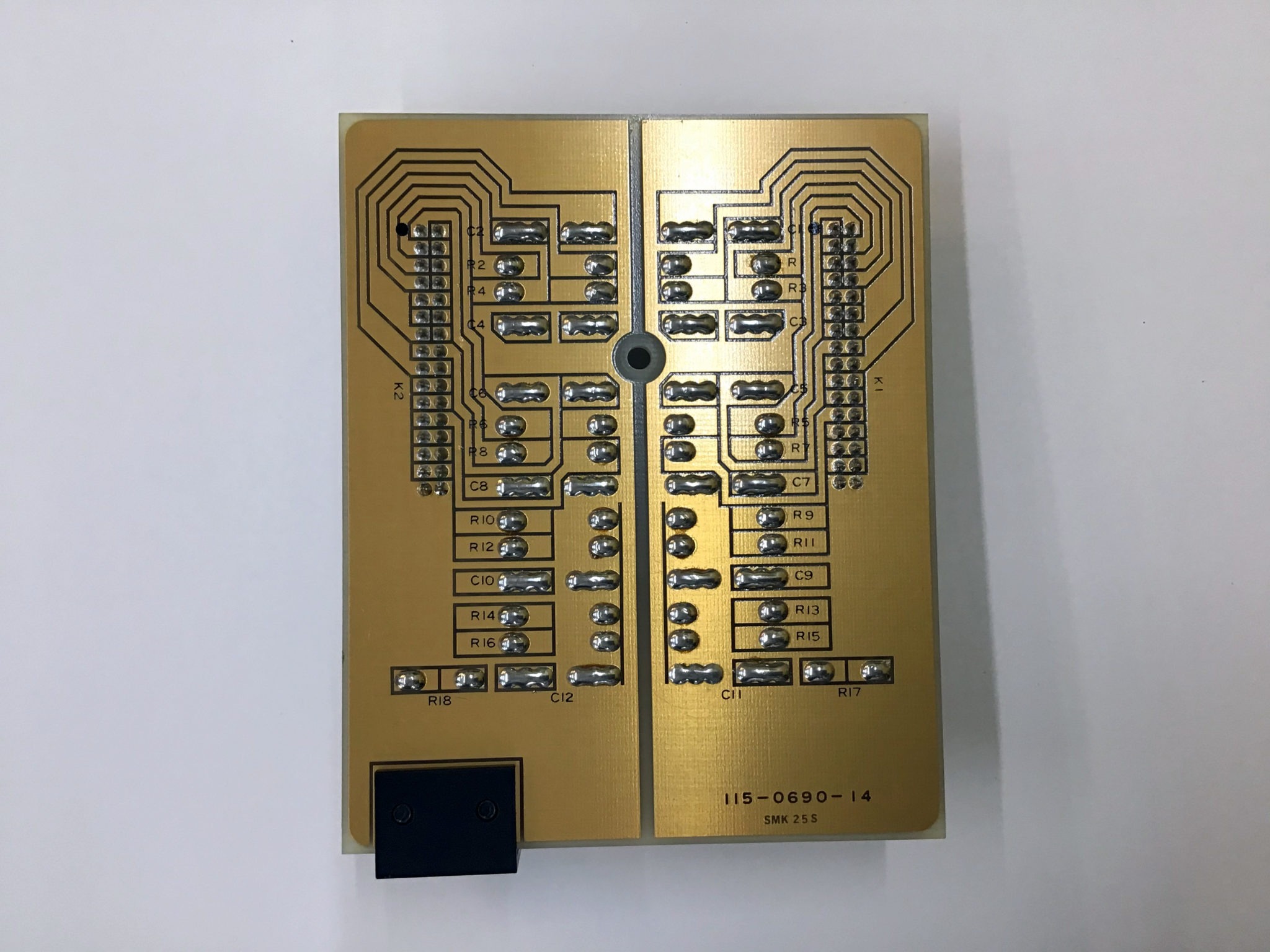

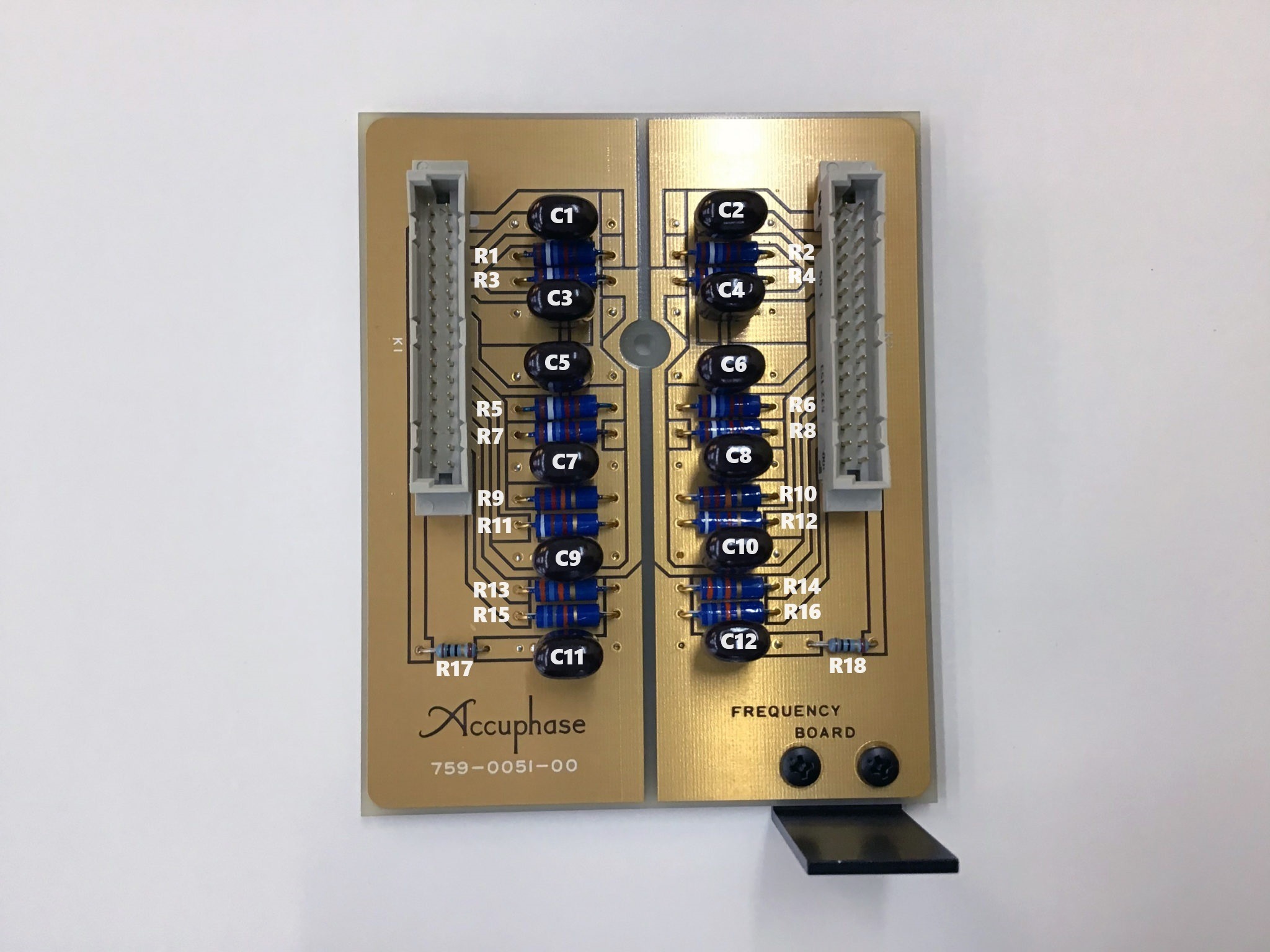

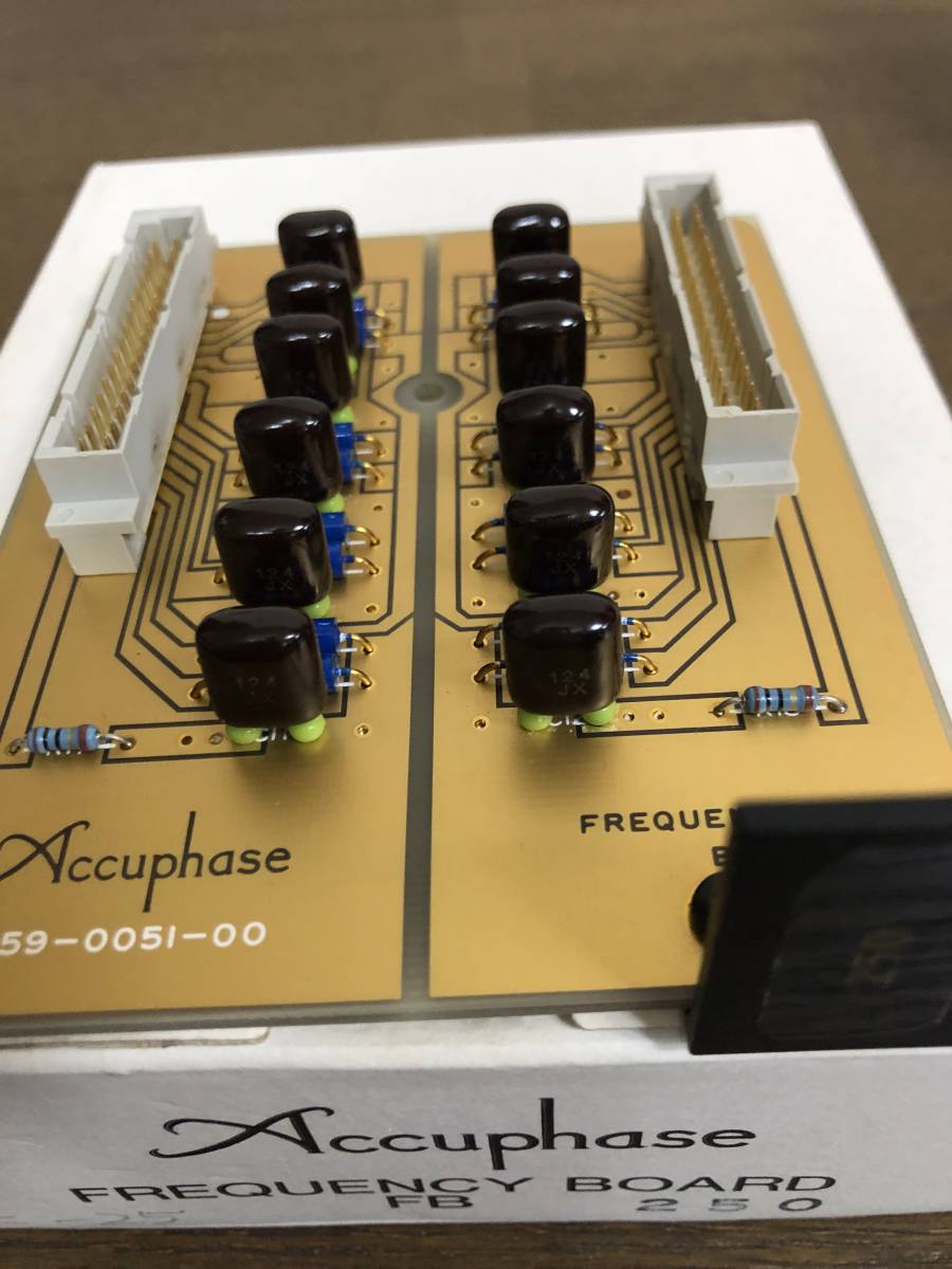

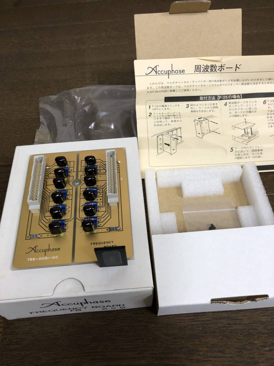

I'm looking for the value of the parts needed on the Accuphase frequency board being used in the F20/25 active crossovers.
Have a 180Hz card but need 250Hz (or 290Hz).

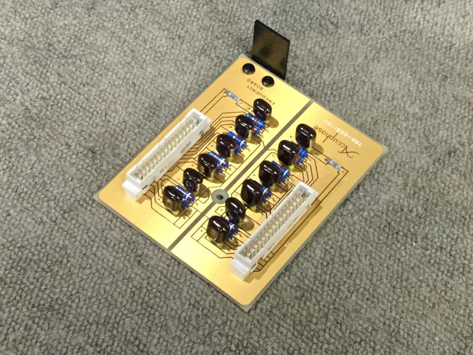

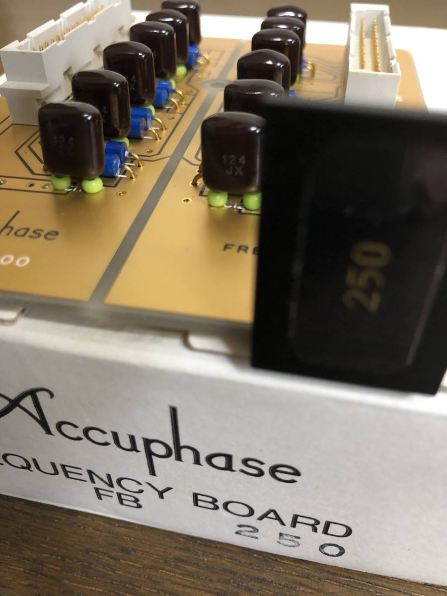

So far by looking at the pictures of the FB-250 card I found:
  • C1-C12 120nF (124)
  • R1-R8 19.6k 1%
  • R9-R10 12k 5%
  • R11-R12 960R 5%
  • R13-R14 36k 5%
  • R15-R16 68k 5%
This is of course by eye so not necessarily correct.
The PCB itself (115-0690-14) and R17-R18 look to be the same across different models.
Attached are a few pictures I of the FB250 I could find on the internet, on one I added the part number for the sake of convenience.

That's the best kept secret in audio industry.
Jokes aside, I doubt anyone has the schematics of the F-20/F-25 besides Accuphase themselves (which is probably why the cards are stupidly expensive). I know there are clones but I want to keep the original Riken/Amtrans through hole resistors and silver mica caps.
Without reverse engineering, there is no way to properly change the parts values or frequency,
unless someone has a board with those frequencies and can give you that information.
Some would say just scale the capacitors smaller, or the resistors smaller, but that won't necessarily be correct.
It's probably a case of reverse engineering or finding a mathematical formula, assuming Accuphase's filters aren't something unique.

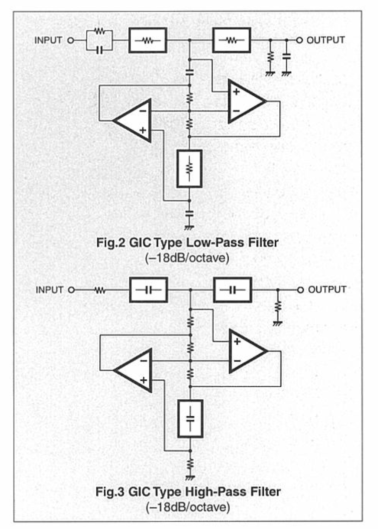

You have the unit itself, right, along with the frequency-setting board? And you know the order (selectable 12, 18, or 24dB/oct says the attached pdf) of the crossover, so don't you have what you need?
  • f-20en.pdf
    f-20en.pdf
The devil is in the fact that I need the capacitor and resistor values for the needed frequency to modify the card from 180 to 250Hz and the values are not publicly known, unless taken from picturers of a 250Hz card but it's still a bit of guesswork as you cannot clearly see the values of all capacitors.
Anyway, I bought a second F20 with the 290Hz (Altec/JBL) card.
I will gladly post the values and photos of the card when it arrives.
