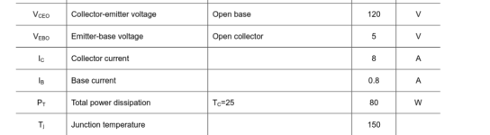

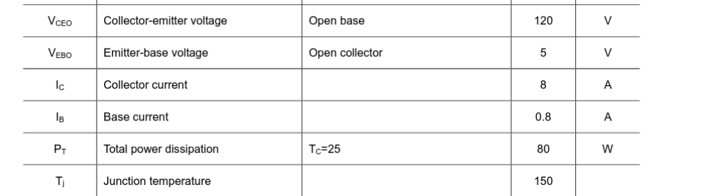

https://www.diyaudio.com/community/threads/transistor-dissipation-and-turbo-projects.234153/
C3181 in da Accu ,btw baby sitter silent fan is good in summer 😉
N. Pass again:
"The limits are generally the temperature of the junction,
which you can infer from the known wattage and the
temperature of the case.
Typically the limit is 150 deg C, and the thermal resistance
from junction to case is maybe 1 deg C/watt, so the limit
for a device with a case temperature at 100 deg C is
about 50 watts."
about 50 watts."
