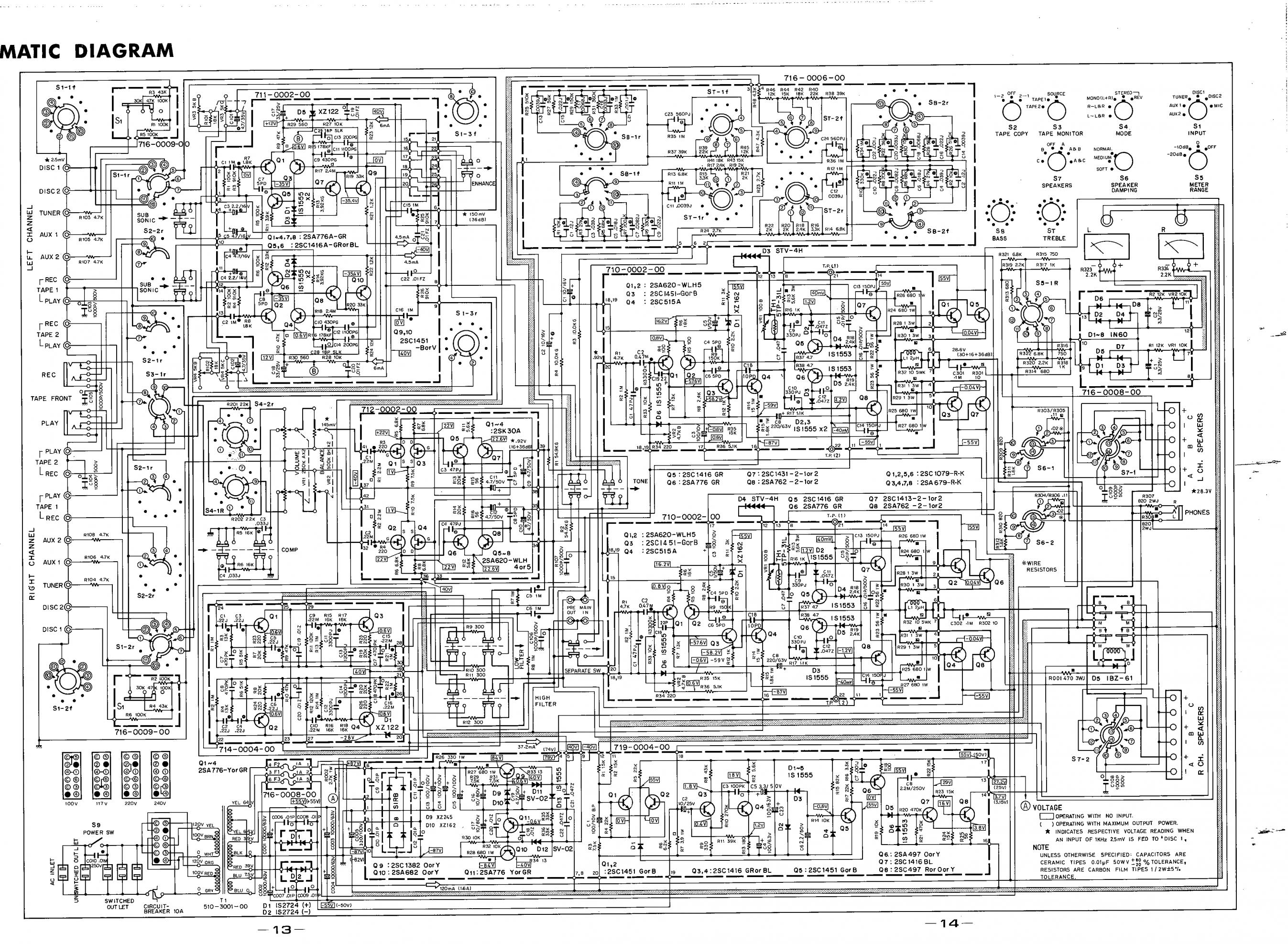

Hi folks,
Looking at relpacing the relay in my Accuphase e202, and was wondering if there was easy way to replace this with a dpdt relay such as the omron ly2, to me nothing jumps out immediately because of the way the relay circuit works and the low impedence wires, but maybe someone has an idea?
