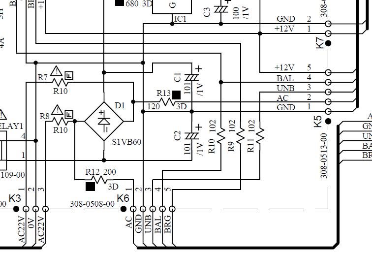

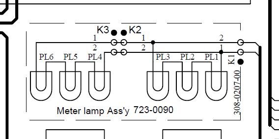

Ok, measured 18.9VAC on the lamp rail, considering the lamps are in series by 3, that would mean they are 6-6.3V parts.

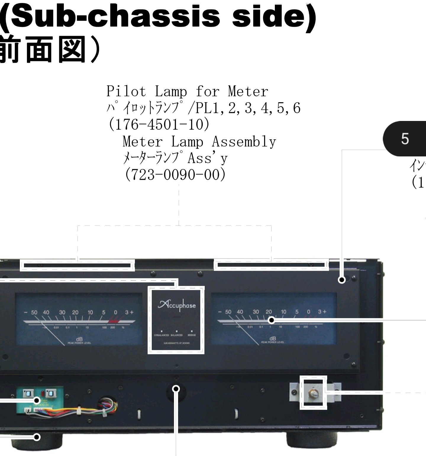

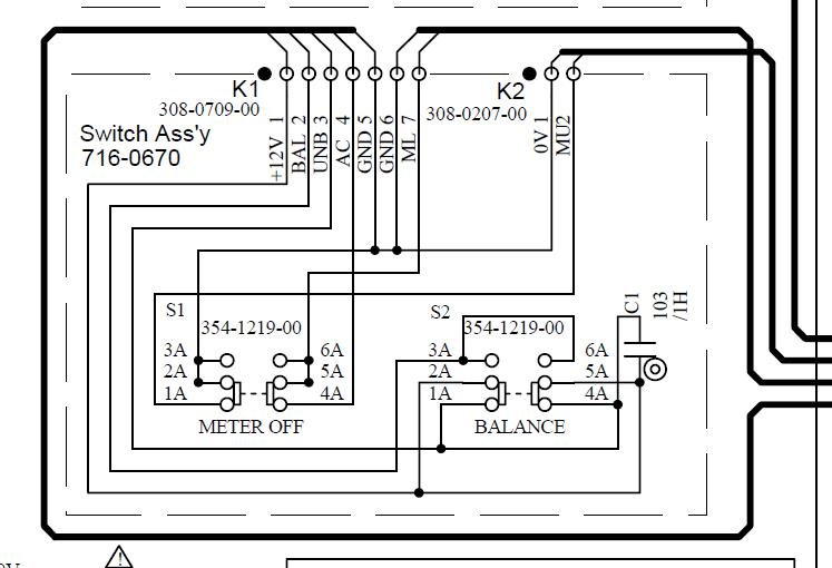

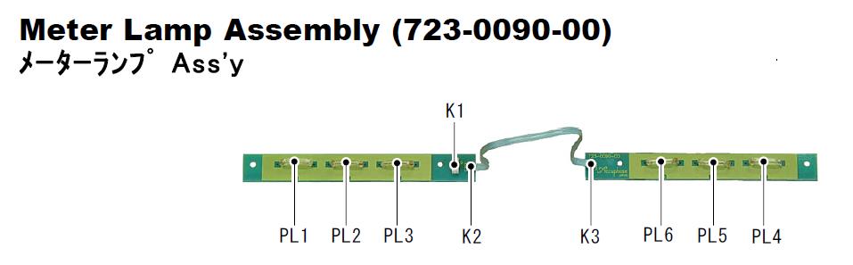

According to the service manual (from Hifiengine) these lamps are axial bulbs soldered to a board.
There are two bulb blocks (3 bulbs in sequence) in parallel (one block per meter) fed from AC 22V via 120R resistor.
Some photos of the particular amp would be of help.
