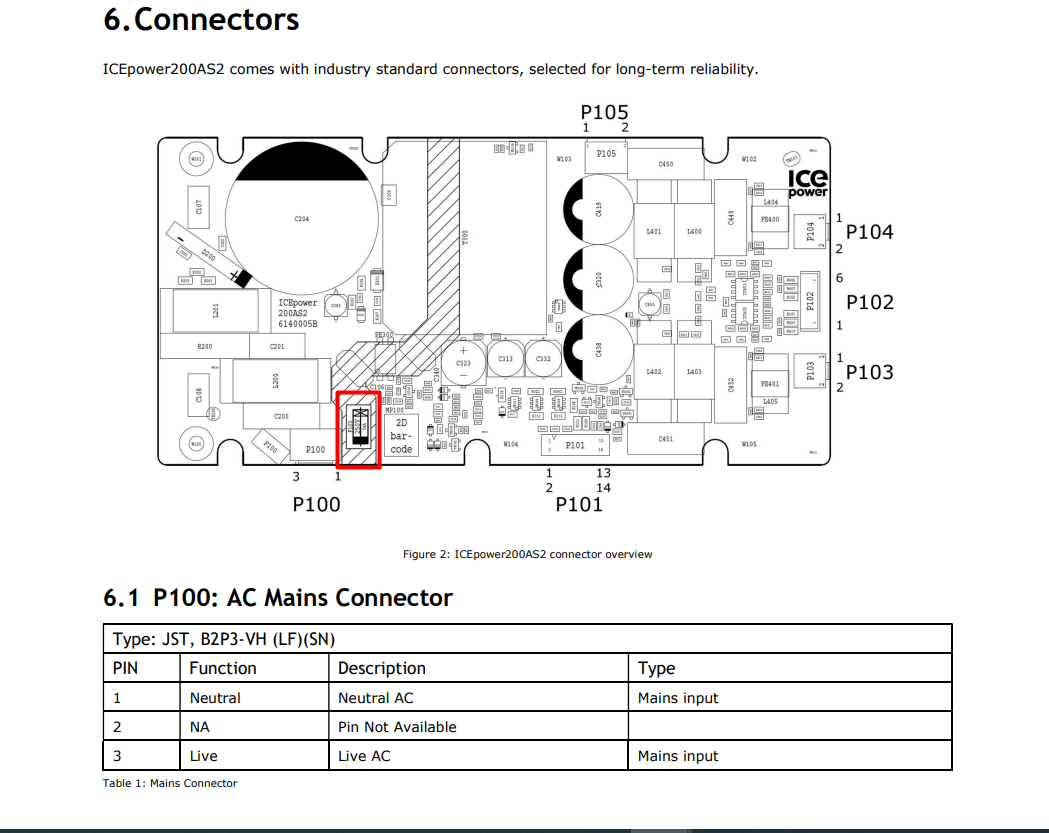

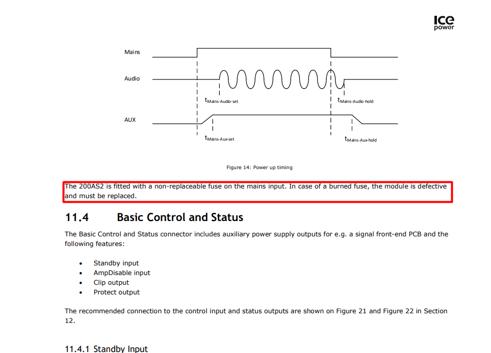

Yeah there is non-replaceable fuse on the board, measure if it is open. If I'm not mistaken its the one marked in the attachment.
I've got the same amplifiers, but haven't had problems with them so haven't looked further to it than recalling from memory and outlining the info on the manual to the attachments.

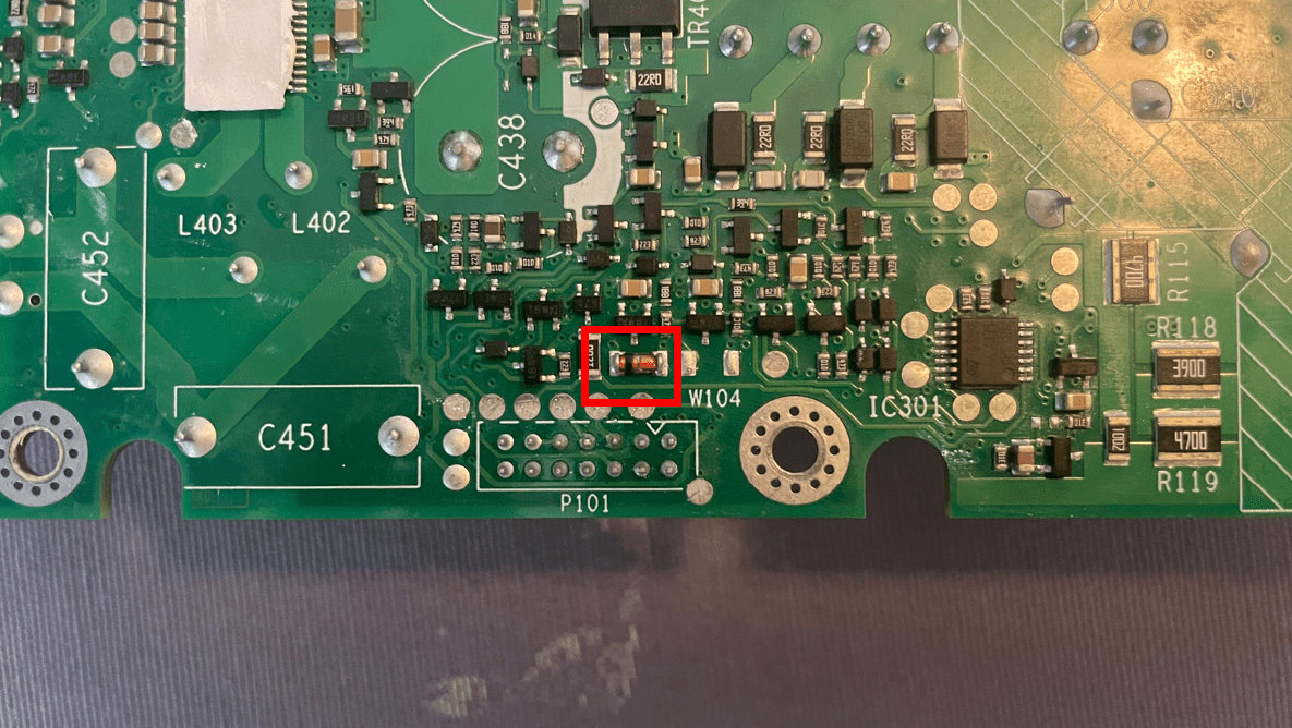

So I sat down with the board again, trying to figure out what might be wrong. I unscrewed the backplate to get a look at the underside of the board. I then stumbled upon a component, which I can't figure out what is. I measured a resistance of about 3M ohms with the red probe on the right and the black probe on the left, which is also the only way the the continuity test shows anything. I also figured that the left side of the component is connected to the aux-GND, while there is nothing happening if I have one probe on aux-GND and another of the right side of the component (see image, boxed in red and looks like a red tube).
^^ Hi, did you happen to remove the thermal pad on the amp chip while you had the back plate off?
I've seen hints it should be the TPA3255 chip but cannot find the info from official documentation.

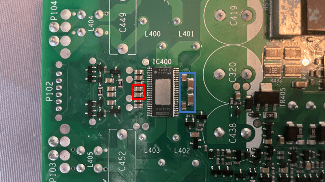

I removed the thermal pad to discover, as Nisbeth wrote, a TPA3255. I haven't been able to locate the problem yet, however I tried measuring the capacitors mounted right next to the TPA3255 and discovered something, which doesn't make much sense in my brain (but I am also quite new in this field, so not everything does).
(See the image for reference). The top capacitor inside the red box had a capacitance higher than what my multimeter could measure (which is somewhere above 100μF). I had read online, that if a capacitor measures 0 in resistance it is dead, which I then tried. The display on my multimeter then showed me 2,2Ω, which made me think that might be the problem. Most of the other capacitors on the board where measured in millions of Ω. The bottom capacitor in the red box measured around 1,4kΩ and 0,8μF so I believe that to be fine. The capacitors in the blue box are too "large" for me to measure, but when I tried to measure their resistance, they where also low, like the bottom capacitor in the red box, but still way better than the first capacitor I described. I know the measurements in resistance aren't that useful in terms of application, but as I understood, they can be used to know if a capacitor might be toast. I have thought if trying to replace the capacitor, but since I can't measure its capacitance, it is going to be very hard for me to know exactly what to replace it with. With my limited knowledge and experience I find it difficult to confidently conclude that the top capacitor in the red box is the problem.

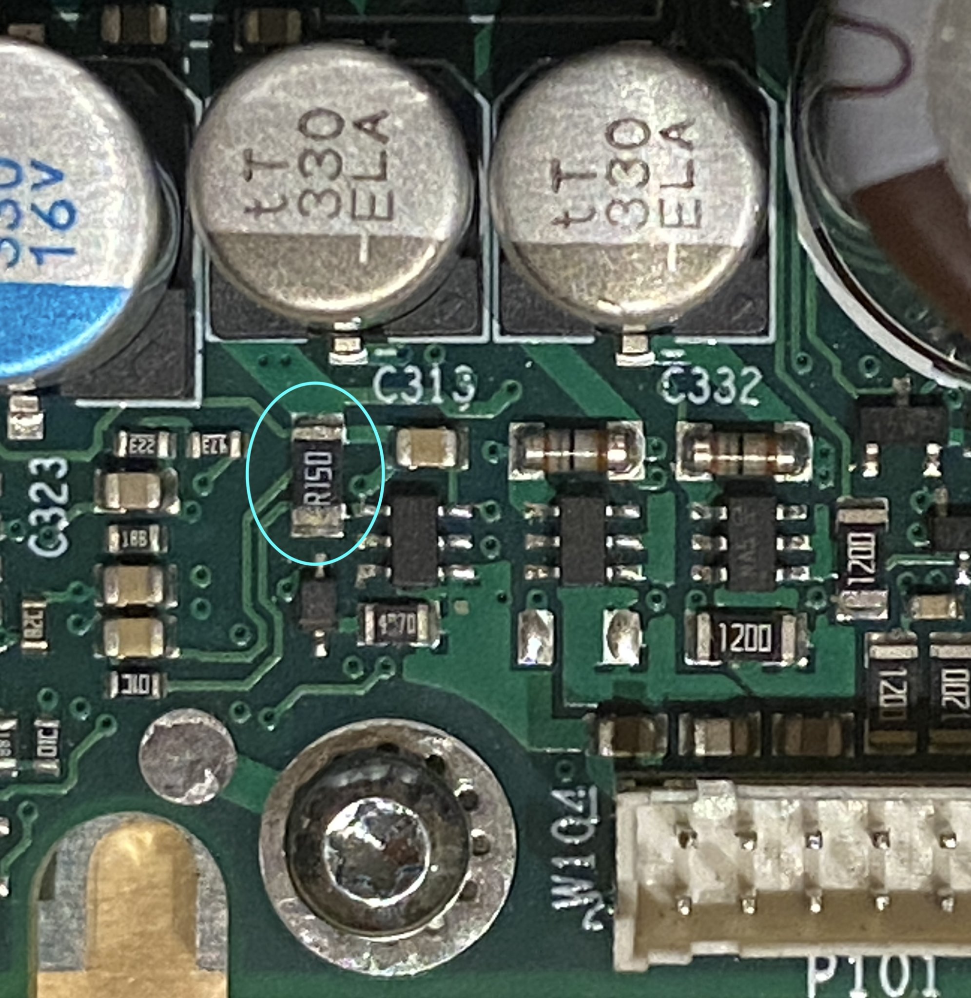

Maybe this comes way too late, but bumped on this thread when I looked solution to same issue: made the same mistake, actually few times.
Anyways, here's how I solved this:
The DVDD feed has current limiting resistor of 0.15ohm located close to P101 connector. This resistor (marked R150) just burns open and basically cuts off the supply feed of circuitry for power on, stand by etc. Replacing this resistor solved the problem on few IcePowers I worked with. (AVDD and AVSS seems to have similar kind of circuitry, in case the short happens either of these outputs so same idea may apply.)
While this may not be the solution for all cases, figured to post this solution for future readers of this thread as one option to look for.
