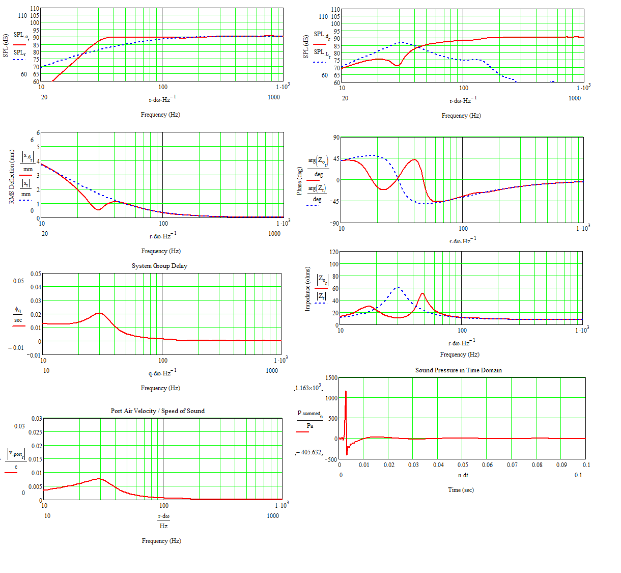

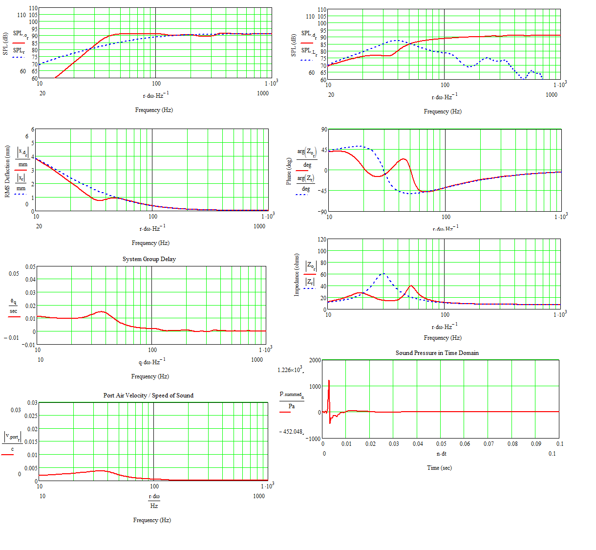

Metronome-inspired design for TC9FD
Despite admonitions by Scottmoose against making a Met-like design with the Vifa TC9FD as being unsuitable for resonant enclosures. I proceeded nonetheless.
In WinISD, I pretty much used very close to the default BR box volume and tuning it recommended which was 16.9 liters and 56.4 Hz. I played a little with the tuning to get 17.2 liters and 55 Hz with a 2 in dia vent that is 3.07 in long.
I have made a MLTL for this driver at 40 in long before so I will stick with that for the pipe length, also it is a reasonable height for the driver once I elevate the bottom with some feet to allow the bass port to exit.
So how to design the rectangular obelisk sizes? Based on purely practical reasons for easy building, I set the top to be 1 in x 3 in, I then set the dimension of one of the bottom side edge to be 6 in to give enough stability to the speaker and clearance for the driver magnet.
Using the formula for the volume of prism with unequal top and bottom faces (which we recently discussed in another thread) given by Vol = (Area_top + Area_bottom)/2 x height, I solved for the remaining edge so that the Vol = 17.2 liters.
17.2 liters = 1050 cu in = (1 x 3 + Edge x 6)/2 x 40, solve for Edge
Edge = 8.25 in.
So I now have a design that looks somewhat Met-like as an obelisk.
Base is 8.25 in wide x 6 in deep
Top is 3 in wide x 1 in deep
Length is 40 in
Vent is 2 in dia x 3.07 in long.
Driver is 13.3 in from top.
Stuffing will be in top 26 in, remaining volume to leave empty.
I wonder how this will sound? Given that it is longer than 30 in, I will have to join foam core sheets to get the extra length. This may require facing with a thin 1/4 inch plywood to make it look good.

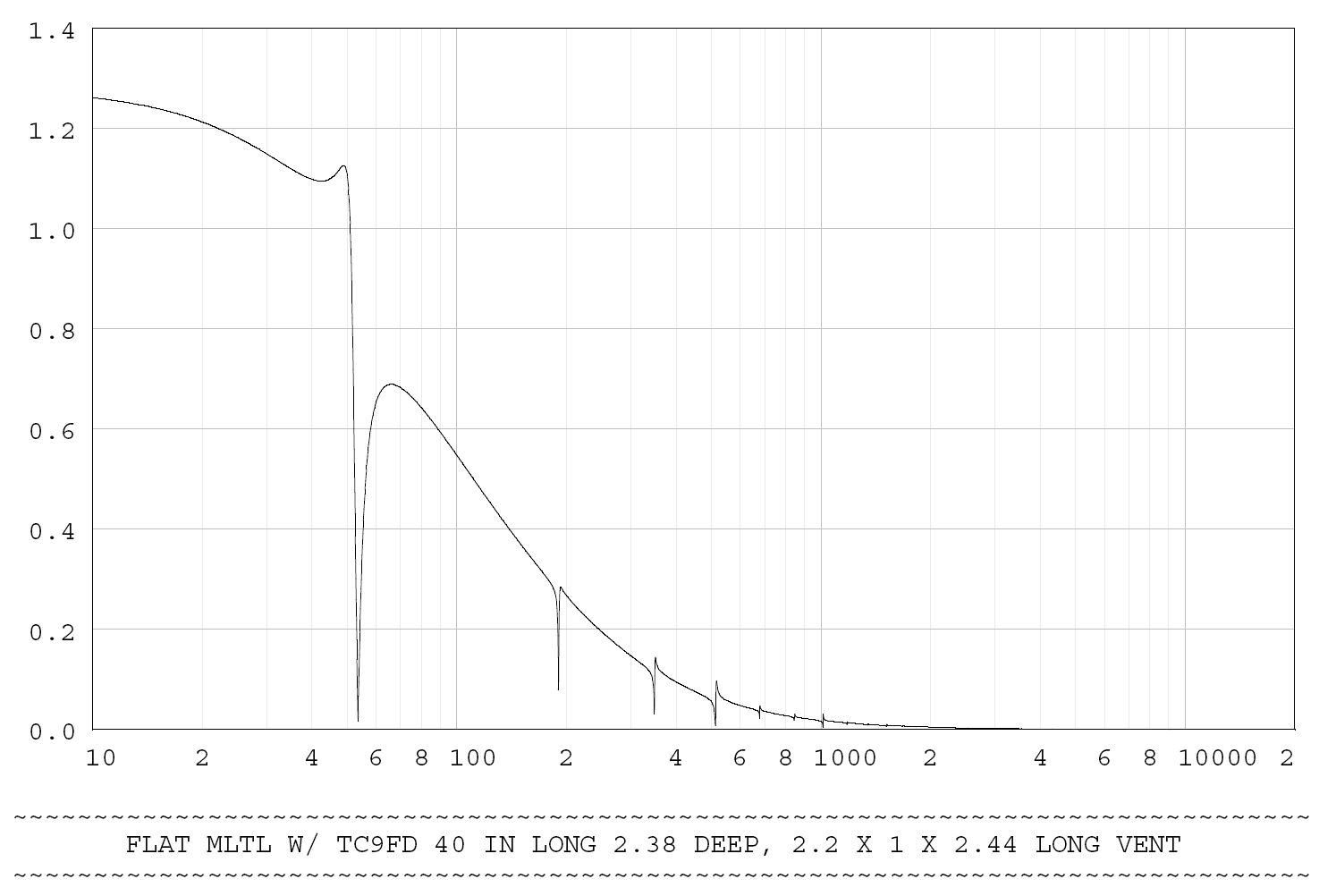

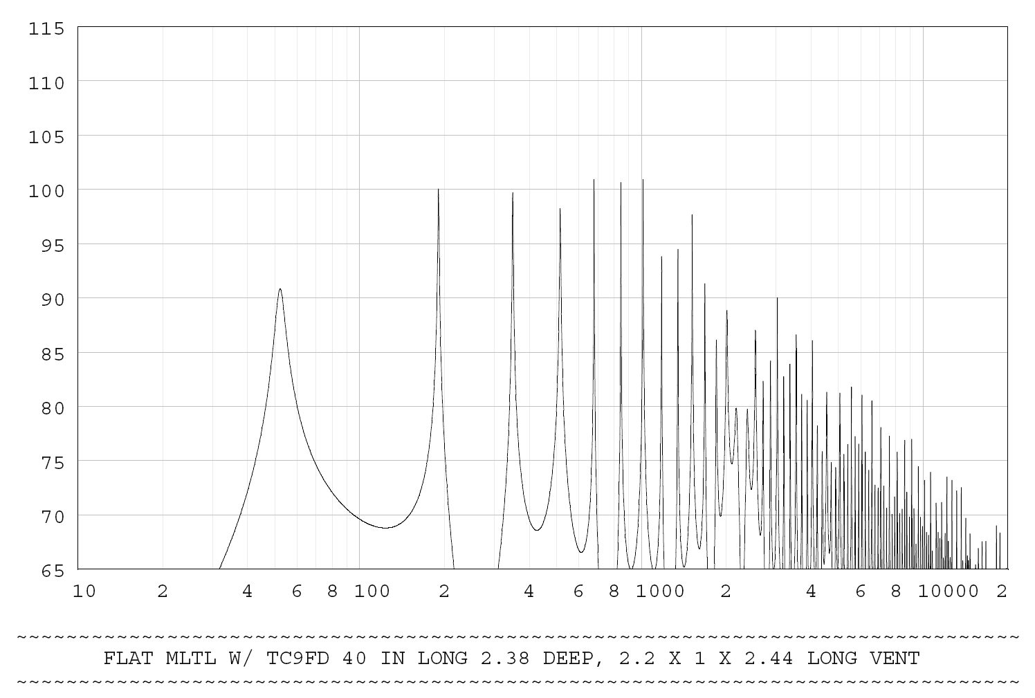

Actually, the HornResp simulations for the Vifa with the Flat MLTL shows a driver diaphragm maximum displacement of only 1.2 mm at 52 Hz (xmax is listed as 2.5 mm by manufacturer). And it levels off rather than getting higher and higher with lower freq.
...and now think of the sound pressure levels obtained, and how much dynamic range you'll have available. 😉 You might be happy with that -fair enough. Me, I think it sounds like a portable radio. Been there, done that, decided it was rubbish. I'd rather do without the LF output & have lower distortion levels throughout as a result.
I agree that the bass is limited in SPL but given that the Vifa is a 85 dB efficiency driver and HornResp predicts 90+ dB for the bass, not too bad and rather balanced from what I hear. Definitely sounds way better than any portable radio I have heard - some of it might be fact that it is wall mounted so bass is enhanced.
That is the peak that HR shows at 52 Hz. I did not use HR to tune but rather to see what the result of the AMLTL looks like. Of course there is no stuffing which once you account for it, it will smear and lower everything in amplitude. But the sound is definitely not missing the bass.
