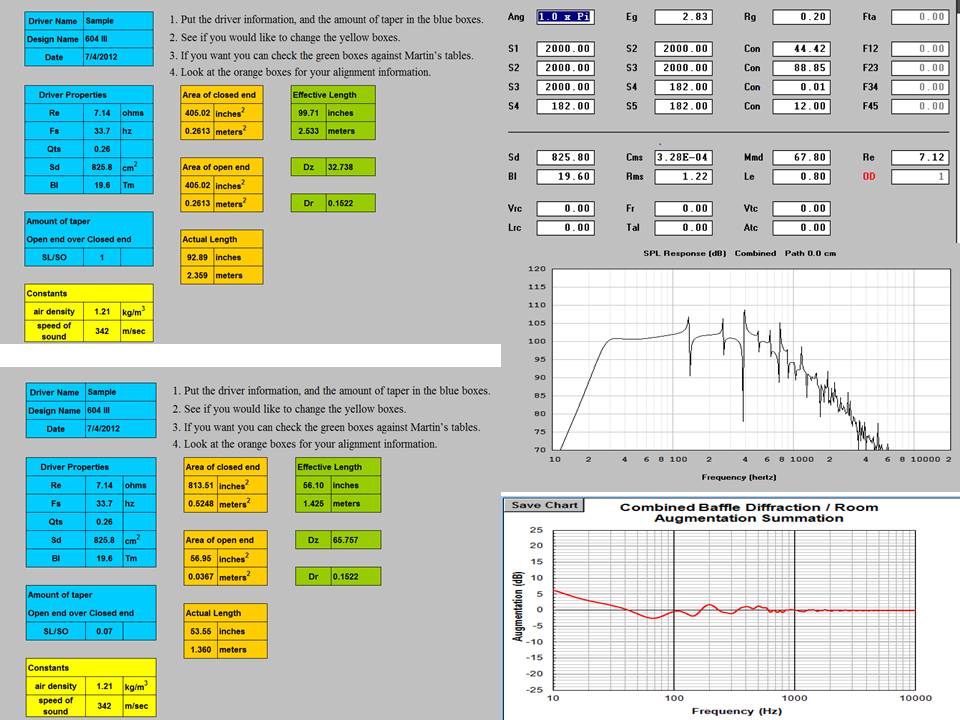

You will find these programs useful if you are interested in experimenting with MLTL alignments using just free software.
Transmission Line Alignment Tables Spreadsheet by Keith Web on
Transmission Line Theory
Hornresp Plots MLTL SPL response without stuffing effects.
Akabak .. does it all pretty well. Hornresp design data can be exported to Akabak.
ROUGH:
1) use Keith Webb's Excel spread to enter your speakers T/S parameters and use a SL/SO taper=1 to get the Tline cross section area. This area can be entered into Hornresp for a good quality MLTL simulation
2) use Keith Webb's Excel spread to enter your speakers T/S parameters and use a SL/SO taper= 0.05 to 0.1 to mimic the bottom MLTL port area to get the MLTL total height. This height can be entered into Hornresp for a good quality MLTL simulation. These good estimated help you tune a Hornresp design.
3) After studying MLK's MLTL website information you can decide on where to position the speaker and port. The diameter of the speaker also affects the offset distance. You do not want to put a 16" Altec 604 very close to the top. Locating the speaker center in the TL length 0.20x to 0.33x from the top is a good start. A 0.33x spacing removes many harmonics.
4) You can export the Hornresp design data into Akabak and fine tune the port position and the stuffing.
5) DO NOT FORGET ROOM EFFECTs. Many MLTL's depend upon rear wall or corner effects to get the best in-room performance.
Download the free
Baffle Edge Diffraction Simulator Ver 1.2 by Jeff Bagby
"Diffraction & Boundary Simulator 1.20"

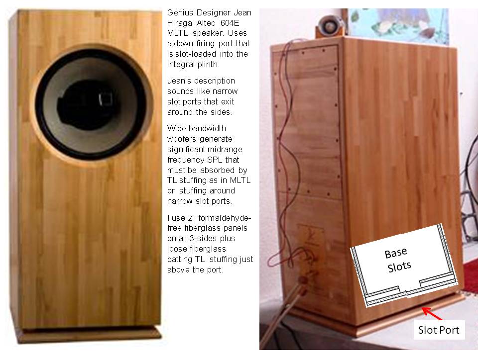

6) There are genius designers that blend quarter wave TL tuning with clever BR stuffing and port design.
Line Source,
Yes, I am aware of these resources and I also use Akabak. The point of my thread is that it doesn't matter, all you need to do is design for a bass reflex alignment tuned lower than you normally would (no more than 75% of fs) and build the bass reflex box in a long aspect ratio between 30 to 45 inches depending on fs. Set your length and baffle width and the volume gives the depth and the bass reflex program also gives the vent dimensions. Magically, maybe luck, it ends up close to what MJK optimization might produce.
