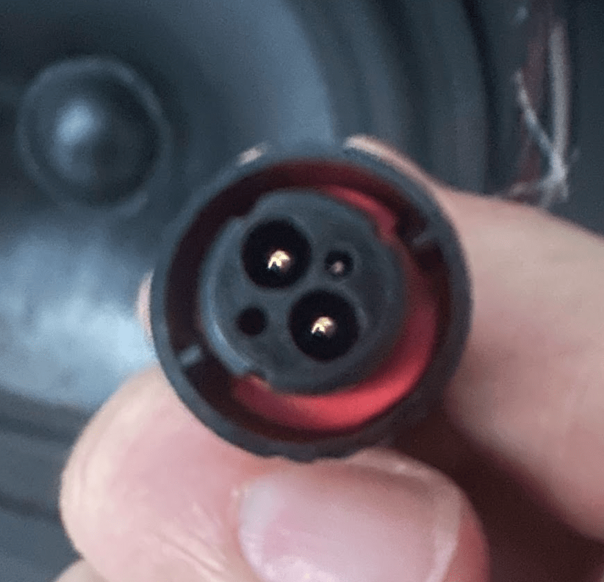

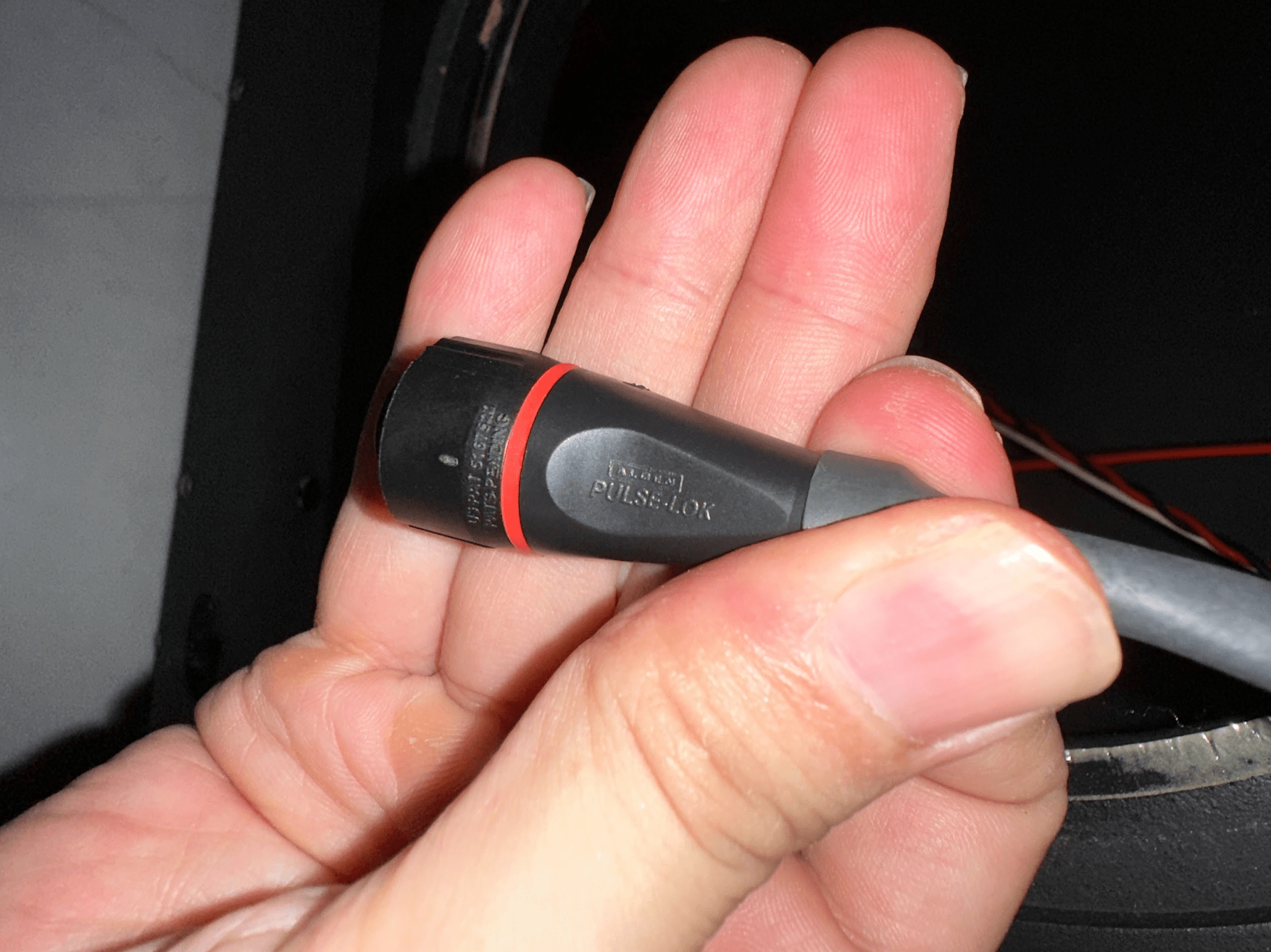

Is it possible to open up the Pulse-Lok panel connector of a ML Prodigy to access the 3 wires without cutting the cable up? I need to test bypassing the connector but since it's just a test I hope I can do it in a reversible way.
Looks like this one with the Press & Seal backshell. Looks like there's heat shrink over the backshell's end (maybe the whole assembly?), but your fingers are in the way.

Wow thanks for finding that info. But it doesn’t mention how to disassemble it to remove the wires. Anyone has any ideas?
Yes there is heat shrink over part of the wires and connector. I can cut the heat shrink but I don’t want to cut the cable if possible.
If it snaps on, I assume it snaps off also. You'll have to make enough clearance for it to slide down the cable though, which will involve removing a couple inches of heat shrink.

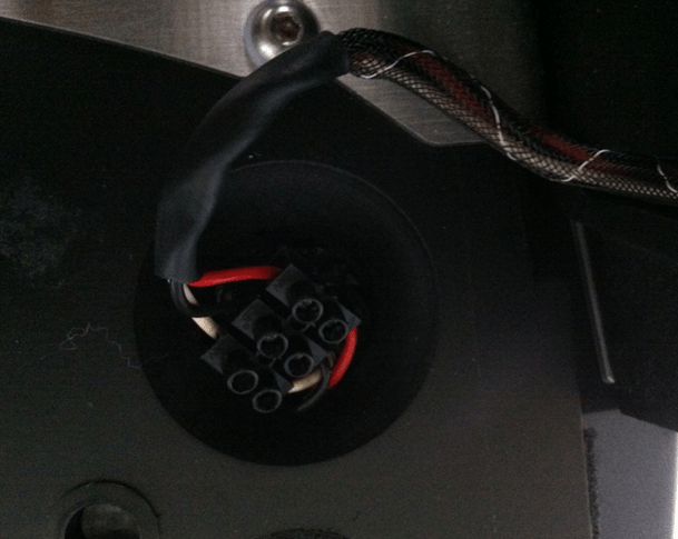

What do you mean take the pins out of the connector? I want to be able to access the individual wires so I can do this:
This pic is from ML and it is their recommended fix if the connector is defective since that particular connector ML uses for the Prodigy is no longer available or made.

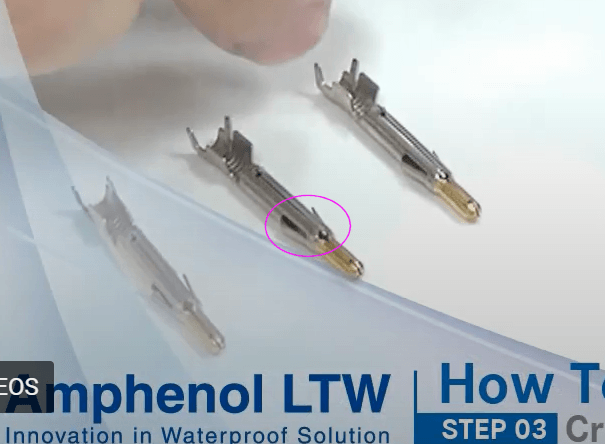

I assumed you were just trying to get more direct access to the wire/pin connections and you intended to be able to use the Pulse-Lok connector again. To do that, you would extract the pins, and then re-insert them later. Or put new pins on and re-use the body.
This is a different connector, but assembly is likely similar for the pins/body.
Great! Thanks for finding that video!
So I'll cut the heat shrink and hopefully be able to unscrew the Pulse-lok connector and the pins should come out.
FYI I didn't know the wires have pins attached to them, hence I was confused!

If your backshell is the snap-on version, it won't be threaded (not that twisting the back should bother anything as long as you don't twist up the wires). A bending/pulling motion is more likely to work for a snap-on back.

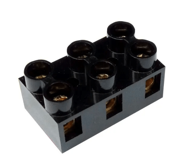

Thanks for all the info! For a test, could I just insert the pins directly into a terminal block like this without removing the pins? Would it provide a good enough contact?
(Original post below)
Probably, as long as the connection between the pin and wire's conductor is still good. It's quick, so worth a try. Try not to deform the pins if you want to use them again though. For short-term tests, even alligator style test leads are OK. I've used them countless times on electrostatics. Just keep them separated and don't get creative with trying to make connections while things are powered. The high voltage audio signal does unpleasant things to us puny humans - some of which are deadly.
There's normally a strain relief built into the pin as well, so it can be a little hard to tell what's what at times. You can see that in the crimping video: the rear portion of the pin's crimp grabs onto the insulation. The front part is on the conductor.
Yours may be soldered also. That was one of the options in the datasheet.
