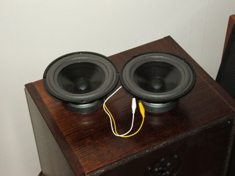

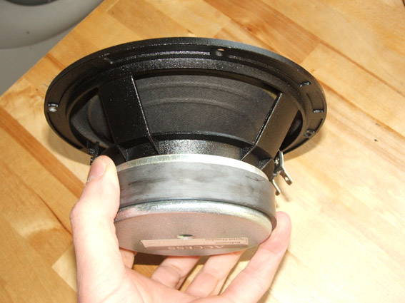

Waddayaknow, they're here allready! 🙂
Great service from Zalytron!
And as promised, pictures taken.
The drivers look very good in deed, not oozing exotica or exuberant perfectionism, but nothing to put the finger down on really.
Magnets are big and beefy, and the suspension seems highly compliant, so hopefully these drivers will meet my expectations of transient response nirvana! 😀
The diaphragm and suspension looks and feels almost delicate ,so this is definitively no cheapo far eastern drivers (no offense intended to you guys from that corner of the world!!) with diaphragms stamped from heavy gauge shipping cardboard and wrung bicycle tires for suspension!
The coating is not of the sticky kind, which means I wont get furry midranges if I forget to vacuum clean.
And the label says "Made in France"... 😉
In short, build wise, they look like very good value for money..
In a minute I'm gonna hook them up and see if they actually make any sound as well! 😀

Yeah.. the one pic per post thing is a bit annoying sometimes. Thanks for posting those pics tho! Nice description too. Helps a lot.
Any idea about size of the voice coil? What about xmax? Could be one of those mids with 1mm or less, although I doubt it.. but they don't give a spec, if I remember correctly. I have to say, I don't think they appear to be quite what I had expected. Not really in a bad way. Just different. Although I wasn't really expecting foam. Not always really a bad thing though. Do the cones not seem as light as the specs from Zalytron indicate? You said that the suspension seems highly compliant, but then you said something about it having bicycle tires for suspension. Is it hard or soft? Does the cone move easily? Strangely, that foam actually looks kinda heavy. The largish motors aren't surprising I guess, given the low Qts of these drivers. Very interesting indeed..

If the surround appears yet untreated I would apply some anti-UV treatement.
Well, hope the description is helpfull, must say i find it strange that Zalytron doesn't have more info an pic's of these drivers on their web-page, that would certainly draw better attention to what I find to be a most saleable product!
The surround is really light and delicate, wrung bicycle tires is exactly what it isn't! 😀 Sorry if I phrased my self a bit clumsily there...
As I said, very light and compliant surround and the diaphragm is probably as light as the 6 and something grams quoted. The diaphragm moves very easily as well. Combined with the beefy magnet, this should give interesting results! from the data posted on Zalytron, the coul height is 12,4mm and the gap is 6mm high, so that shoud give a linear Xmax of about +/-3 mm which I think should be quite ok for a midrange of this size and frequency range.
I would estimate the VC diameter to be 22-26mm 'ish in diameter.
The only issue i have is the basket, it gives a clear "ding" when you tapp it, not as dead as more robust baskets made from aluminium or magnesium. But this should be a minor thing to fix, just put some bitumene strips on.
