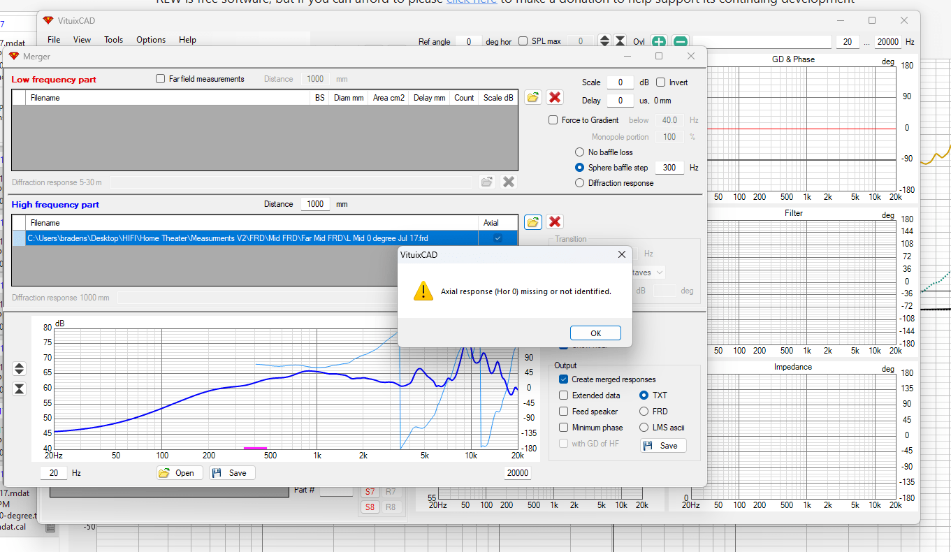

These are looking like more accurate measurements. You have some challenges ahead with the tweeter response. What microphone are you using and does it have a calibration file?
2 things:
1) Make sure that you have the calibration file for the microphone. I believe that all of the UMIK mic's come with one and it's very important that you have this correct. I had massive problems above 2KHz with my old Behringer mic because I didn't have the calibration. I had a lot of excess magnitutude. Once I switched to an Earthworks with a calibration file all of my measurements were much better and I had to fix some old crossovers.
2)I don't use Vltuix but it looks to me that it needs to know where your microphone is pointed on the horizontal plane. When you're taking your measurements, you normally want the microphone to be pointed at the middle of the tweeter from 1 meter out. Measure the mid-range and the tweeter from this spot so that the crossover is designed to sum properly there (although some designs have it sum at the mid-range axis but you should have it sum directly on axis of where you will listen). Then you can take horizontal measurements off-axis. I think Vltuix wants to know where you are on the horizontal plane so it can help calculate the crossover. You'll have to find where to put this in the program. You are at 0 degrees if you're directly on-axis.

I have the calibration file for the mic uploaded
I am using VItuixCad because it has the baffle simulation baked in
I did place my mid exactly horizontal as I used the 0 degree cal file. I used levels to get it perfect.
I used a turn table to get all the degrees of measurment from 0-90. I made that a couple weeks ago.

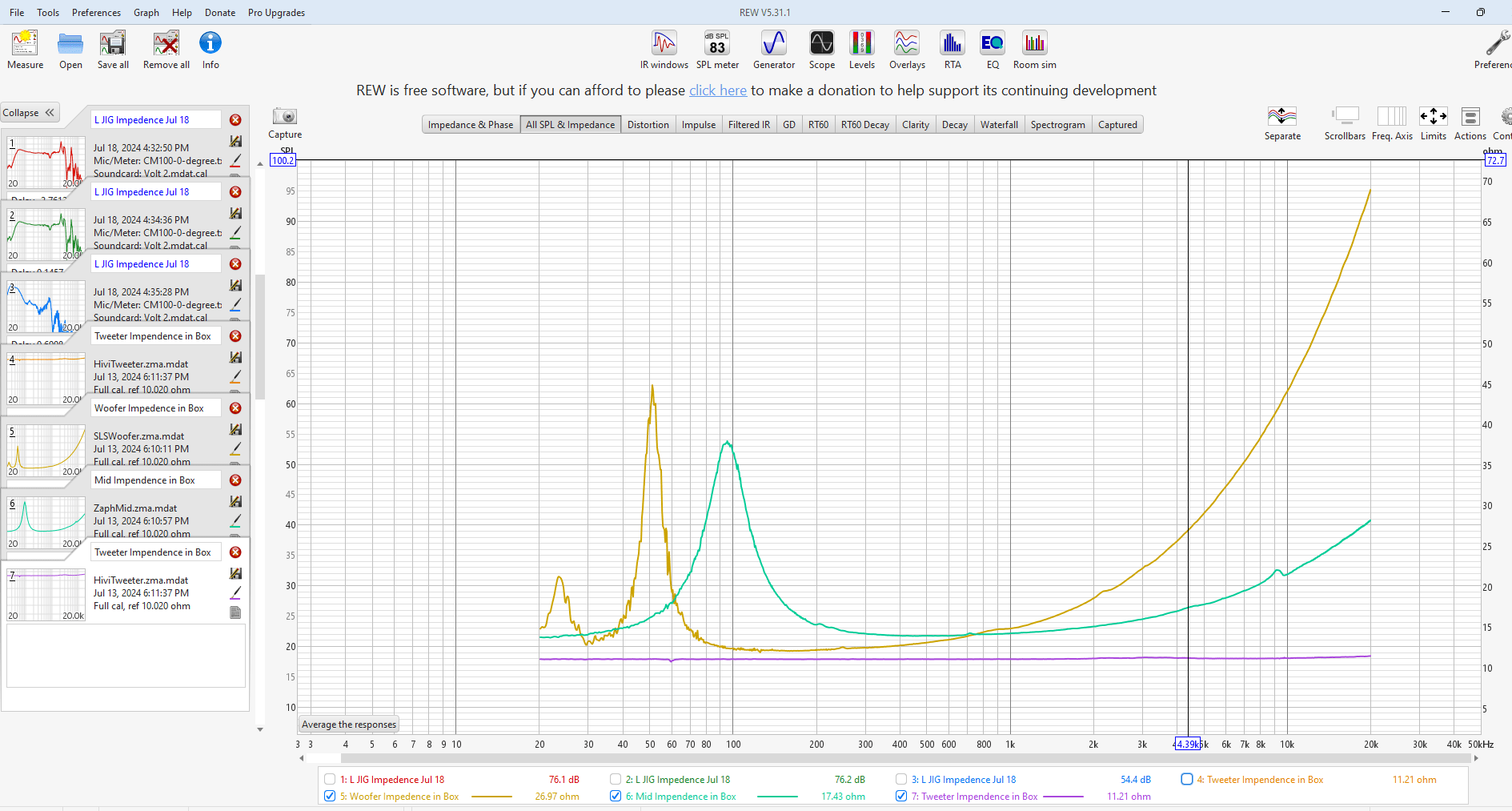

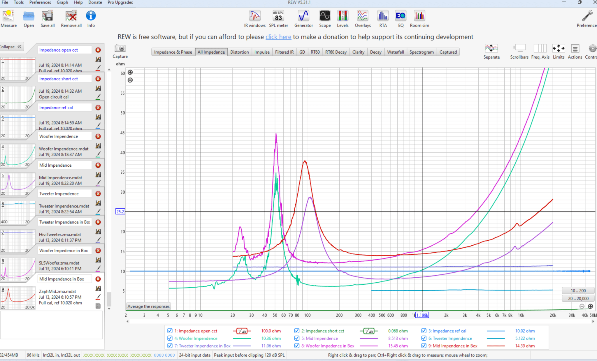

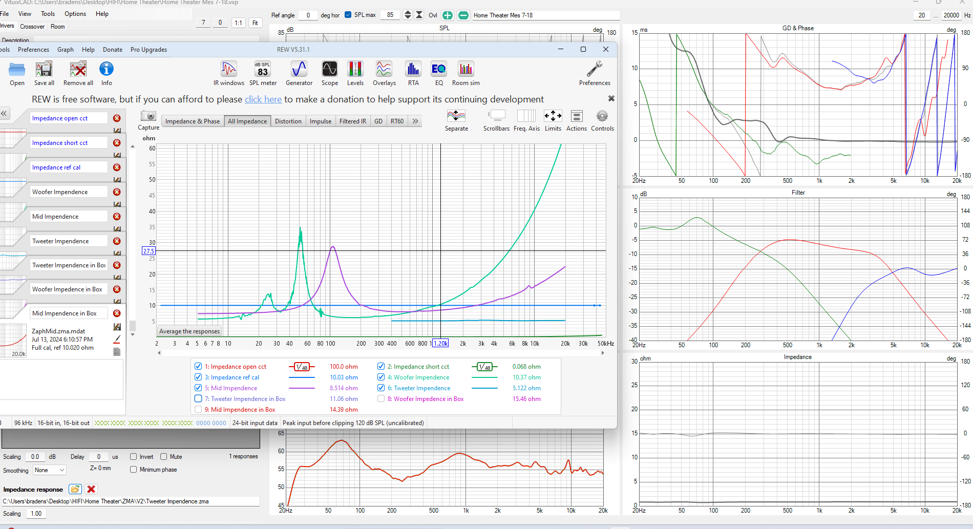

Try a known value resistor as verifying test!but its way higher
Also make sure the input levels are equal (via level meter) if no load is connected.
And of course check all connections for bad contacts (i had strangely varying impedance results for that reason!)
