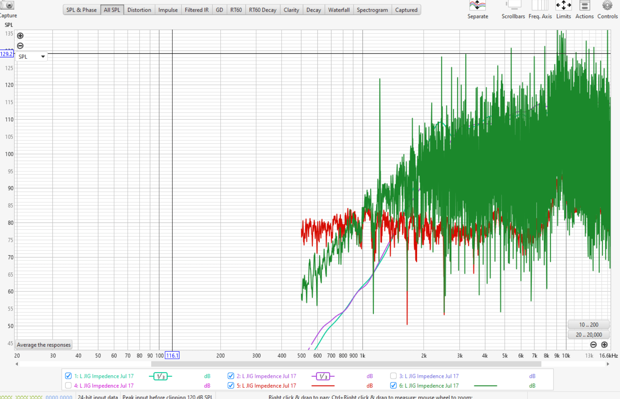

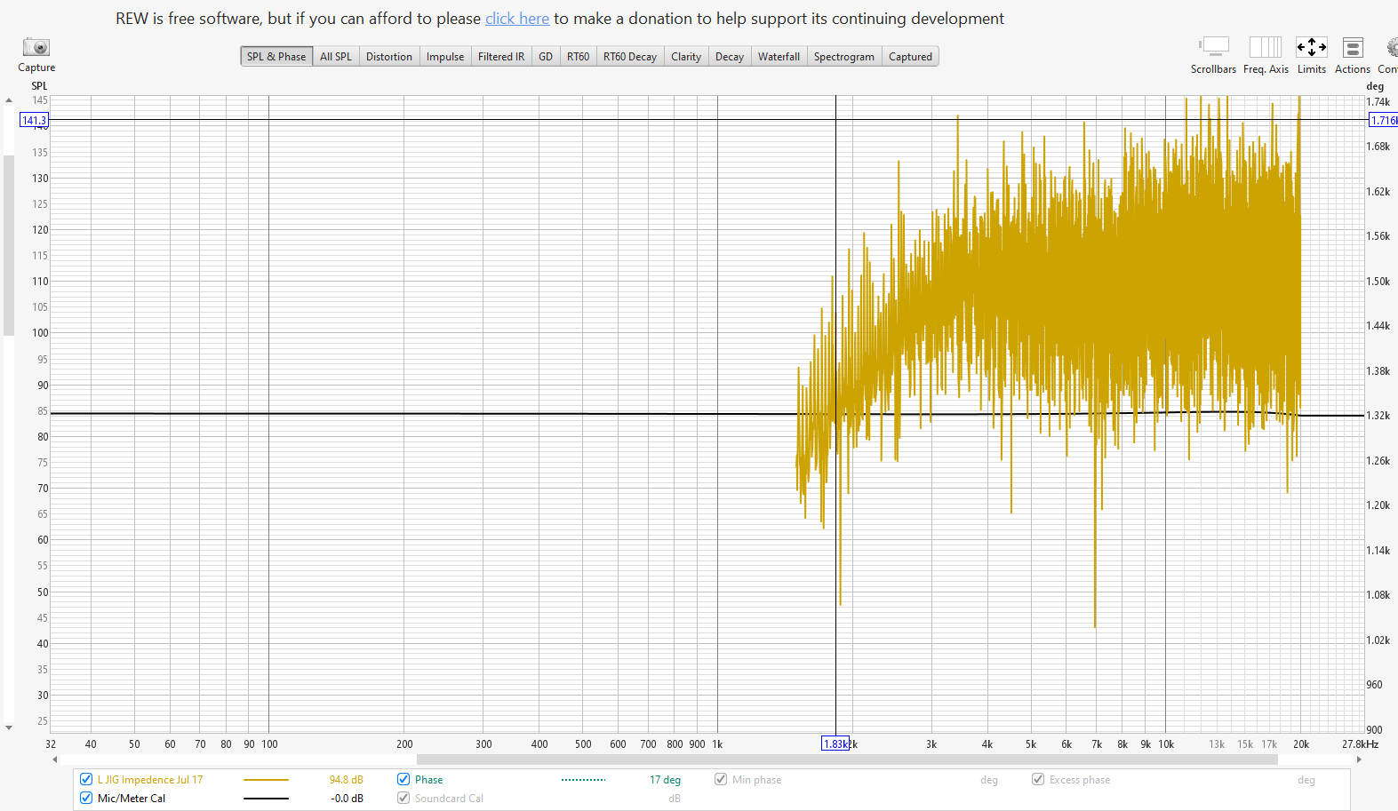

What do you consider normal variation in response?

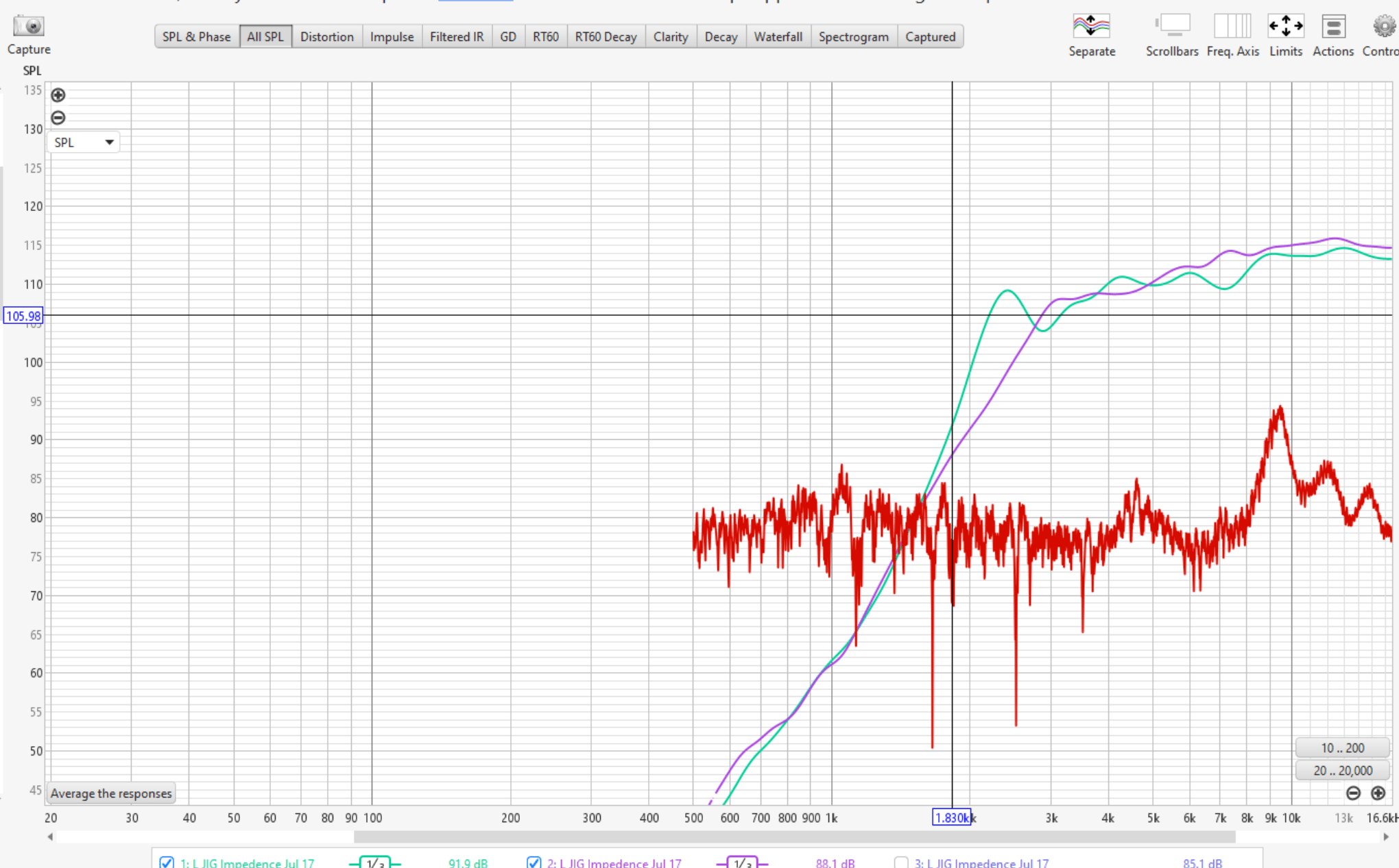

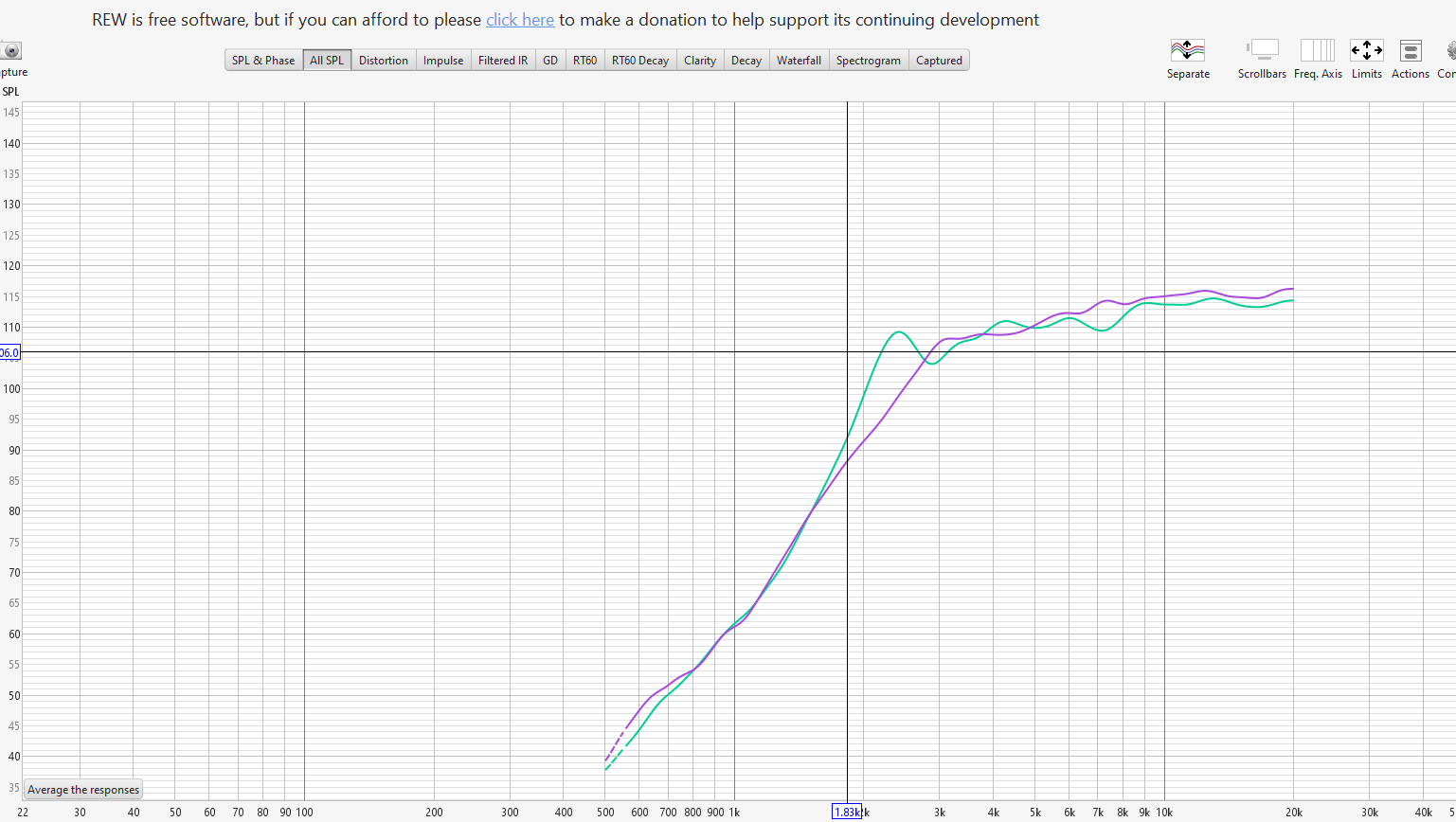

I have here two HIVI iso tweeters. These measurements were taken back to back in the same enclosure with not changed except I swapped out the tweeter in the cabinet.
Is this considered normal? Is this too far off from one another?

Your SPL still seems a little high (but not as high as before, so you did move in the right direction from a microphone limit standpoint). What was the microphone to speaker distance, and is your dB scale correct? A typical high level test is 96 dB at 1 meter. Back your microphone up to 1 meter and check the level to see if you are pushing the drivers hard (or check it with a handheld SPL meter to confirm).

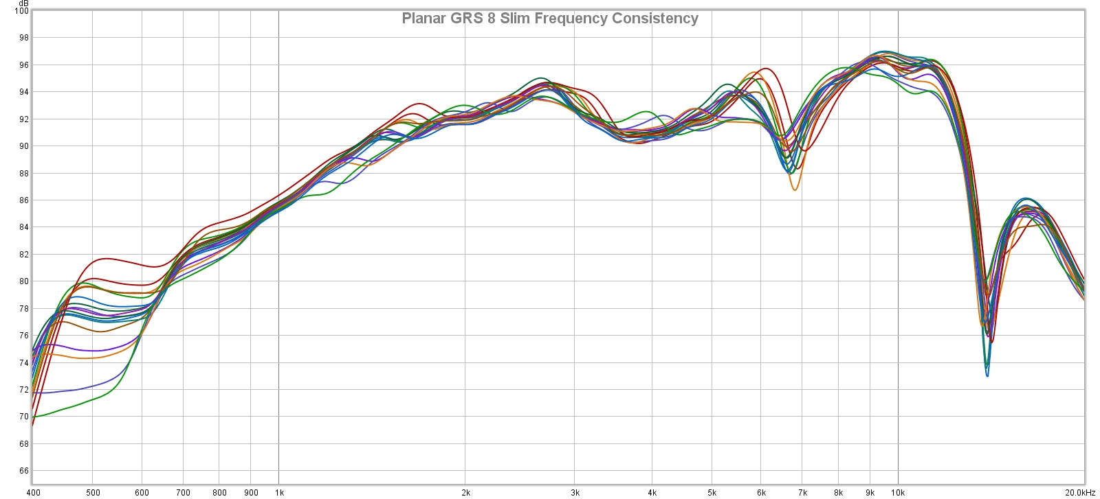

@OllBoll's test of 17 planar drivers
https://www.diyaudio.com/community/threads/new-planar-drivers-at-parts-express.360339/post-6523979

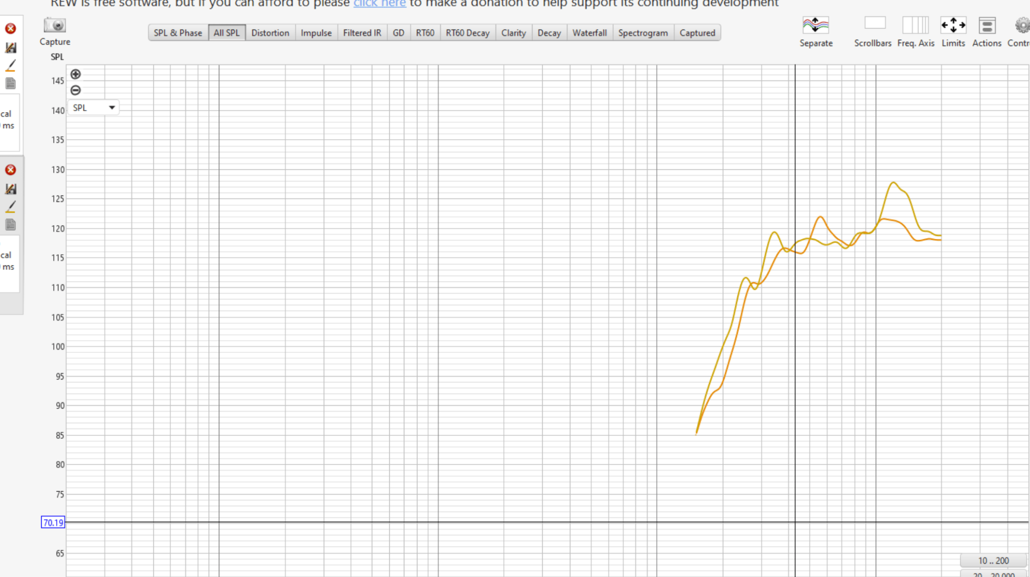

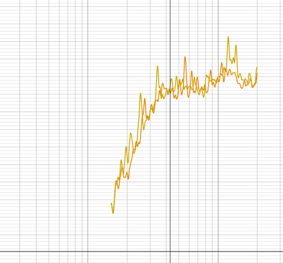

Mic is at 1 meter. He is me taking the same measurement of the same driver twice in a row.

I’m inclined to say the damping of the foil of the one with the highest output above 10k isn’t sufficient. That is the (one) issue with these constructions as Philips and Technics could have witnessed (and they mastered it reasonably well decades ago…).
I'd expect pretty much +/- 0.2dB accuracy between identical measurement sweeps. Even closer.
First we need to remove the noise from your sweeps. Are you measuring in a quiet location? (any background HVAC or other racket?)
Your gate markers are hard to see. What is your environment? In a typical 8' room - putting the DUT midway between floor / ceiling - you're looking at a gate of around 4msec (i.e. 1000/4 = no lower than 250Hz resolution).
Can we see your impulse window in % Y scale - with horizontal range of -0.5 to 8 msec?
