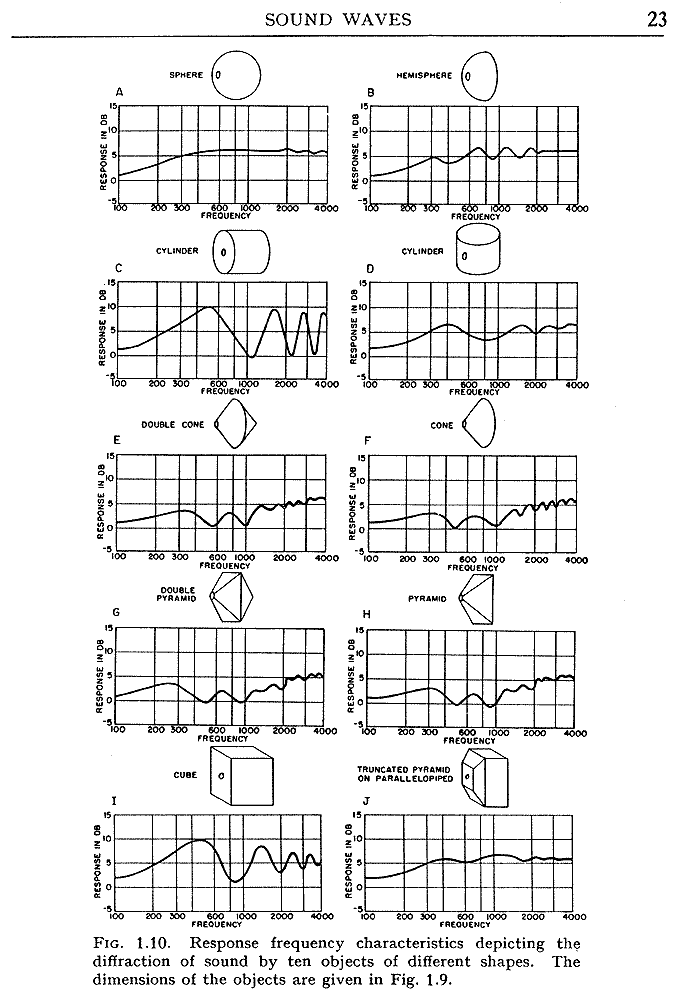

Well this forum is not bad, but this topic is maybe not ideal.
One of the problems with "diffraction" is that it can come in many forms. The most common is what happens when a wave encounters a "knife edge" - the classic optics problem. We know that the field that is created can be thought of as an incident field plus a diffractioon field which is approximated as a wave that originates at the knife edge. This is pretty close to being correct but still not exact. But the point of significance is that virtually all diffraction problems can be approximated as the original source plus a new source that eminates from the diffraction point. Its easy to see that when these two waves arrive at the listener they have traveled different paths of different lengths. This is where the problems come from. The ear apears to be quite sensitive to these different path lengths, i.e. arrival times. It appears that the ear masks very well in the frequency domain but not very well at all in the time domain. This makes the time delayed diffracted signal very audible despite its usually low level.
Any discontinuity in the boundaries of a horn will cause diffraction. And I mean any. Even a slowly changing boundary will diffract - obviously sharp ones do. Thus it seems pertinent to look for boundary shapes that diffract the least. This can be done and in fact the OS waveguide is just that boundary. No shape connnecting the same two aperatures can diffract less.
Optics deals with wavelengths that are almost always short compared to the objects (a lense is many many wavelengths in size), while acoustics will have wavelengths shorter, equal and longer - the whole gamut. Diffraction changes quite a bit with these different regions which makes it more complex in acoustics than it is in optics.
I studied optics in school to study diffraction. It was instructive, but as I said, the wavelngth domains where quite different.

A couple of questions:
1) I'm working on some ideas to create spherical speaker enclosures, so the effective radius of the front baffle would be, say, 10cm (0.1m). If my understanding is correct, this means it should reduce diffraction from:
(343m/s / 0.1m) / 8 = 428.75Hz
(or 1715Hz for where the effect is halved)
Would that be considered sufficient to have a major effect at eliminating the GD from diffractions? I take it that the diffraction based GD is considered more damaging to sound quality than that which it's usually masking (i.e. the end result would be a positive step)?

Yes, a spherical enclosure will have the lowest possible diffraction of any enclosure shape, but it is a little tough to make and not really required. A cabinet with generously radiused edges seems to do the trick, but I mean big radi on the edge, like 5 cm radi.
