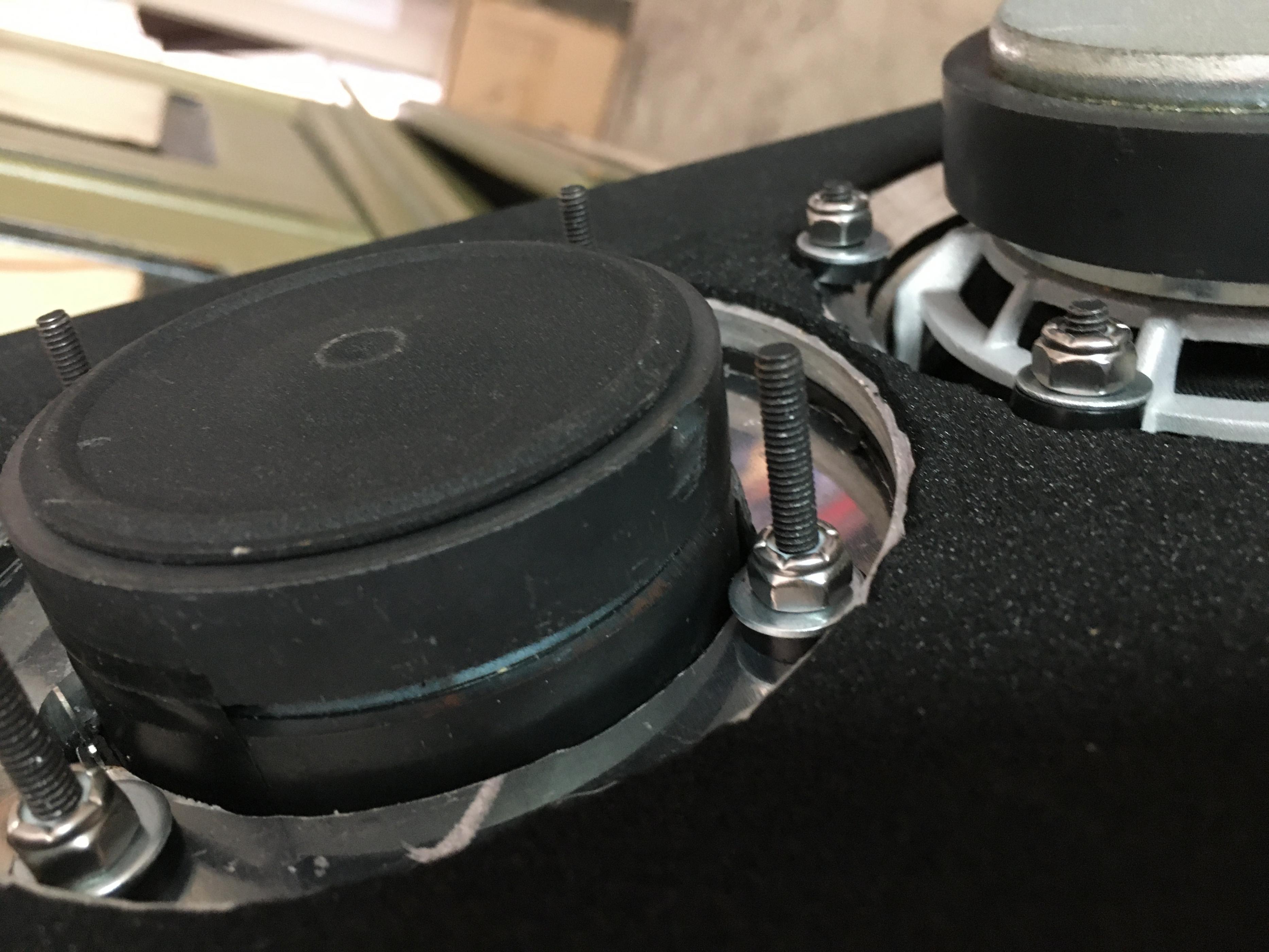

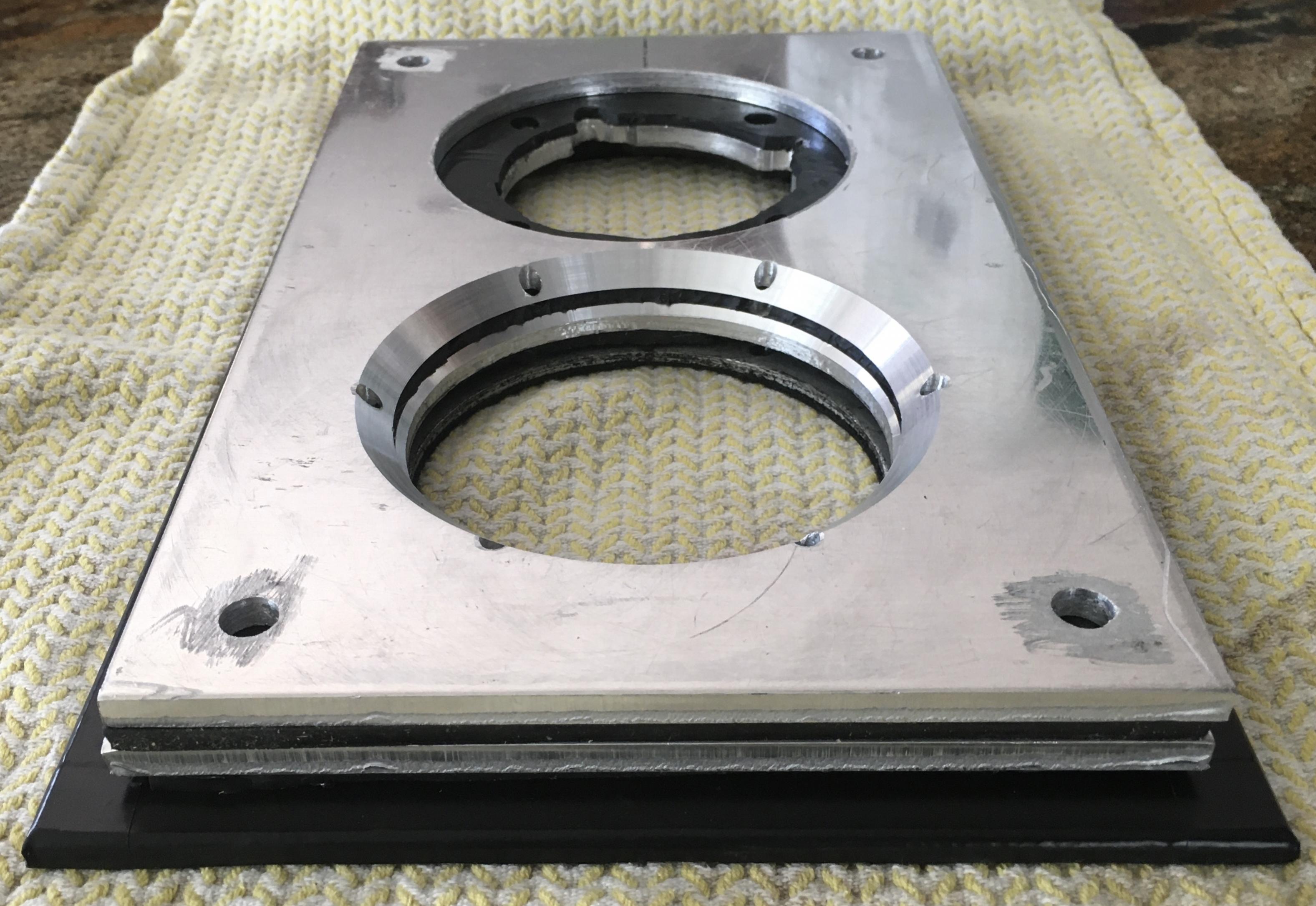

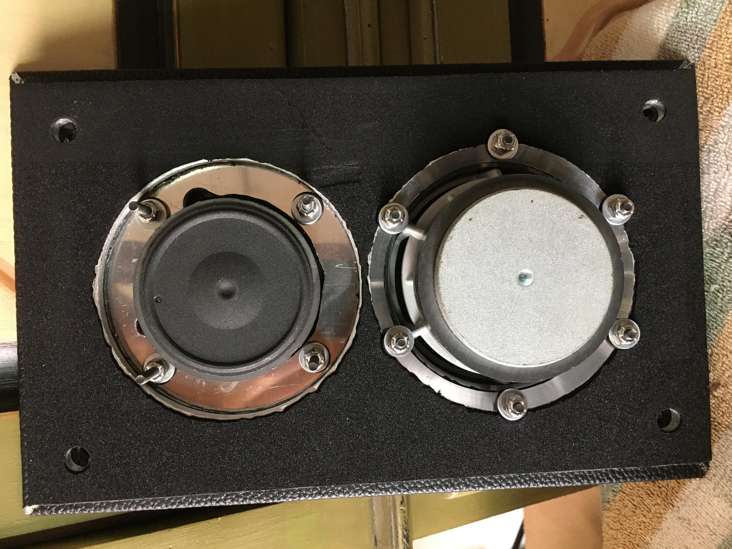

Everything is decoupled from everything, “rubber grommets” included. The baffle by itself also weighs 9lbs, compared to the original 1" mdf baffle that weighs 1.5lbs by itself.
Not only SL came with driver decoupling, KEF did too. Even their CS kit drivers like the B110B were provided with a thick gasket and soft rubber washers. This all was about 35-40 years ago. And IIRC the 104.2 has been mentioned here before. Anyone noticed the effort put in driver decoupling in those designs?
