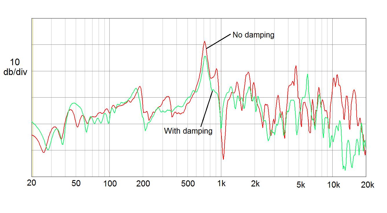

To support the previous post, here are two measurements that I took by putting the accellerometer at the same point of the top panel of a test loudspeaker box.
One is without any damping and the second is with some damping on this panel.
With such an equipment, it is very easy to compare different damping technics and decide what is the best.

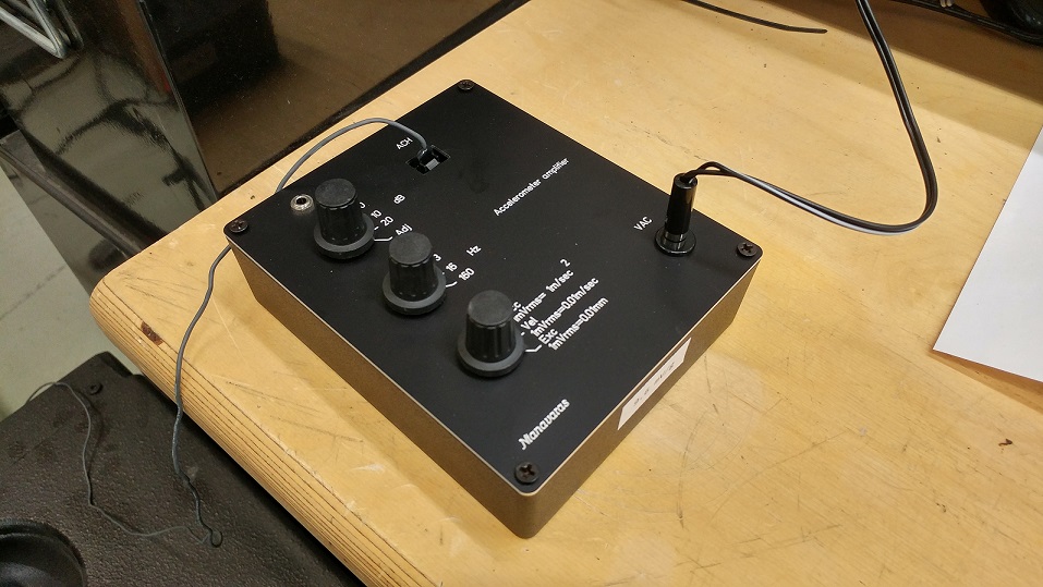

I have available a new assembled unit of the accelerometer amplifier in the new more compact aluminum box. The unit can be calibrated according to the sensitivity of the ACH accelerometer.

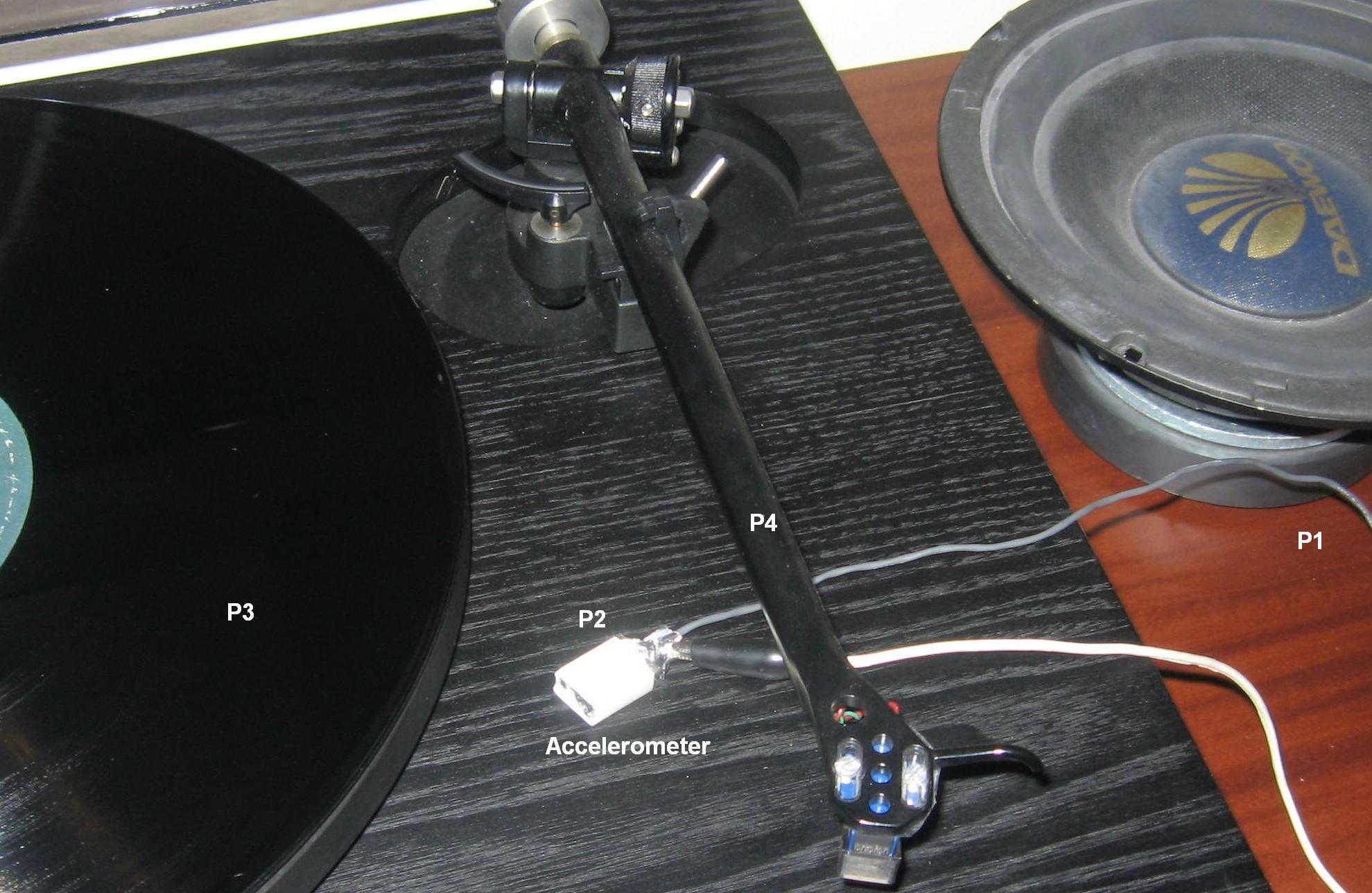

Measurements of the vibrations of a turntable
A very interesting application of the accelerometer, in cooperation with an audio measurement and analysis PC software like ARTA, is the investigation of the vibration behavior of the parts of a turntable.
The first photo shows a very simple setup I made for this investigation.
An 8” woofer was used to vibrate the shelf on which the turntable was positioned.
The ACH accelerometer was shielded with an aluminum foil to suppress any external EMI interference of 50 Hz mains voltage, because the level of the output signal of the preamplifier was very low level.

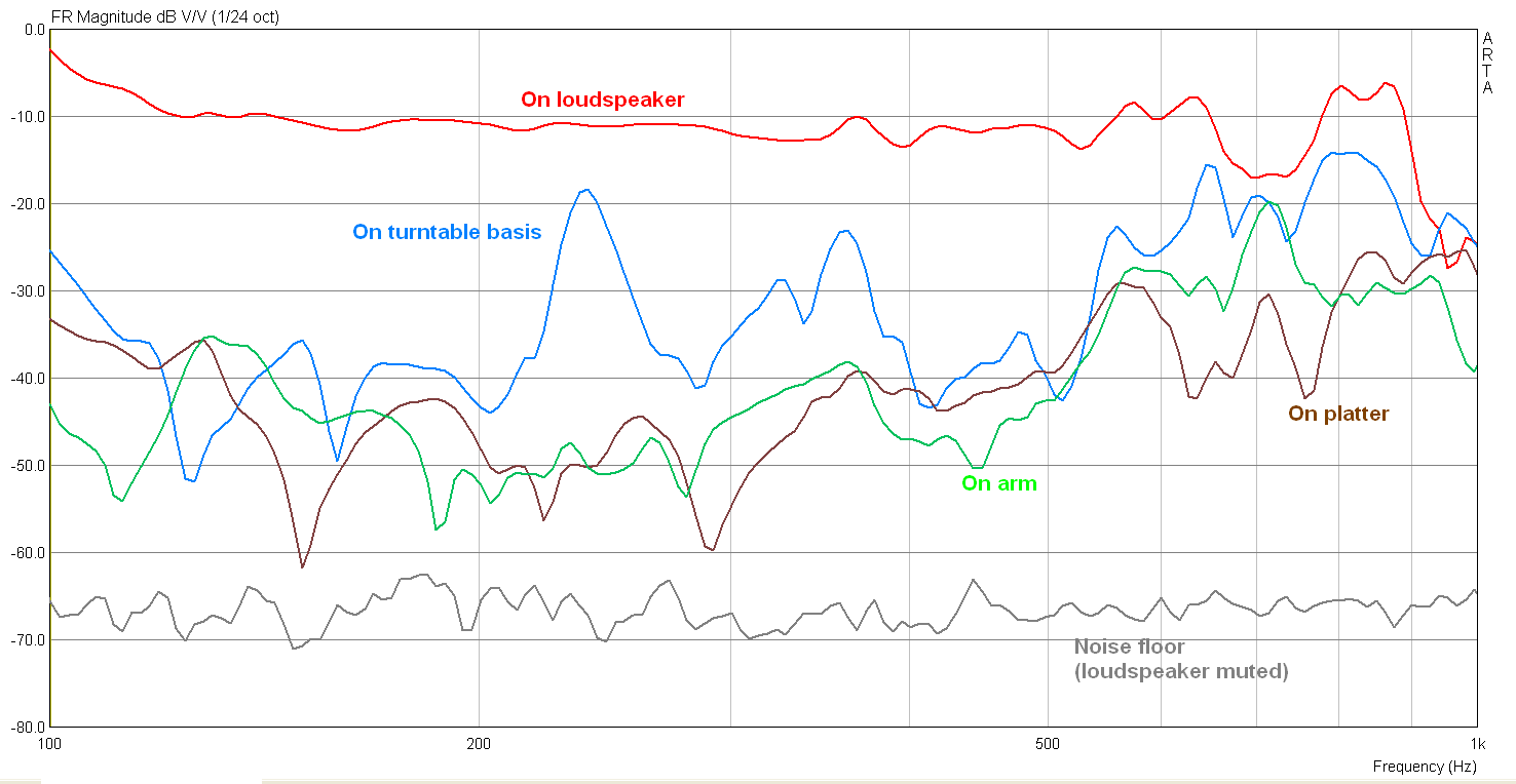

The second photo shows five measurements.
The first measurement was taken with the accelerometer in position P1, very close to the 8" woofer. As we can see the excitation of the shelf is almost uniform between 100 to 900 Hz.
The second measurement was taken with the accelerometer in position P2, on the basis of the turntable.
The third measurement was taken with the accelerometer in position P3, on the platter of the turntable, where an LP was also placed.
The fourth measurement was taken with the accelerometer in position P4 on the top of the Rega RB300 arm of the turntable.
The bottom measurement shows the noise floor of the setup (with the woofer muted).
With such a tool and with the above measurements, it is very easy to find solutions that will improve the behavior of every turntable in vibrations.
If you want to built this tool, you will find some usefull information here:
http://www.diyaudio.com/forums/swap...front-panel-accelerometer-preamplifier-2.html

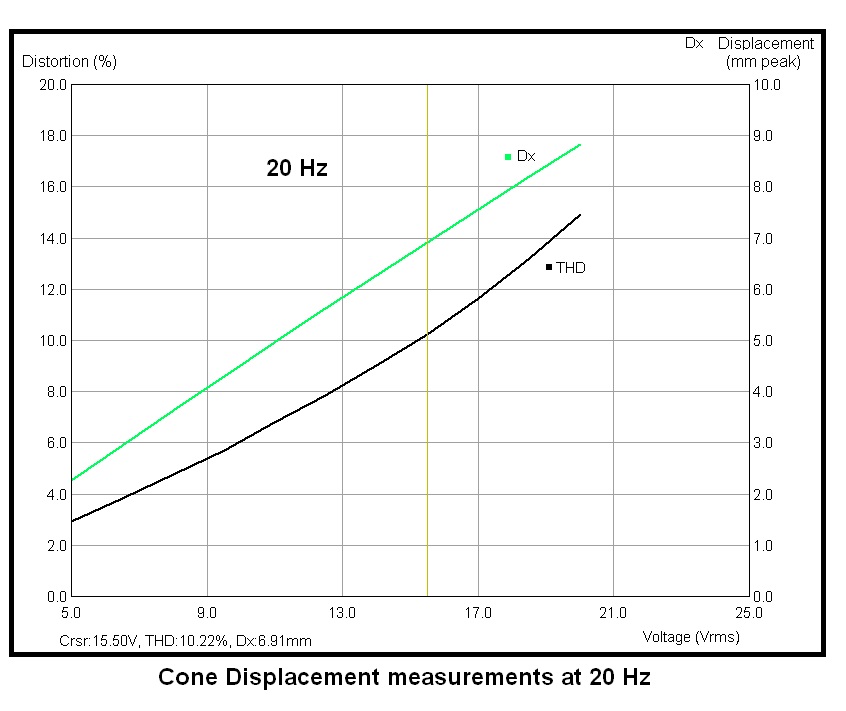

I have used the ACH accelerometer with its pre-amplifier to measure the distortion of a woofer and its peak displacement in relation to the input voltage.
I used the STEPS part of the ARTA software (STEPS Main Menu --> Record ---> Distortion vs. amplitude) with the output of my accelerometer amplifier (set to "Exc" to measure displacement) connected as an input to the software.
The accelerometer is attached to the center of the woofer's cone and the microphone very close to the cone.
In the attached photo you can see such a measurement of a 12" subwoofer placed in a box of about 30 litters.

Interesting graph.In the attached photo you can see such a measurement of a 12" subwoofer placed in a box of about 30 litters.
If you consider that the woofer is driven at 20 Hz by 15.5 Vrms (almost 44 V peak to peak) and the excursion is 14 mm peak to peak, I would say that a distortion of 10% is not so high.
