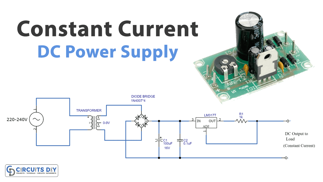

And the discussion on current and voltage drive always drags up a host of incorrect electrical terms.
'Current drive' is simply a circuit that produces a constant value of current regardless of source voltage or load resistance/impedance.
hardly a very advanced circuit in it's basic principle.
