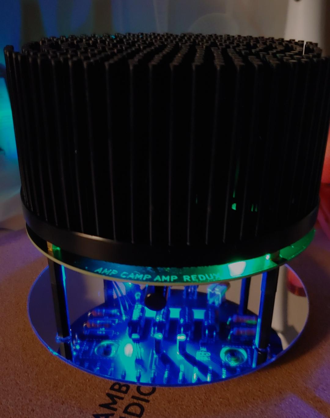

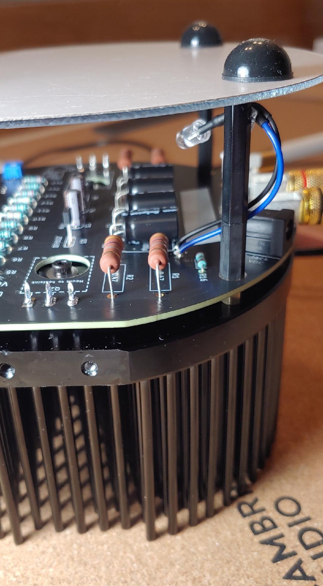

One could put a tiny dab of a paint like substance or flour and water, or oil, or pancake syrup, whatever, on the longer standoffs and lower them onto the mirror, centered. Remove and use the marks to drill holes. Then run short 3mm bolts through the mirror holes into the standoffs.
Found these feet. No guarantees but probably if you attach them with a 3mm bolt through the mirror they probably wouldn’t protrude outside the mirror diameter. Rather pricey as they are US made…

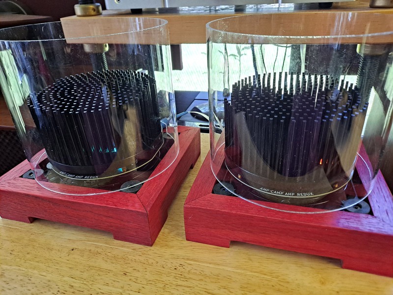

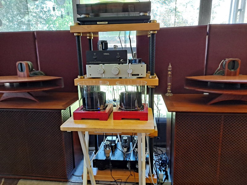

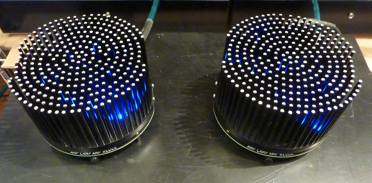

My completed pair - I decided to polish off the coated ends of the hedgehog spikes. All blue LEDs. The only mods were putting a 1uf 25V PIO cap in C3 and 47uf in C4.
