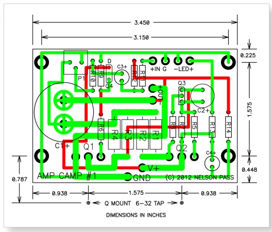

I have just began to study the Article for ACA Amp.

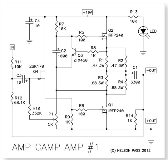

I found that in PCB layout, the trim pot P1 is direct connected to the Output Cap. (+) instead of to R3,R4 & C2 ?
Thanks a lot !
