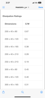

Thanks for the info the heatsinks on this case are 200mm X 160mm and about 40mm thick including fins. Searched for a good way to calculate the needed size but all I could find was the ACA amp is about 32W of heat to loose and heatsink measurments that weren't of any use? Is there a good way to calculate the heat dissipation? Cheers Rob

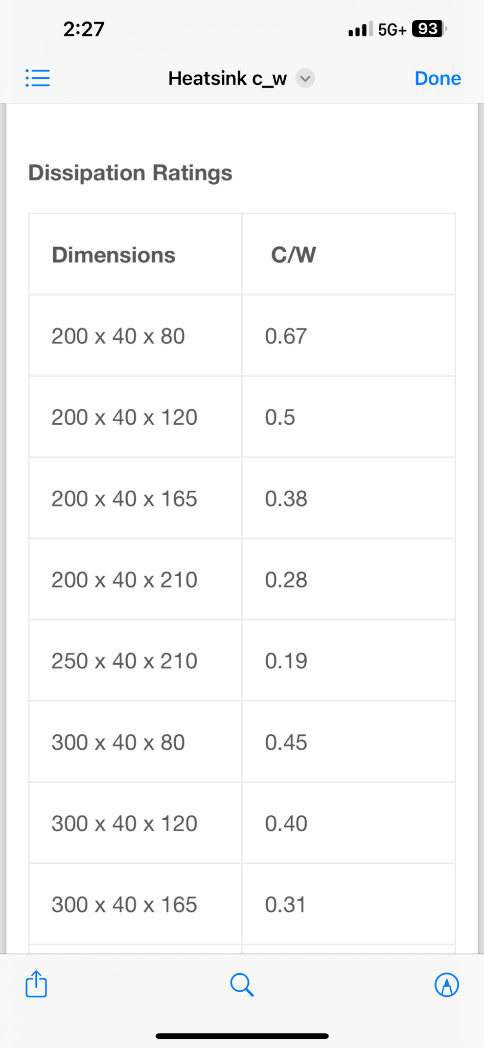

According to the DIYaudio store, a heatsink of 200 x 40 x 165 will have a coefficient of 0.38 C/W.
The ACA Tungsten works on 24V @ 1.6A bias therefore produces about 39W of heat at idle per channel.
Now, 39W x 0.38C/W gives a temperature rise of about 15C. For an ambient temperature of 25C, heatsink temp will be at about 40C.
Above approximation is not bridged settings.

Thanks for that was trying to find some details for the dissipation. So having two boards on one heat sink would rise by 30° so 55° at 25°. Might look at a small fan possibly just to keep it cooler. Thanks for the help. Will order boards and components then look at a power supply as well this being first build taking my time to make sure it's right.
^ I would not put 80W over 4 devices on that sink. Those numbers posted above don't account for de-rating. They're calculated based on the thermal saturation of the heatsink => HOT!!!!
For 64W to 80W per side... I'd go with something a little closer to what would be used for a First Watt amplifier.
The 4U/300 is commonly called the "Jack of All Chassis"... I'd start with heatsinks around that size and work from there.

40W dissipation would work great for that 0.38C/W heatsink but not 80W. I’m not even sure if a 4U/300mm would be ok to dissipate 80W, these heatsinks are rated at 0.31 C/W…it depends on people, I prefer my heatsinks below 50C at idle.
@Robstr556 - Any time... BTW, hang onto that data that @e_fortier posted. It's super useful. You'll find a comfortable % that you like to "de-rate" them based on the temps you want to run.
I like my sinks (to start with the lowest dissipation I'll run) to target ~20C rise over ambient. Then I can go to town if I want to spice things up. I've found that de-rating the numbers above by ~1/2 gets me nicely in the ballpark. As the temps rise, it's not quite linear, but if they start off cool enough... then I'm good. I also want to acknowledge that not everyone has the space or wants to spend the money to have extra 'heat headroom', but if I de-rate by 1/3 (ish) then I'm typically running pretty warm. I matched my data with the study Gianluca published, and it's actually not too far off.
