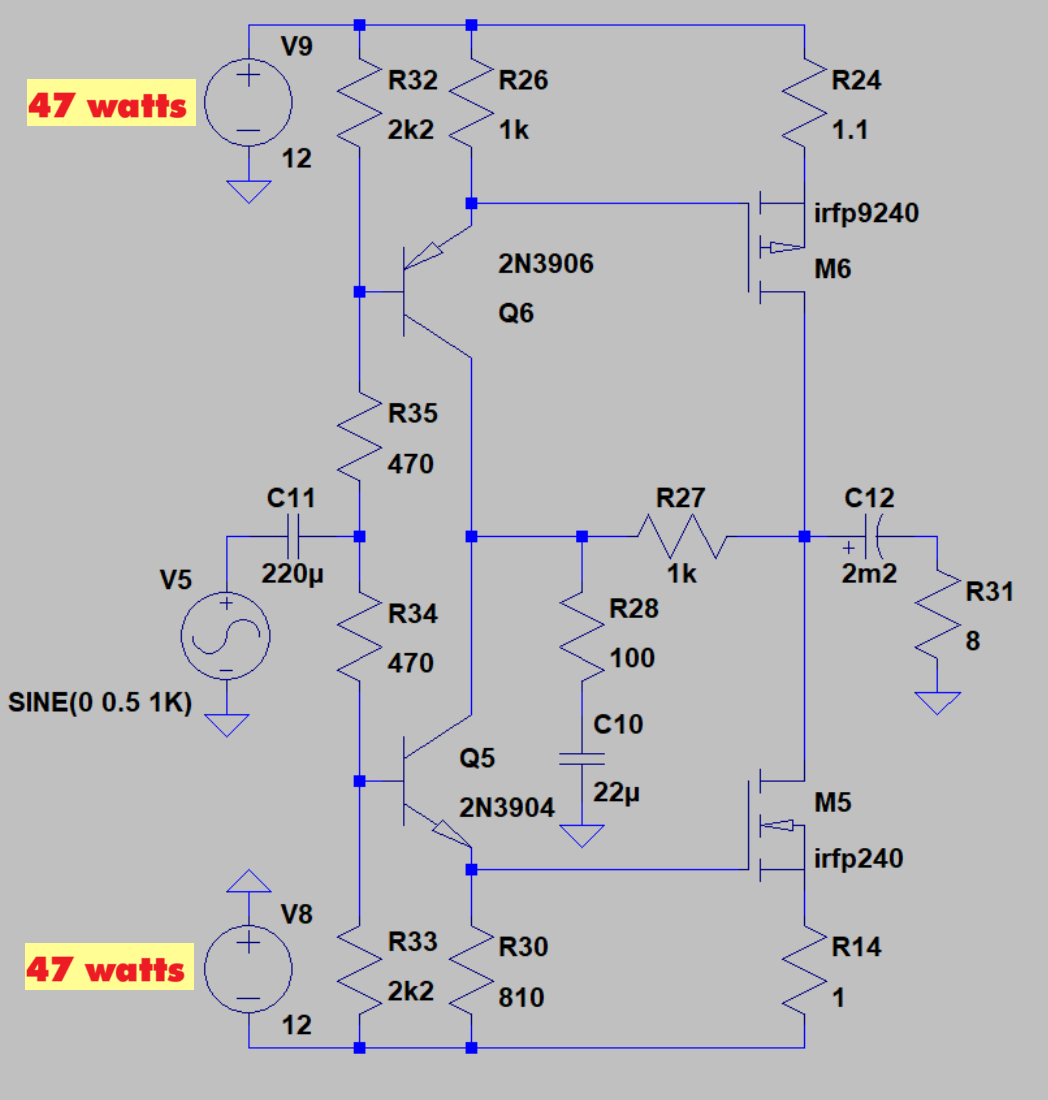

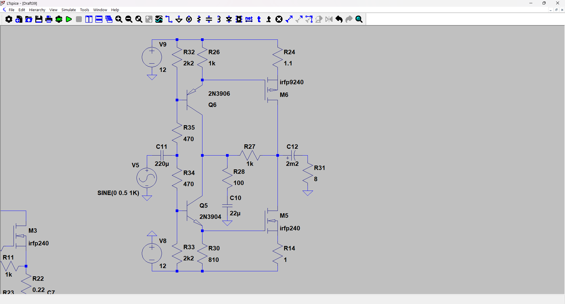

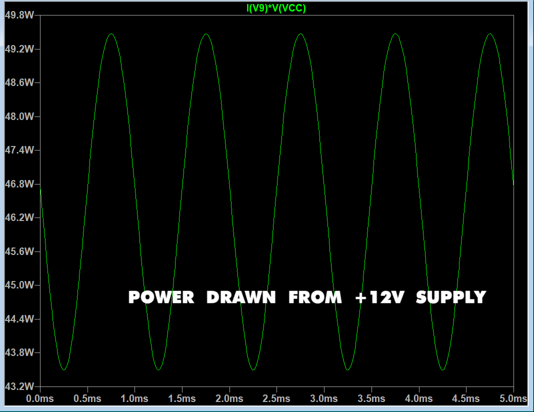

Schematic from post # 3,113 draws a surprising amount of power from the puny +/- 12 volt supply rails. It can drive an 8 ohm speaker to ~ 9 watts and remain in Class A the whole time.
Play with the numbers: 47 watts from the +12 supply, and another 47 watts from the -12 supply, gives you 9 watts into the speaker. Surprising!

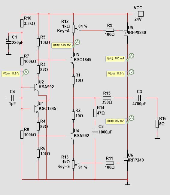

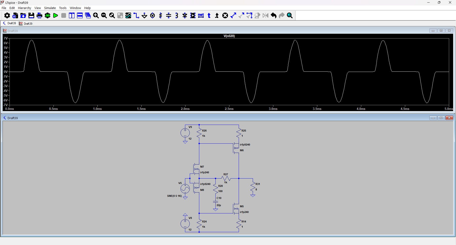

Hi im trying to built an ACA mini but without the input jfets becuse of an severe case of: "Expensive International Shipping" i cant get them locally, i also believe its a good project and learning exercise.
Im currently on this "promising" schematic:
That seems to just need biasing.
Have a fun time and good luck on your project!

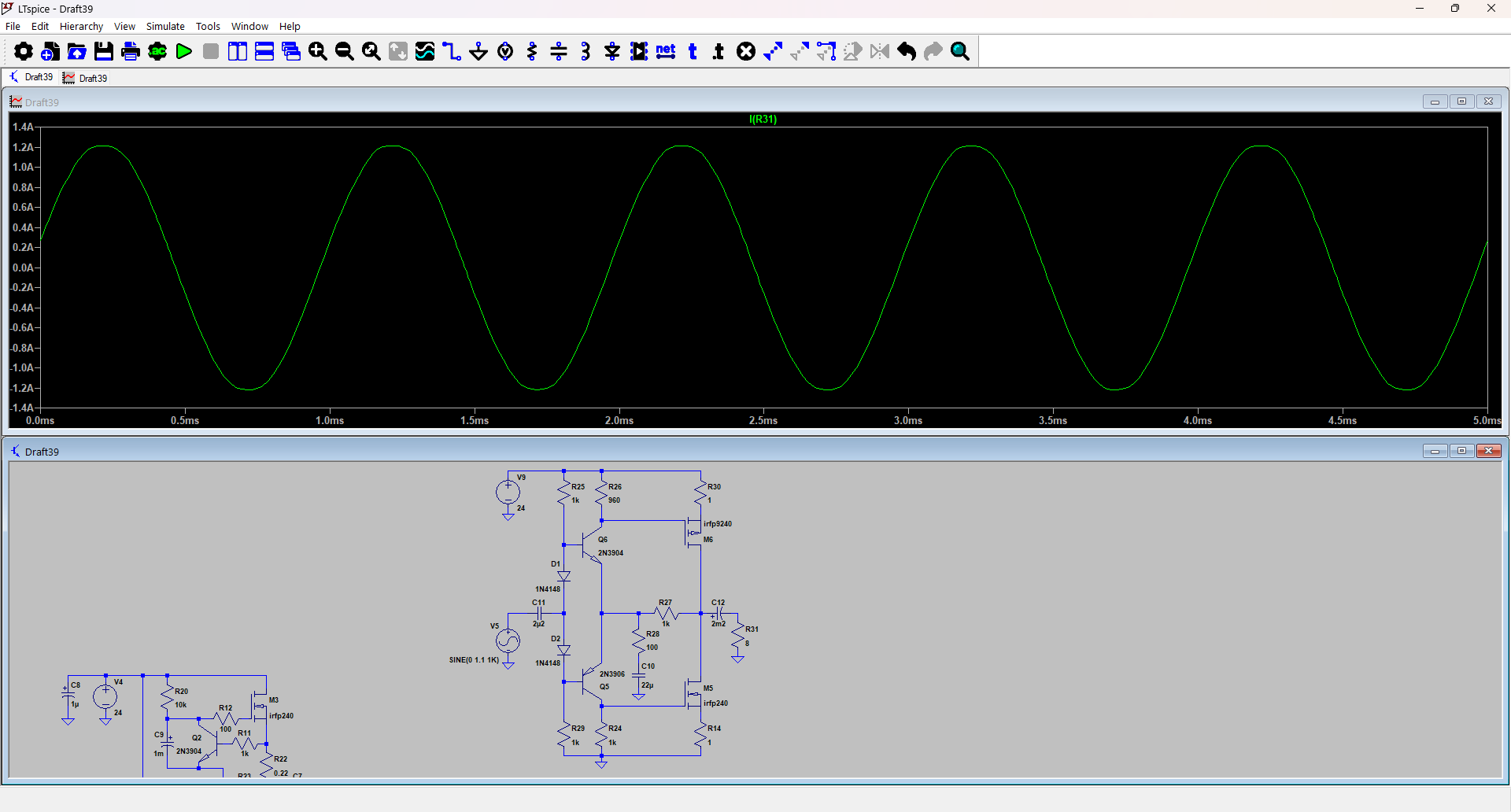

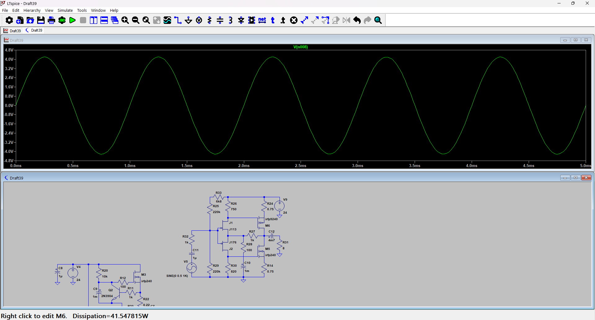

ok i found an j176/j113 jfet pair for cheap locally and after simulating the amplifier i get ~50w of power dissipation per transistor, is there any specific reason for the irf520/irf9520 pair or did i do something wrong?
R26 and R30 need to be variable with the FET gate taken from the wiper.

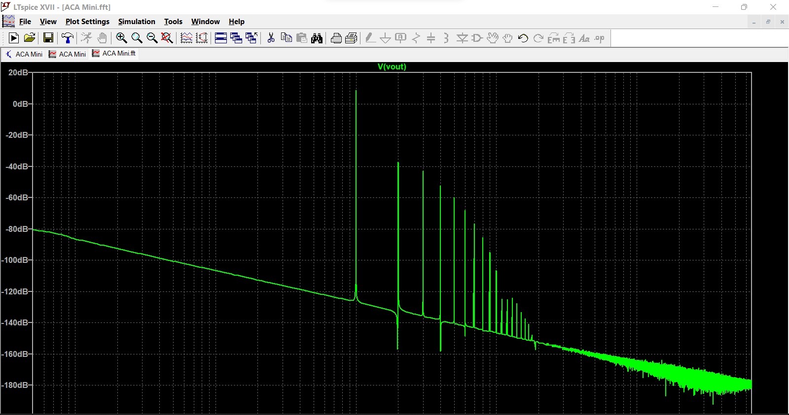

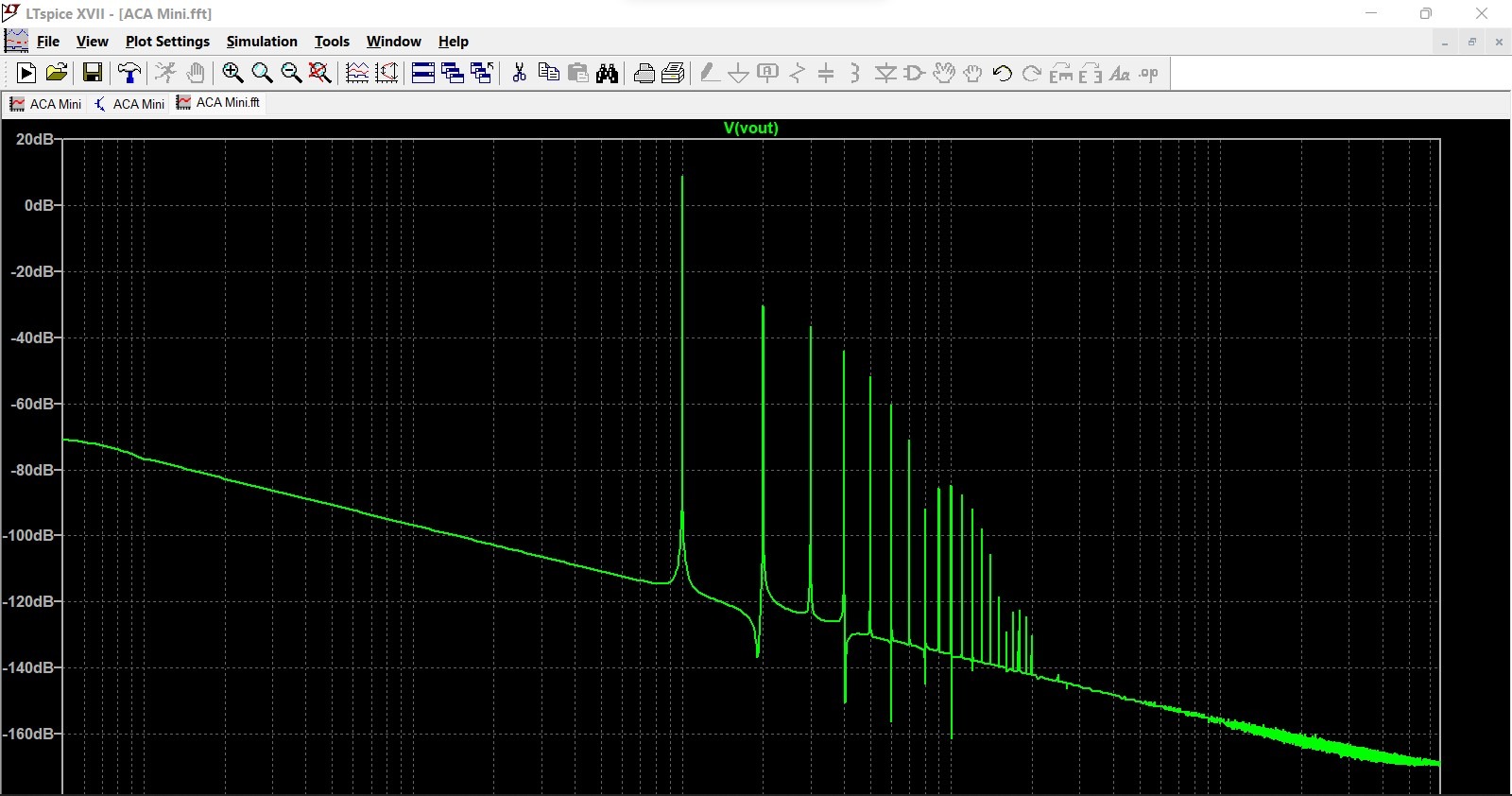

Here is a sim for anyone interested. It is not meant to be definitive and uses only standard LTspice models (so its click and run) but you can explore the operating conditions and so on.
The first FFT is with the bypass cap and series 1 ohm across the 0.75 ohm. The second FFT is with those removed. The standing current is set to 400ma. The FFT's were done with all caps set to '1' (one Farad). The load impedance is set at 6 ohm.

Oh thanks the wiper was connected in a weird way on the schematic.
How much does the exact transistor model matter? Will something like the irf540/9540 work just as well?
The exact model makes little difference if you bias it correctly. Remember the resistor values you set for biasing will be different from the values needed in a real build.
