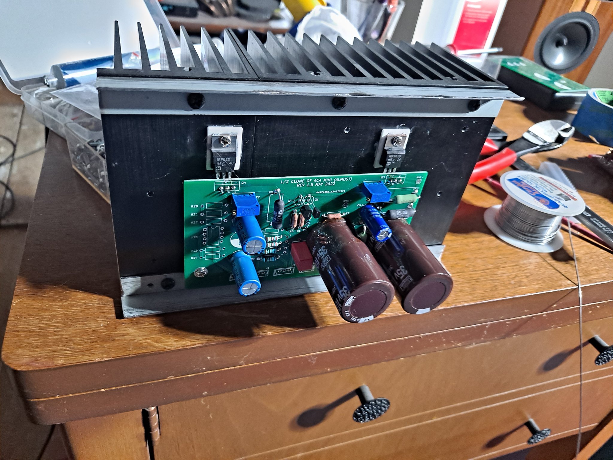

Audiosteve drew up a board where each channel was mounted on it's own board. That is the board that I used. It is the same circuit.

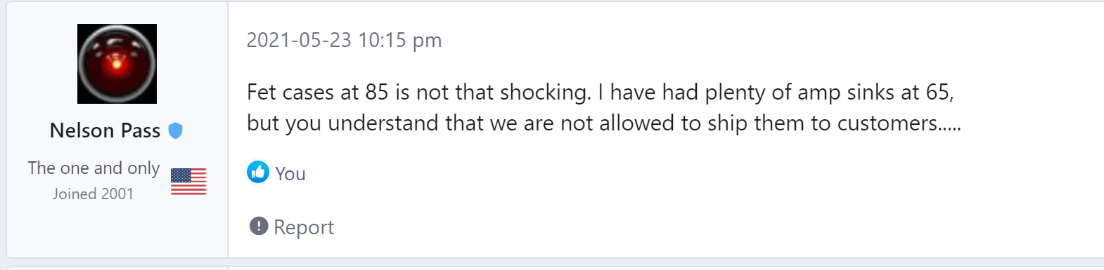

First, I find that the ACA Mini bias voltage is very dependent on ambient temperature. We had a couple of warm days when it got up to 78 degrees F in my house, and my bias was about 410 mV with Nelson's settings. I was concerned that this was too high, so I took it down a little bit.
This morning it is a more normal 68 degrees F in the house, and after an hour of warm-up (it really takes that long), the bias was at 280 mV. I am bringing it back up to 370 mV, which means it will run very hot if the house gets back up to 78 degrees F.
Nelson tells me that it's OK to run hot with a high bias, as long as no one gets burned by the heat sinks.
Incidentally, Nelson also said that the VO needn't be 11.5 V. You want it to be at least that high and under 12.0 V. Mine tested at 11.81 V with Nelson's settings. I think it's because my power supply puts out 12.35 V and maybe his puts out closer to 12.0 V. In any case, I am compromising on 11.66 V (10% over 11.5 V).

humm ,no jump ,sound good from start maybe better after 5min no more....use small cpu fan on hotter days no need to touch the bias ,
@Mikerodrig27 : Nelson said to me that the Zenductor runs even hotter, and no one has died yet. 🙂

Yep. I think the idea of keeping the temps low on these amplifiers is more of a safety thing versus it hurting the actual amplifer. The capacitors are the only obvious thing that may be compromised. But with the Zenductor and the ACA mini, the caps are all exposed to ambiant temps anyways.
I guess Nelson the scientist is using degrees Celsius in his comment. 🙂
