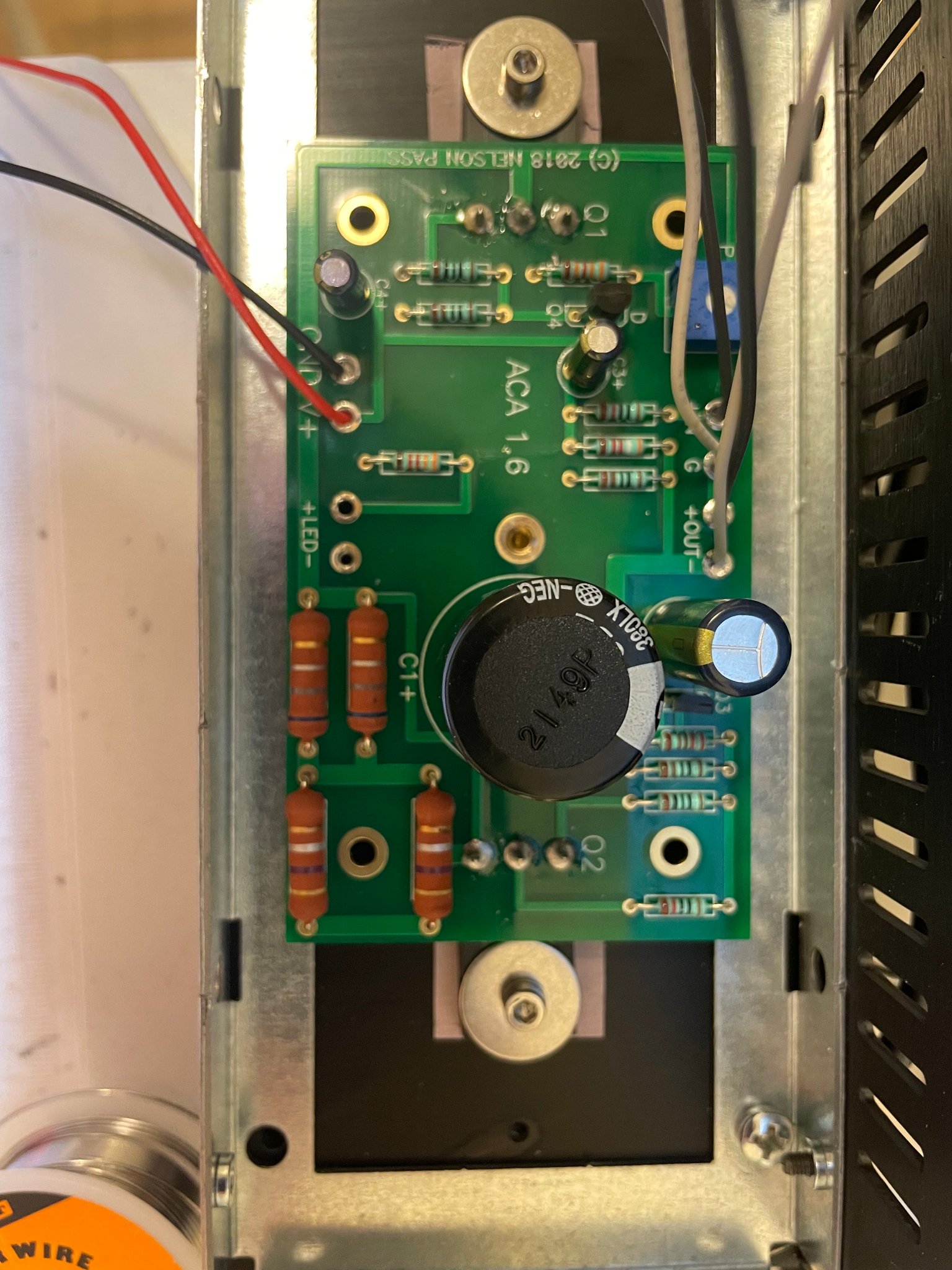

Please post some well lit and close-up pictures of your boards and wiring.

Thanks everyone for jumping on this! Somehow I've missed the voltage pic. Here it is:
Q1 -- S = 0.04 V, D = 12.08 V, G = 4.6 V
Q2 -- S = 12.9 V, D = 23.86 V, G = 17.5 V
Q3 -- C = 17.62 V, B = 12.7 V, E = 12.11 V
Q4 -- S = 4.63 V, D = 23.87 V, G = 4.42 V
Everything looks in spec...this is strange...

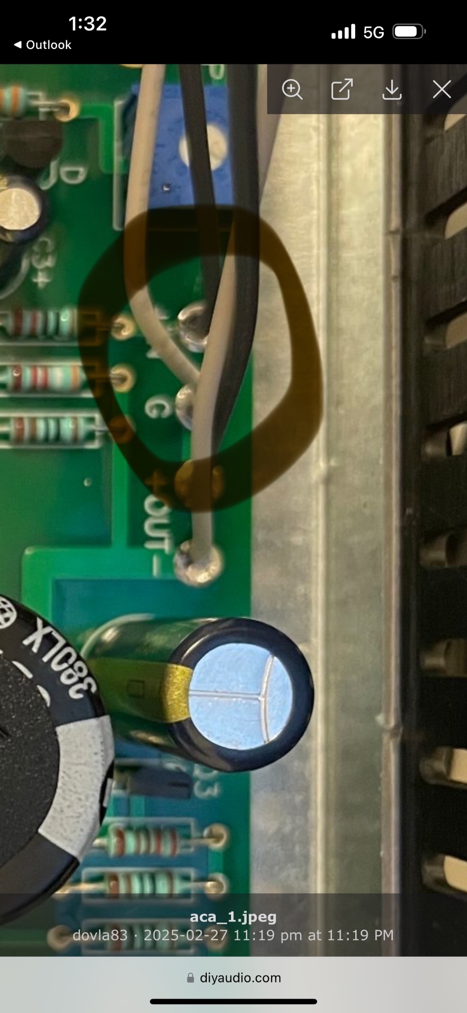

Picture attached. Curently only power input is connected. When testing, IN + and - goes to input signal cable + and -, OUT + goes to + lead on speaker and ground, - goes to negative lead on speaker.
Hope this helps!! Thanks!

Output positive (speaker positive) is actually ground. Output negative is not connected to ground. Inverting amp design
Correct. Positive output lead connects to positive speaker port and power input ground and negative output lead connects to negative speaker port.Just checking, the positive output lead also connects to the power input ground?
But the negative output is.

Your voltages and resistances look reasonable so I do not think there are any problems with the transistors.
Check your solder joints at C1 and R14. If uncertain, reflow them.
Also with no speaker connected, set you meter to DCV and connect it to speaker out, and turn on the power. Is there constant DC voltage, or does the DC voltage appear and quickly go to zero?
Joints test ok but I did reflow them. Speaker out shows climb to around 5 V and then drop to 0 within 10 seconds. Then it starts to climb again...
