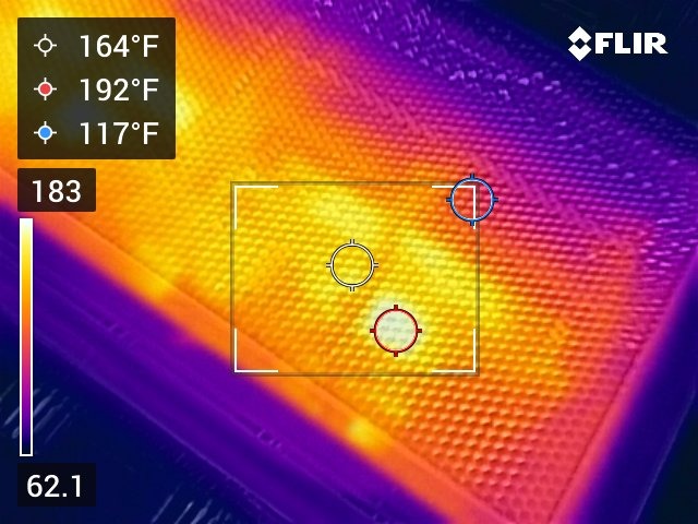

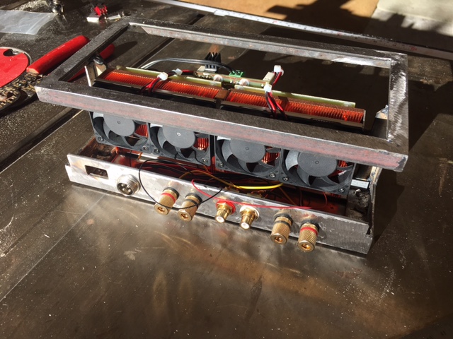

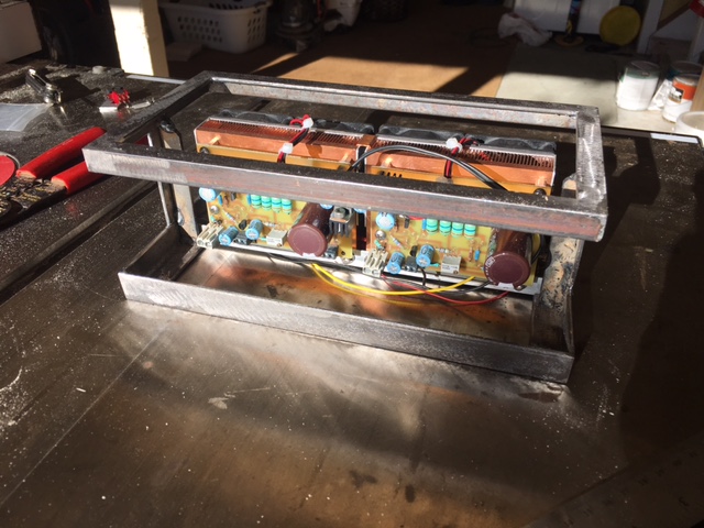

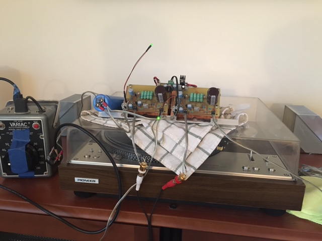

Got a chance to run the amp for a little longer today. Sounds very nice. Will try do do a comparison with the standard ACA at a later date. With the fans running at a very low speed, the heat sinks barely get warm. There's a bit of a hum with a source connected or with the inputs shorted; I'll try to fix that once I get it in its chassis and build a real power supply.

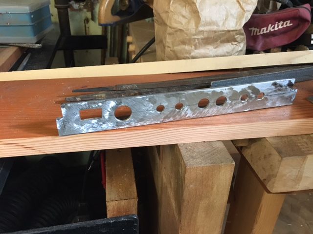

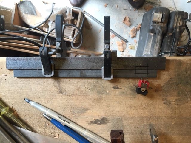

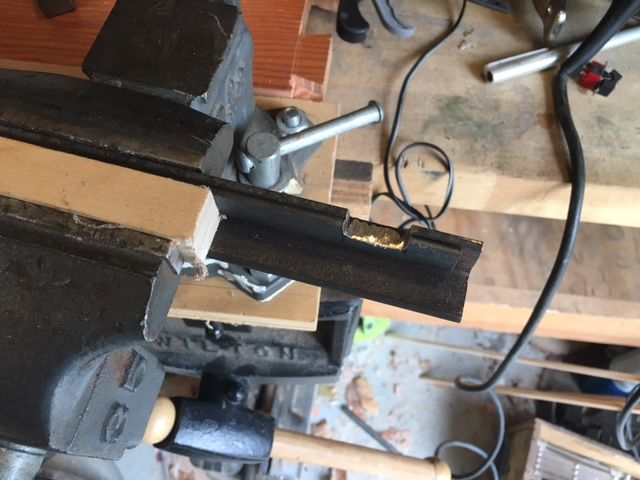

Steel! Hats off to you for making that work.
To answer the question of how to cut rectangular holes in steel? Drill, Dremel, file. Almost as much work as welding two pieces together and smoothing them flat. 🙂
In aluminum, if thin enough use a nibbler tool.

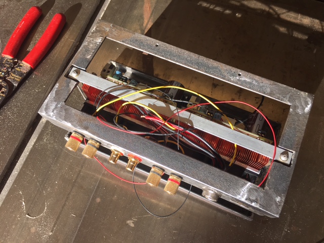

yes, drill, Dremel, file would have worked, but I had to increase the height of the rear rail anyway, so this was the more efficient solution. working with steel sounds daunting, but it's actually very forgiving, since you can work and rework it several times over until you get it right.

BTW you were right: a little fan cooling goes a long way. There's really no good place to take a reading with my IR thermometer because the output devices are under the PCBs, but pointing it at the exposed OPD mounting screws reads a maximum temp of about 98°F. None of the accessible surfaces get more than lukewarm to the touch. I'll bet I could build a stereo ACA on just one of these sinks & it still wouldn't break a sweat. Hmmm... ACA III? I do have an extra sink in my parts drawer. Would have to make it challenging again. SMD?

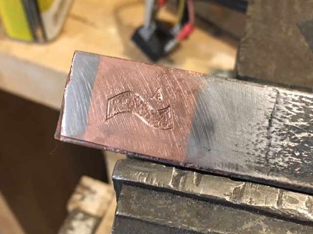

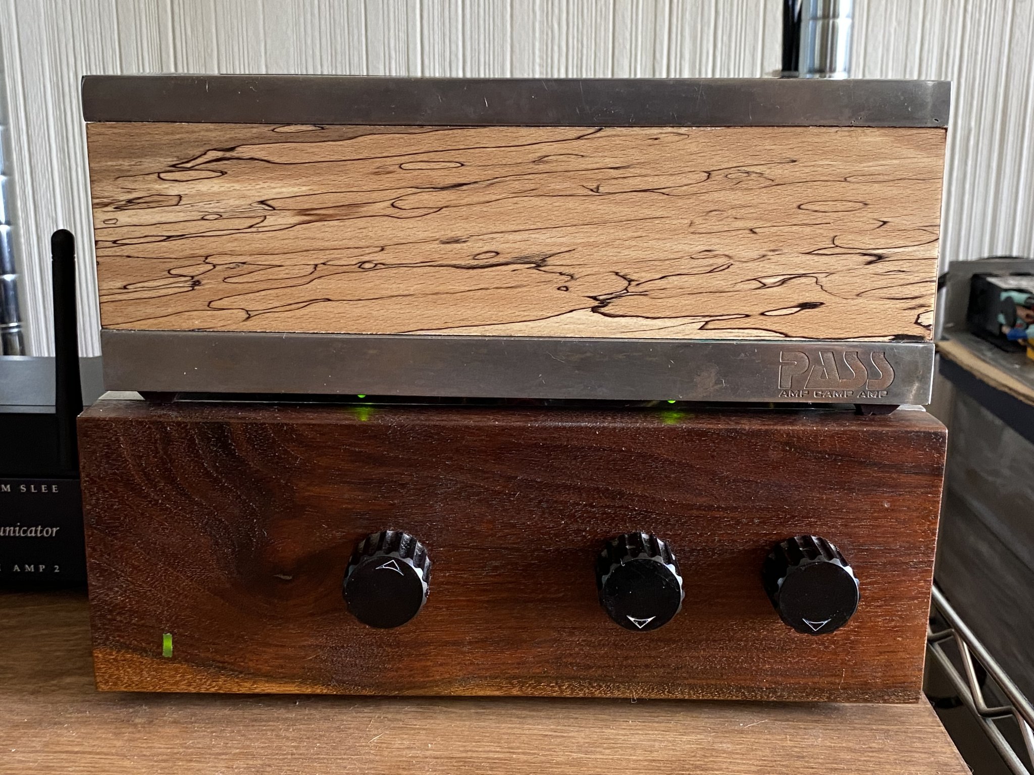

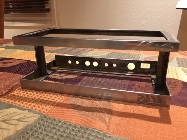

The problem with steel is it rusts. So if you (or your spouse) aren't into the industrial look and would rather not have a hunk of rusting steel in your living room, then you have to protect it somehow. Options are waxing/oiling, clear-coating, painting, powder coating, or plating.
My plan is to go with nickel plating. I've ordered some nickel from China and should receive it in a couple of weeks.
Another part of my plan is to etch the PASS logo and "Amp Camp Amp" on the lower front face of the frame. The etching will be done prior to nickel plating. After nickel plating, I'll copper plate just the etched logo/ACA lettering.
This morning I experimented with electro-etching and localized copper plating. I just used electrician's tape and an xacto to make a simple mask, then etched the design in a piece of scrap steel. After etching, I couldn't replicate the mask (but I will be able to when I do the finished product), so I just copper plated the logo and the surrounding steel. My main goal was finding a way to do localized plating without having to immerse the entire frame, or even a portion, in the plating solution. I'm happy to say I succeeded 😀
Result of my test below. When I get to etching and plating the frame, I'll detail how I did it...

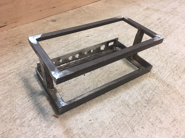

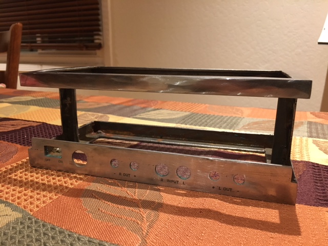

Progress... Yes! Welding & grinding of chassis finished, logo & back plate etchings done. Just need final sanding & it will be ready for plating. I have the wood pieces cut to rough dimensions (no pics of that until final reveal... it's special wood). Started work on the cap banks for the PSU. Going to pick up misc. parts for the PSU & also some perforated steel for the chassis tomorrow...

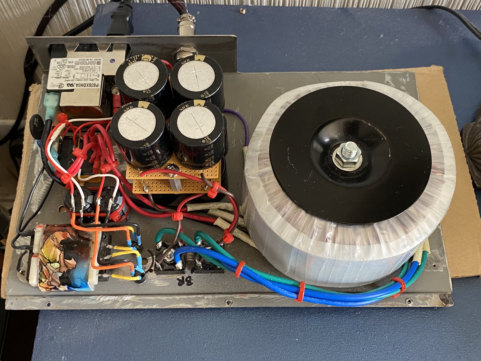

After [checks first post in thread] six and a half years(!) I have an update to this project! The past few years have been challenging, keeping me from continuing ACA Concept II. My son, who was the inspiration for me getting into DIY audio, passed away late in '19. A lot of challenges, both related and unrelated took my attention away from pursuing the hobby.

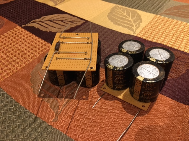

Well, I finally found time, inspiration, and parts to (nearly) bring this project to completion. The last part of the puzzle was the power supply. Simple in concept, but it proved to be more difficult to execute. It has the main PS for the amp, of course, but it also includes a smaller PS for the fans, and for the relays which switch on both the amp and the fans. The PS is connected to the amp via a 9-conductor umbilical, using 16mm 9-pin "aviation" connectors.
The original intention was to have the amp run on 32V, but the finished power supply actually puts out a tad over 26V. Oh well... it still sounds great to my ears. The fans are pretty quiet; they can't be heard at listening distance. The amp does run hot, but I think the heat sinks + fans are doing their job well.
Currently running with input from a B1 built by my son, which I gave to my brother (I'm temporarily crashing at his pad). No complaints about the B1, but I think a preamp with gain would provide a little more oomph. Thinking of trying the H2 V2...
Thanks as always to NP for his boundless generosity, and to Zen Mod for inspiring this -um- mod. I think you owe me a "ly!", ZM 😊
Cheers!
