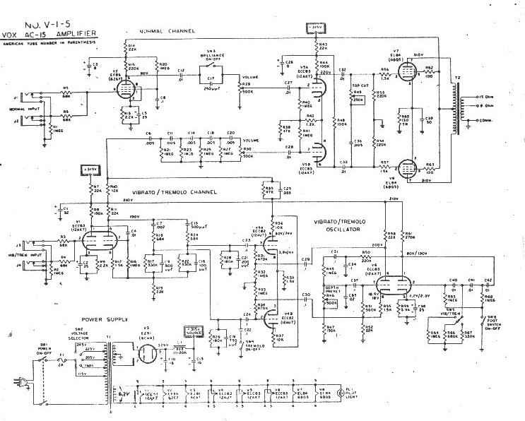

Hey all. I wanted to share my latest project with everyone, a Vox AC15. I basically gutted a Custom Classic and reused the cab, chassis and transformers. The most challenging part was the layout. The chassis was already cramped before I decided to add 3 extra tubes and a huge cathode resistor and cap.
Pretty much all of the circuit components are Weber parts as you can see in the pictures.
These are the changes I made compared to the Heritage being sold now:
1.) Used a separate heater supply transformer since I wasn't sure about the capacity of the custom classic one.
2.) Used a copper cap instead of EZ81.
3.) Only wired the high gain inputs since that is all I ever use anyway.
4.) Left out the power tube triode switch so that it is always in pentode mode.
5.) Tweaked the power tube screen and cathode resistors to lower the plate dissipation.
I was originally playing the amp with the Wharfdale speaker and once I put in the Celestion Blue, it really did sound like a new amp. I wasn't sure whether to believe all the people online raving about this speaker, but now I'm one of them...To my ears, it definitely is the perfect compliment to the sound of this amp.

Post the schematic, is it the new AC15? That one is not the good one. Wrong choices in coupling caps and other things.
stalker, the title of the post is the schematic. Not too hard to find online. Post some links of your clone sound clips and pics if you have them. I would be interested in hearing them. What kind of coupling caps did you use?
Why should I? Mine sounds better.😀
Post the schematic and I'll tell you what I think of it. Can't post clips, in a couple of months I may record some awesome sounds but I can't now. No hurry though, plenty of time for you to make mods. Cap coupling value in the new AC15 is too high for the ef86 stage...and the screen resistor too high also.
