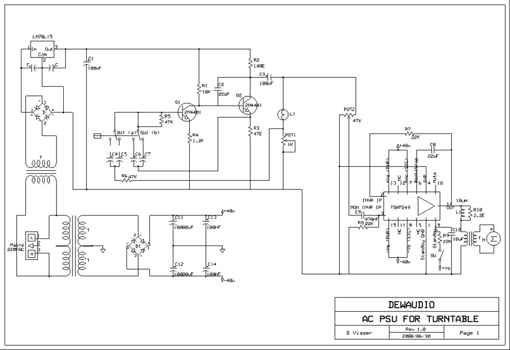

I have searched the forum for similar discussions of a valid design but all has been a bit hazy.
Basic unit specs:
Two vari frequencies (for 33.3 and 45 rpm)
Stable operation
High current capability without strain
Output voltage adjustable
One-box solution (no odd pieces of amps and iPods
This is what I have come up with. I am no electro guru but this is my best guess for a PSU to fit the above requirments.
Wien-bridge oscillator with two fixed cap banks as per each speed for selection. Fed by a regulated PSU.
TDA7249 IC Op-Amp as driver stage for motor/transformer - at least 5 amps capability.
A super advanced PSU with processor control is not really nessesary (display etc). You want a stable supply to the motor (especially frequency).
Anybidy care to expand on this and comment/make suggestions on the schematic. Like I said - I am no expert but this is my best guess.
Dewald

If you are looking to run a single phase (induction) motor, don't use a class AB power op amp as the power amplifier. You will have a devil of a time compensating it due to the effect of the motor inductance on the feedback loop. T amps and their ilk are a far easier solution.
If you are looking to run a two phase (synchronous) motor splitting the two phases and establishing quadrature correctly is very important to optimal performance.
I once used Wien bridge and then some more complex analogue oscillators (modified Fraser multiple phase shift) but the drift is difficult to control. Yes square waves are difficult to filter but Direct Digital Synthesis gets around that very neatly.
Is the "one box solution" allowed to have multiple components inside?
PS (or battery) > frequency generator > output amplifier(s) > transformer(s)
There are good reasons for keeping the sections separate.

I did not realize that the amp in the schematic is class A/B - the data sheet doesnt mention it.
What is needed is a class B amp for best efficiency.
Also looking at doing this oscillator solution than the above unit: http://www.maxim-ic.com/appnotes.cfm/an_pk/3846
A dual phase unit is not needed as the phase shift for AC Synch motors is done by a cap (but you knew that).
I want a PSU with a single phase that will enable me to use it on a varety of AC motor turntables. Converting these tables to DC motor is not an option. The PSU must also have Low Voltage (12 - 24vac) and High Voltage (110v - 220v) output, selectable by a toggle switch. (Look at the puny "Speedboxes" from Pro-Ject)
Last night I tried my 12vdc-to-230vac inverter on my turntable and the results were quite impressive! This is what I want - no need for an over-fancy device.
A single box solution is also a must - clutter is not an option. Mains operated also a must.
I think the inclution of an analogue voltage and frequency meter on the front could be a good idea. Maybe a ammeter as well.
Dewald
PS - Any tips for a high power class B amp in Chip form?

I repeat: Do not use a class AB (or class B) power op amp for an induction motor, the inductance causes huge problems. Class D gives you better efficiency than Class B anyway.
I didn't say that a two phase supply was necessary, I said it was important to optimal performance. It is of course up to you what compromises in performance you will accept.

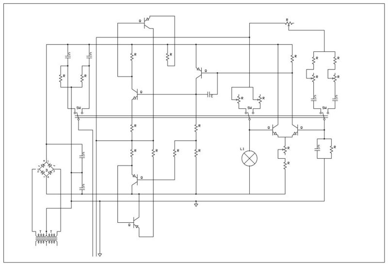

Lets study a very important PSU (IMHO) of a great turntable. The PSU of a Thorens TD125 mkI.
I used this table for an exstended time and is impressed by its speed stability and easy of adjustment.
We can distill the essence from this circuit and build on that to create a good PSU. Dont you think so?
First of all - we only need one phase.
Second - more power (better amp section)

GlidingDutchman said:Dont you think so?
No. The TD125 is indeed quite nice and may become awesome with a good PS. Or a good DC motor. Or a good AC motor
There is very little to provide inspiration in the circuit. And it only provides low votage/power at output.
It is considerably easier to go ground up, rather than adapt.
Especially if you are looking for precision.
There are 3 distinct challenges.
1/ Precise generation of a 50 (60, or switchable) sine wave with no / low harmonics
2/ applying 'gain' to the sine wave with as little distortion as possible to take it to the 110/220/240 Vrms required
3/ Stepping up the current capability to provide 100 or so watts of power.
1 is a challenge thanks to the precision required - you are in the realms of the capacitance of a switch possibly adversely impacting the output
2 is more straightforward, except that the gain will be of the order of 50+
3 take high voltage, low current to high voltage, high current...
I'd suggest tubes for 3, a good transformer for 2, and a *nice* oscillator (or dedicated sine generator chip) for 1.
This is not inexpensive, and not without difficulty, but the results will be worth it. Most specifically, elimination of the ULF oscillations on the mains power circuits (sub 1 Hz, that are like subtly varying DC)
An alternative route is
1/ a great oscillator
2/ a great amp - to provide gain and current
3/ a huge transformer to step up to the correct voltage.
This is challenging, because many amps are not happy driving inductively coupled loads, and low loads![bigeyes :bigeyes: :bigeyes:](https://files.diyaudio.com/forums/images/smilies/bigeyes.gif)
