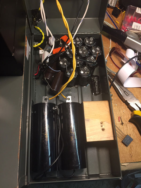

I am using the Hammond 167R6 which is rated at 6.3V at 8 amps, so I have the capacity to go either way. The black box on the top right on the amp will contain the components required to go DC on the heaters. There is plenty of room in there to add more capacitance (there is 3X 4700uF installed at the moment) as well as rectifiers resistors, etc. I have used two large 120v to 30v transformers with secondaries attached for the source of 120 volt AC. The power supply is CLCLC (117.5uF/1.5H/235uF/1.5H/235uF) to the power tube, then the rail is split to the right and left channel of the pre tubes with two sets of RCRC (2.2K/76uF/2.4K/2uF). The last C is a film cap, and all the rest of the C are made up a small portion of the bucket of 200 volt 470uF electrolytic capacitors I bought last summer, bypassed by small film caps. Thanks for the feedback idea, I'll try it out if I find there is too much gain. I will be using it with a pair of AKG K240 Sextetts, which are 600 Ohm, so the output capacitors are a pair of 100uF Obbligato film caps. I am also using one of the six Daven 2X100K stepped attenuators I picked up earlier this year as a volume control. Here are a few photos. It's a bit of a monster....

I think I'll try it with DC first, and up the capacitance as you did since I have the room to do so. I'm already set up for it as I was expecting to build the heater supply that is found in Mapletree Audio Design's OD300. This has a 6.3 volt transformer, a bridge rectifier, a 10000uF cap, one 47K resistor to ground off the negative and one off the positive after the capacitor, and then on to the tube heaters. I have heard this amp, and it is excellent.

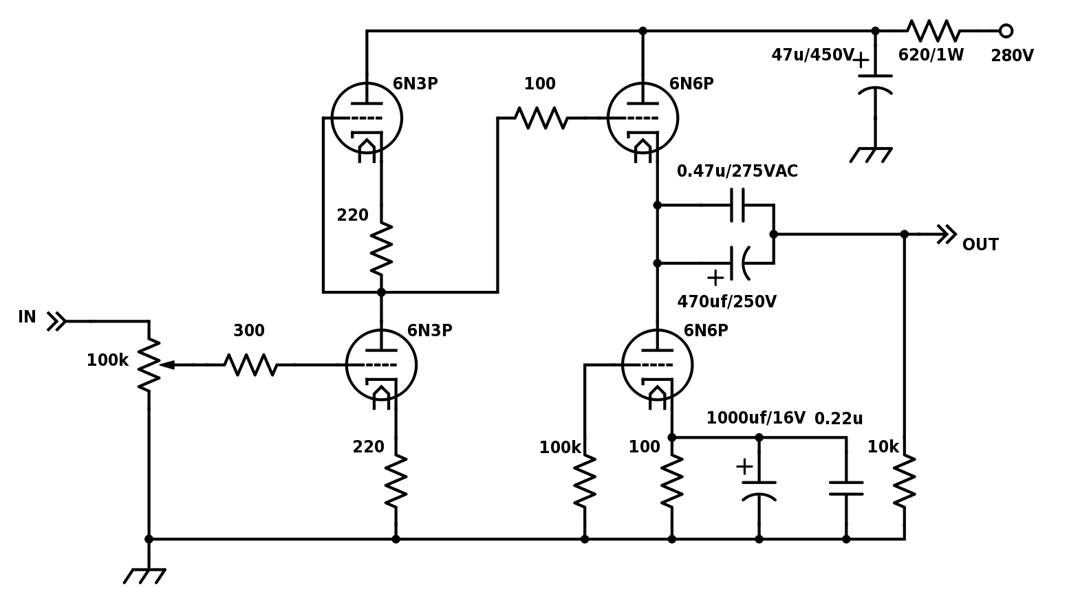

only the bottom 6n3p is affecting the tube sound.
Ideal follower has low Z out, and high gm, which triodes have some problems with that. (mosfet is better)
linear triode is great at voltage amplification, why to use it for anything else?
let the mosfet do the hard power work

Because this is easier, cheaper, and works better.
I can build this circuit in a chassis with power supplies for less than 100 CAD. No bloody heatsinks either. It will drive 32 ohm headphones and it will deliver almost 1 Watt into my 470 ohm cans.
Every time I see an IC in a tube amp circuit, I get all sweaty and nervous. I've built a few with SS CCS, and the most annoying part for me is the heatsinking as well. They do sound pretty good, so I forced myself through it. Not this time though. I finished it using DC on the heaters (74000uF). It is dead quiet. I have only used it with the output of an Iphone, and that way the gain is not excessive. It will be a little too much with my DAC and my CD, but okay with my receivers DAC, which has an output similar in level to the Iphone. I needed to drop the heater voltage a bit, and did so with resistors. I ended up with a B+ of around 200V on the plates of the 6AS7/6080/5998, and 72V on the 6DJ8/6922/6n1p. The first is higher than my targeted 155-165v, and the second at 72V seems low. The transformers each have two secondary taps, and I used the combination that gave me 150V unloaded. I can also get 120V and 100V by a simple rewiring. if I lower it to 120V, as per the schematic, it will lower the B+ going to the pre tube as well, so I will have to lower the resistors in series to get it back up. What should I shoot for in voltage and current for both the 6080 and 6922? I have many 6n1p-ev as well. What would be good operating point for that tube?
