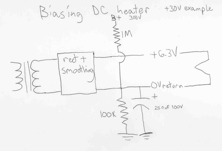

Tweeker said:Biasing oxide cathode (indirect heated) type DC fed heaters for less noise coupling.
Ah I see what you mean now, Tweeker. So 100K would give 30V? Why the capacitor?
For me, it's because of my 105 db horn tweeter. It lets you hear all sorts of things including unwanted. Keeping it quiet is possible but not an easy task.jarthel said:if DC is quieter than AC and you have a spare transformer winding (or separate transformer) and the necessary caps and diodes (and other parts as required), why use AC?
The cap keeps B+ ripple from appearing on the heater.
Actual voltage with 100k and 1M would be 1/11th of B+.
