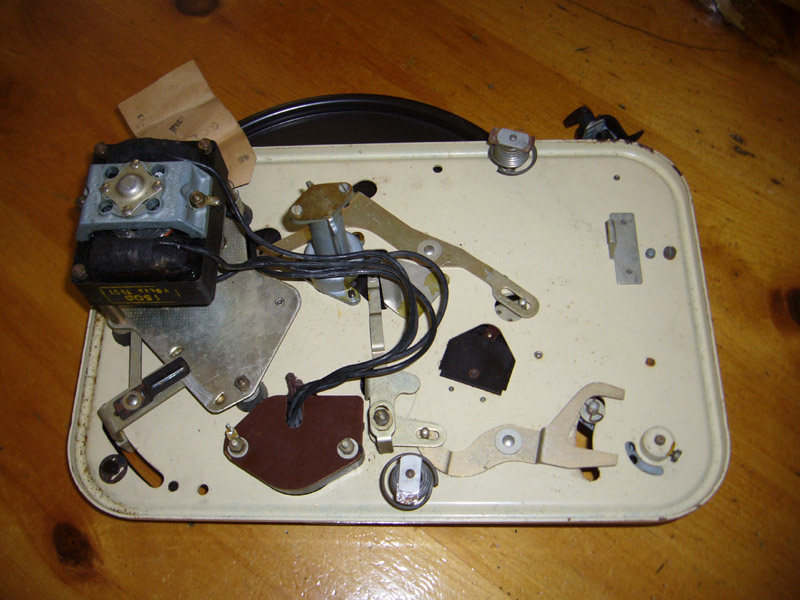

These are 50s garrard AC motors made for the USA market...one is a Model TA, and other a Model T MkII both manual.......The vibration thru the tonearm I would describe as a tremor........so this can't be good for the sound repro...........what size resistor ohms would you start with to check this theory??.........................thanks much

According to the attached photo, There are two ac windings on the TA motor.
It would make sense that each winding sees the added resistance. You will have to inspect the wiring to determine the most efficient way of doing this. 1kΩ may be a suitable starting point. Bear in mind that I have no direct experience of doing this, only what I have garnered from the link I provided.

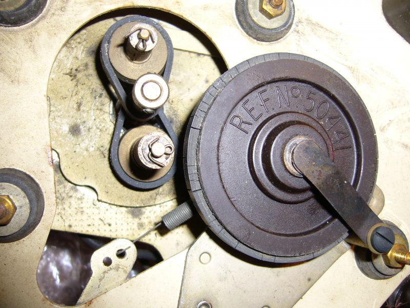

If the rubber of the idler or jockey wheel has become hard and brittle, it will transmit vibrations from the motor to the platter. Check this first.
