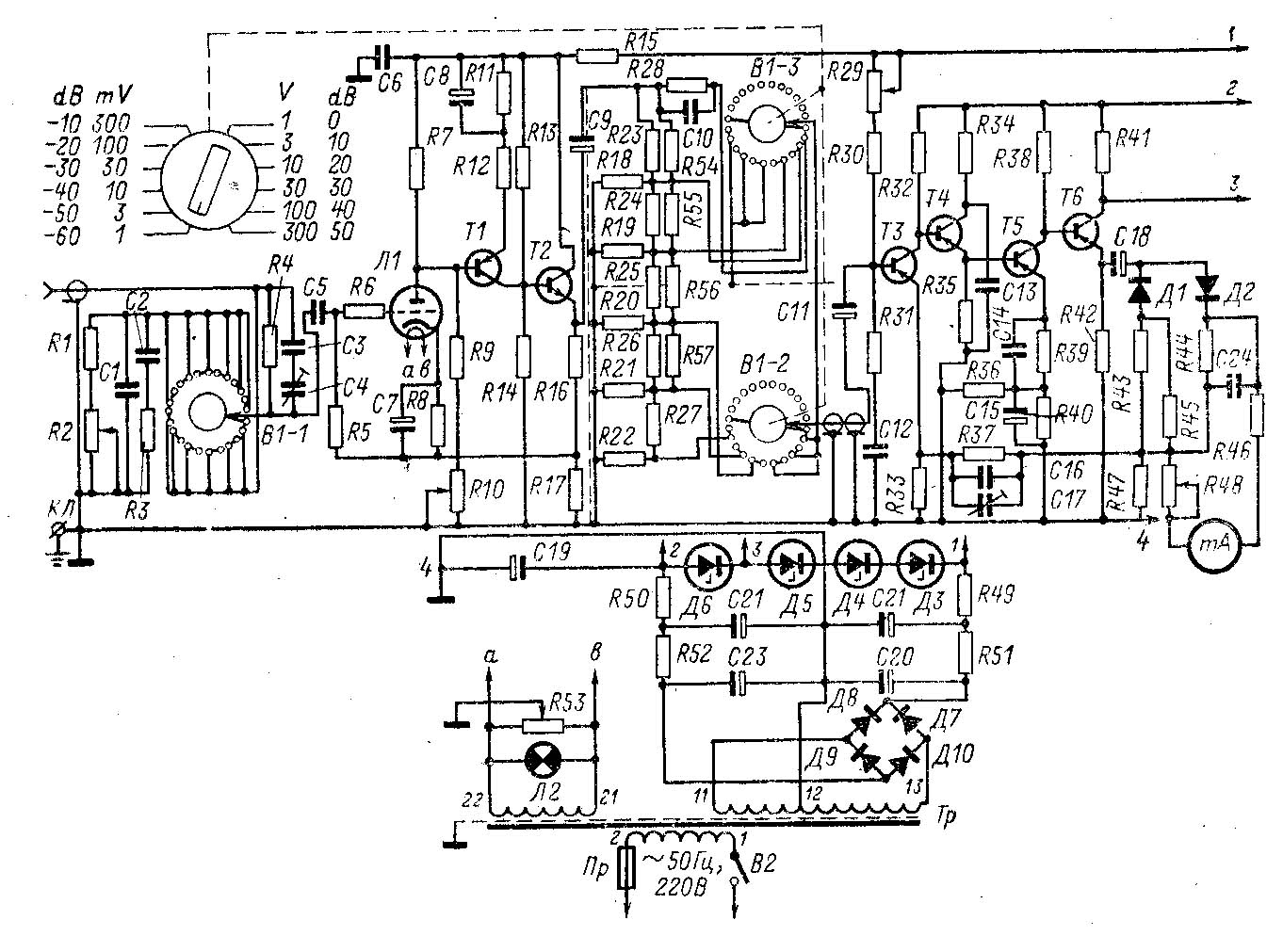

The most optimal is a combination of a vacuum tube at the inlet and a high-voltage OP amp in the amplifier-detector. Cascades are connected by a common feedback for linearity. The tube is more protected from measurement errors.
Scheme of the ancient millivoltmeter. Kill this voltmeter is almost impossible.
Operating range up to 5 MHz.

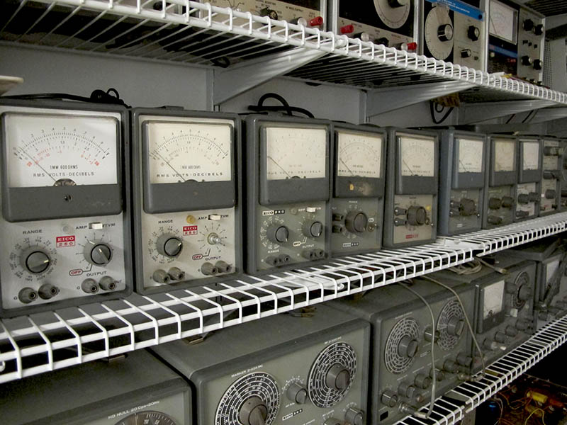

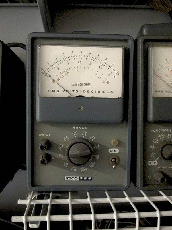

ESP is a good resource. I tend to stay away from battery operated equipment if possible. The 50uA movement limits this to fairly small meters. Also the high Z attenuator looks to be a big hurdle.
I have not seen these available. Do you have any links you could share?You can purchase a good 403 carcase with meter and switch system for $50 or so. This is a huge deal given the quality.

There's enough parts in there for 5 meters. Or a nuclear power plant ;-)
Jan
All transistors can be replaced with one high voltage operational amplifier. Then there will be two elements, a tube and an opaamp.There's enough parts in there for 5 meters. Or a nuclear power plant ;-)
Jan
And a greater tolerance of operator error
To kill the transistor at the entrance, you need only one error. That would kill the tube, you need a strong desire and the time.

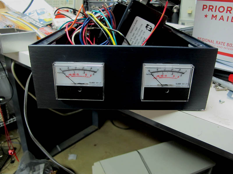

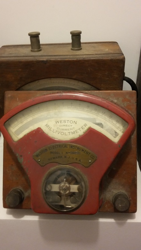

In my search for meters I find there are limited choices. One that is nearly ideal is made by a company that does not want to respond to inquiries. I wonder how they are still in business.
Another supplier can provide a movement with a 70mm pointer, no scale, no case. The downside is that the pointer is round.
Readily available 44C2 may be the one to go with, not great as it has a pointer that is about 47mm but it is available at a reasonable price.
